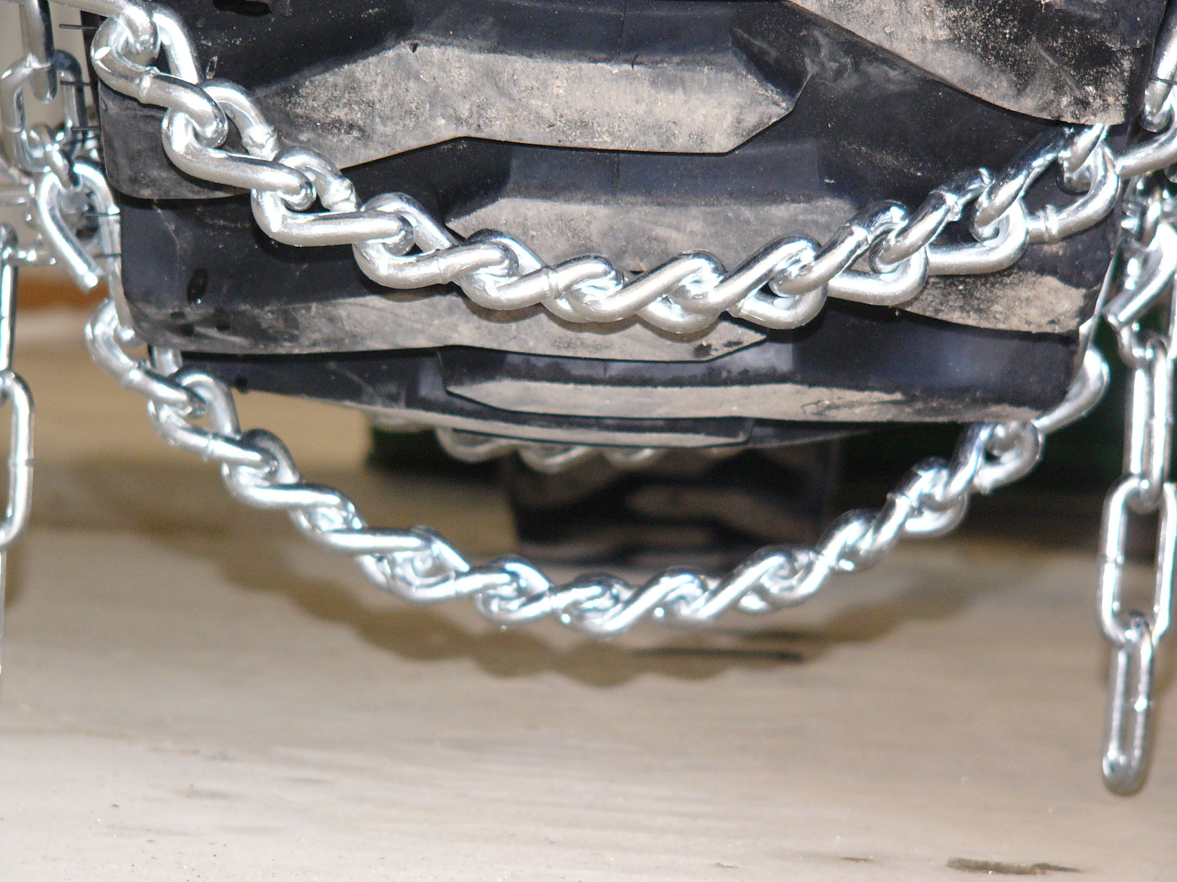

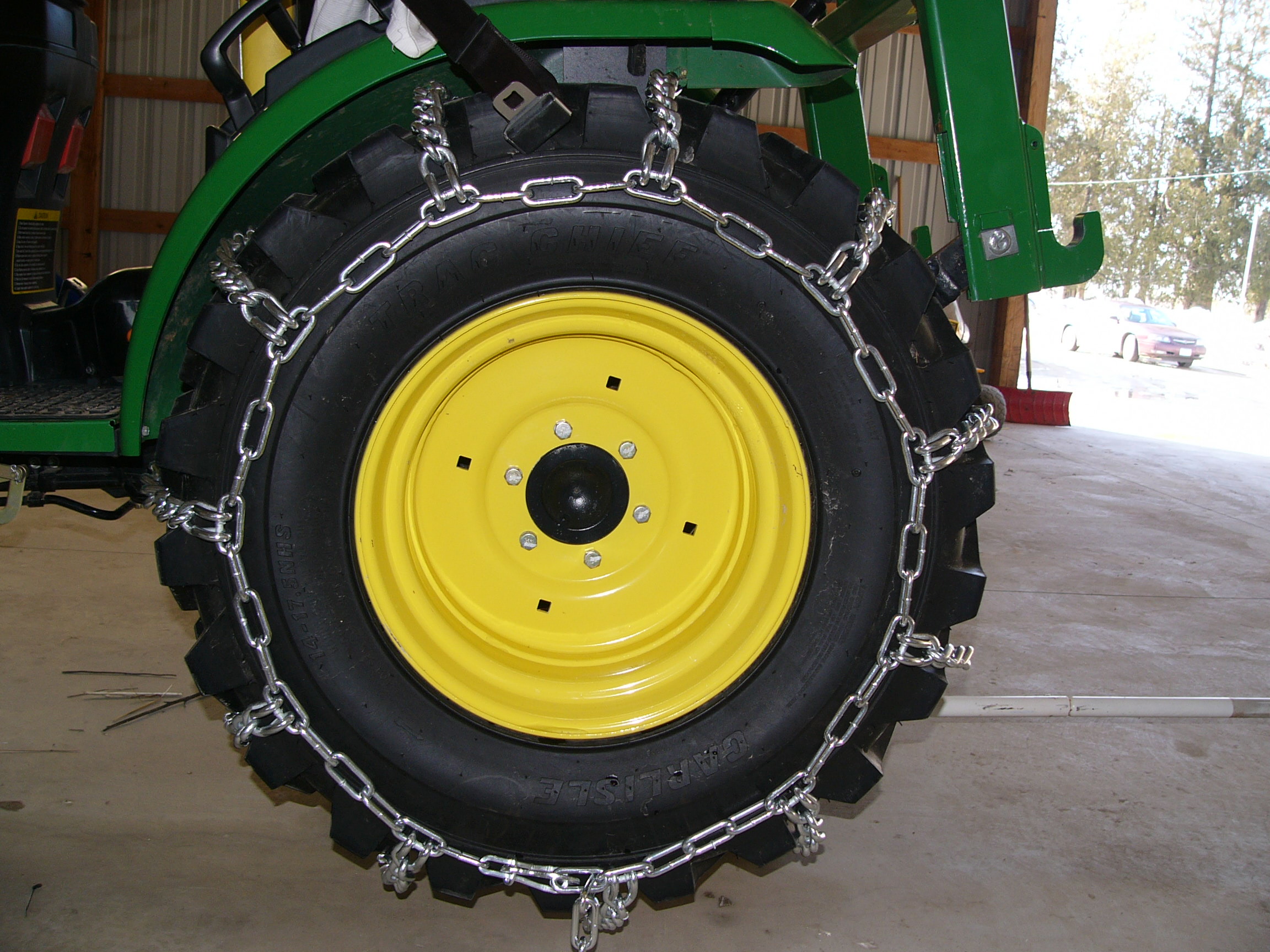

I will repeat what you have probably already thought about yourself. The R4s are a compromise for your situation and are probably the best choice. But, this depends on how wet the dirt under your lawn and on your house site will be. I mowed with R1s in WV, but tried to mow when the ground was firm and tried to not follow the same tracks. Remember that the surface of the grass will be cut smooth, even if the ground underneath is a little rough. Get R1s if you have lots of muddy ground, heavy snow, and are not a lawn fanatic. You can get chains for the R4s if you have lots of deep snow (although some here say they work OK without) and would be necessary for any tire if you get a lot of ice. R3s work OK for dirt work if it isn't real wet, and can be improved if you fill them (they hold a lot of volume), balast the tractor, and get chains for snow.

Since your tractor will eventually be used mostly for mowing, you should get turf tires. R4's provide only slightly better traction than turfs off the lawn, and adding a set of chains to your turfs will probably give better traction than R4's.
