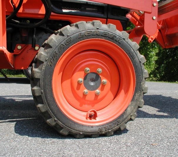

It has been working fine this way. Next time the loader is on, I'll need to get it full and take a look at the tires. Both front and rear feel pretty hard with 10#, and are not bulging the sidewalls.
The fronts (23X8.50-14) don't show up in the B7500 owner's manual. The nearest size in the manual is 23X8.50-12, and inflation max is 35#. This pressure max. matches the info on my 23X8.50-14's.
The rears are 12-16.5. The tires show max pressure as 40#, which is what the manual gives as the inflation pressure.
With 35# front and 40# rear, I may as well have steel wheels. These tires would be hard as rock.
I'm sure no tire expert, but with anywhere near 10# pushing each and every little square inch on the inside of the tire, it would seem like it is seated pretty hard..................chim

Hazmat, one of the jobs today was filling in a big low spot, and it involved a whole bunch of trips between the pile and the low spot. I pulled onto the blacktop and took the attached photo with a load of topsoil in the FEL. There is some deflection, but I didn't think it was excessive. The front tires have a very short sidewall with the 14" rims, and it doesn't take a lot of air to make them pretty stiff. If I did a lot of loader work on blactop, I'd probably want to inflate them a bit more.
The rears don't show much deflection at all, even when carrying the Landpride AT2560 RFM, which is a heavy unit. My tire gauge starts at 10#, so I think I'll look for another. The rears look like they would be happy with the pressure in the single digits..................chim

Thanks for sharing your experiences. Also thanks for the picture. I think I'm going to give lower pressure a shot. My rear tires aren't filled yet, so I've got nothing to lose (except air /w3tcompact/icons/grin.gif).
