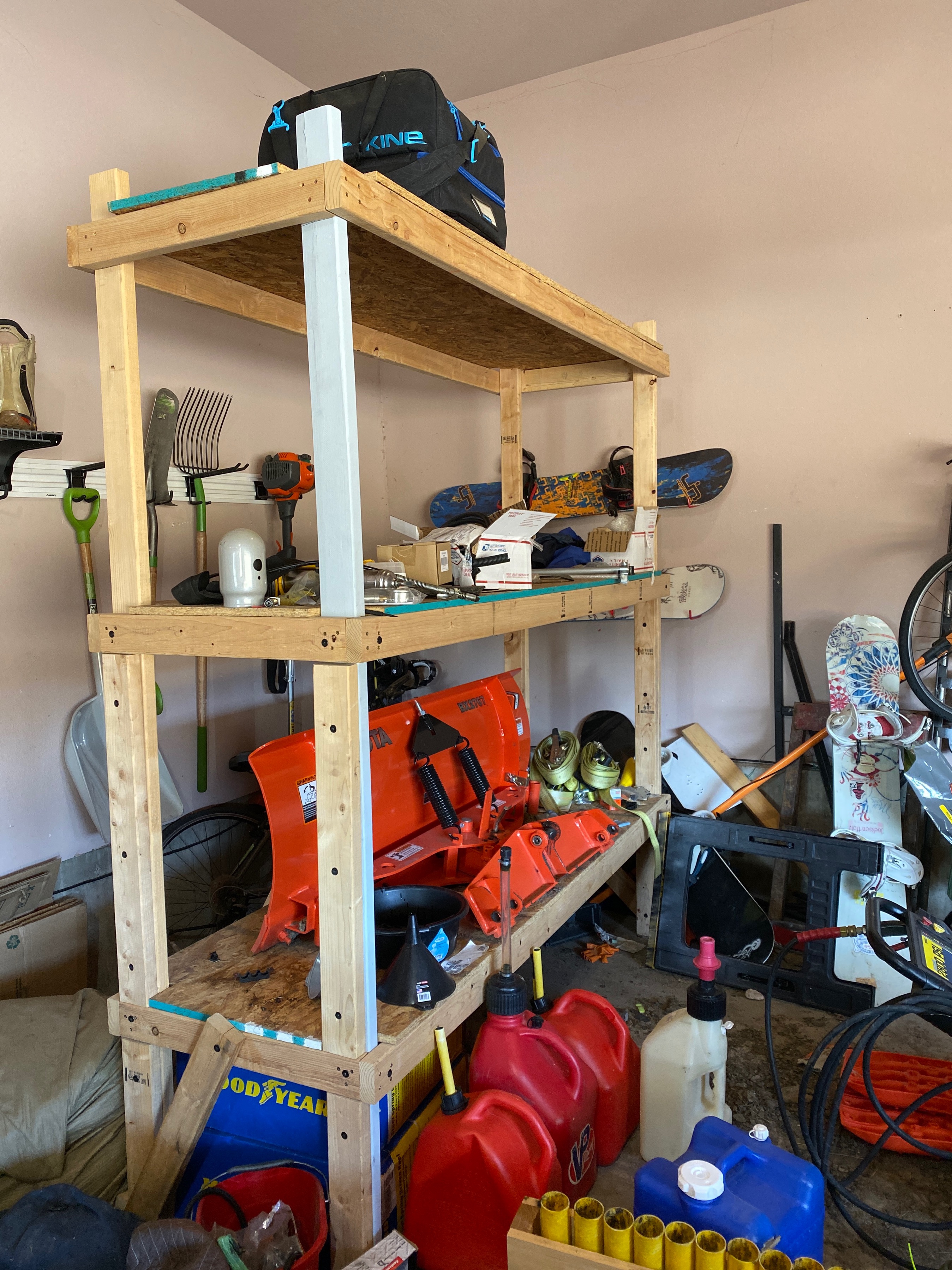

I did. Works great. Mine is 3 levels, although I built the top shelf too high and I can’t drop implements on that shelf. Which is a bummer because I have 3 FEL implements (snow plow, grapple, bucket). I can’t find the YouTube video that inspired my design, but it’s basically the same. 2x4s worked fine, but I ended up sistering a 2nd 2x4 to the frame and adding some cross braces. Added bonus is that my MMM deck slides under the bottom. Pallet racking will work too if you have more money than time. In the process of moving everything to our new barn, so a little cluttered at the moment... IMG_2556.JPG

I've got a 84" bucket and 66" grapple, so I was figuring bucket on the bottom sitting on some 6x6's and the grapple on top.
