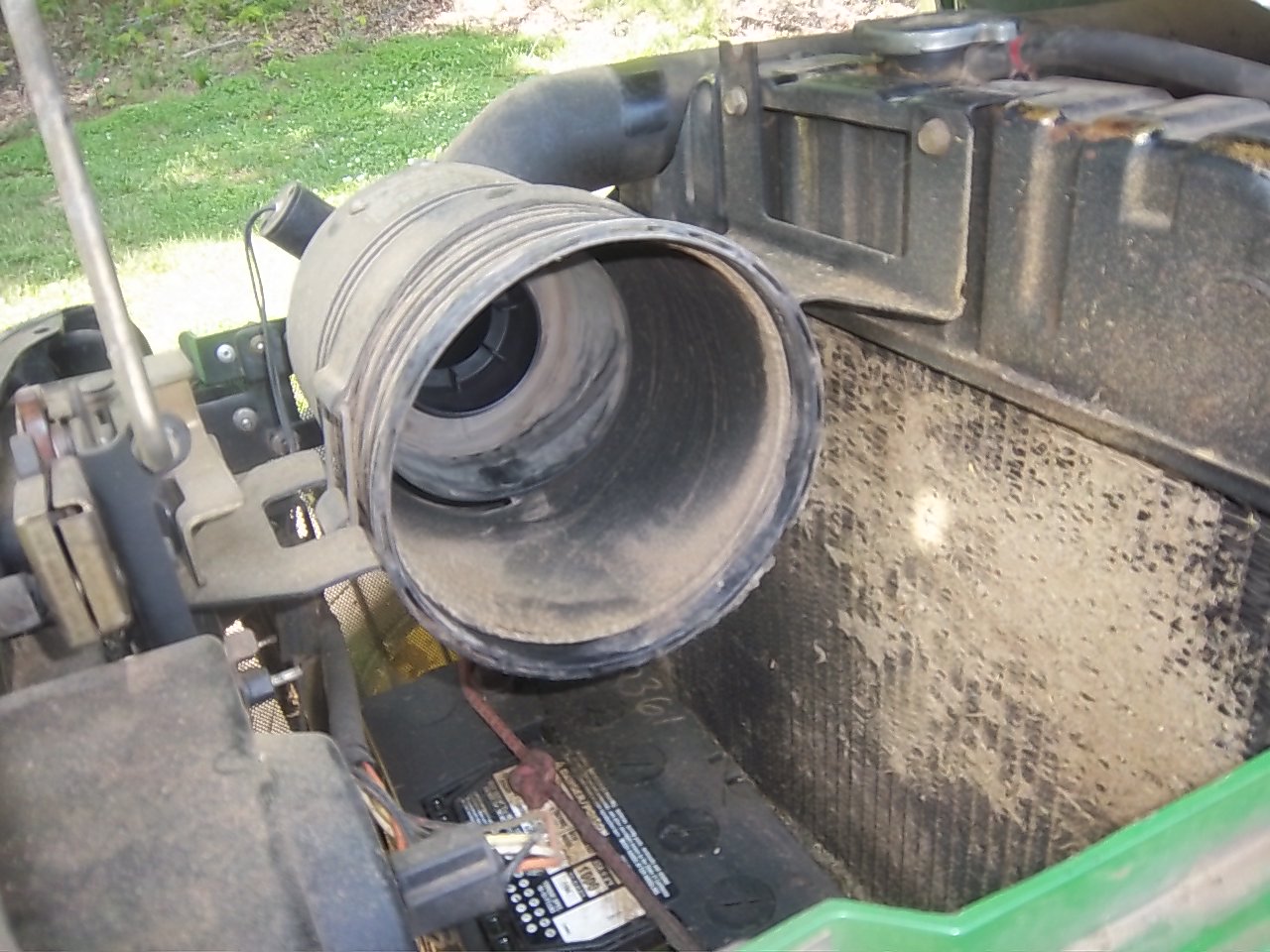

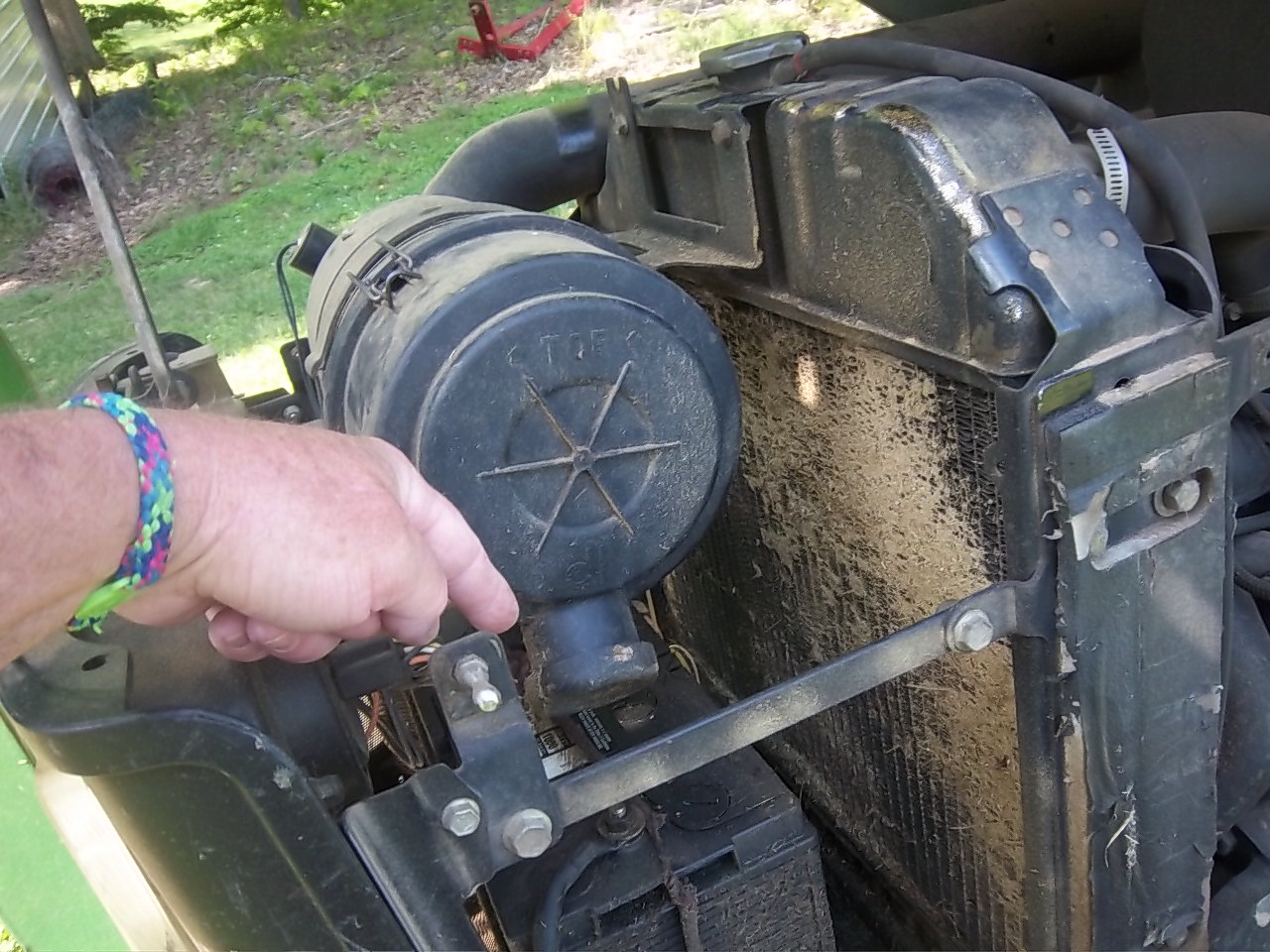

Thanks Quebecguy.... When I went to do this years maintenance on my tractor, I change the oil and filter and the hydrophilic filter and lube. I pulled the air filters out and saw the antifreeze in there and thought the same thing. I assumed there was NO WAY antifreeze could get in the intake so I COMPLETELY dismissed the idea. I assumed the same thing you just said.......until I saw it dripping out.. Pic's are on the way... Thanks Guys!

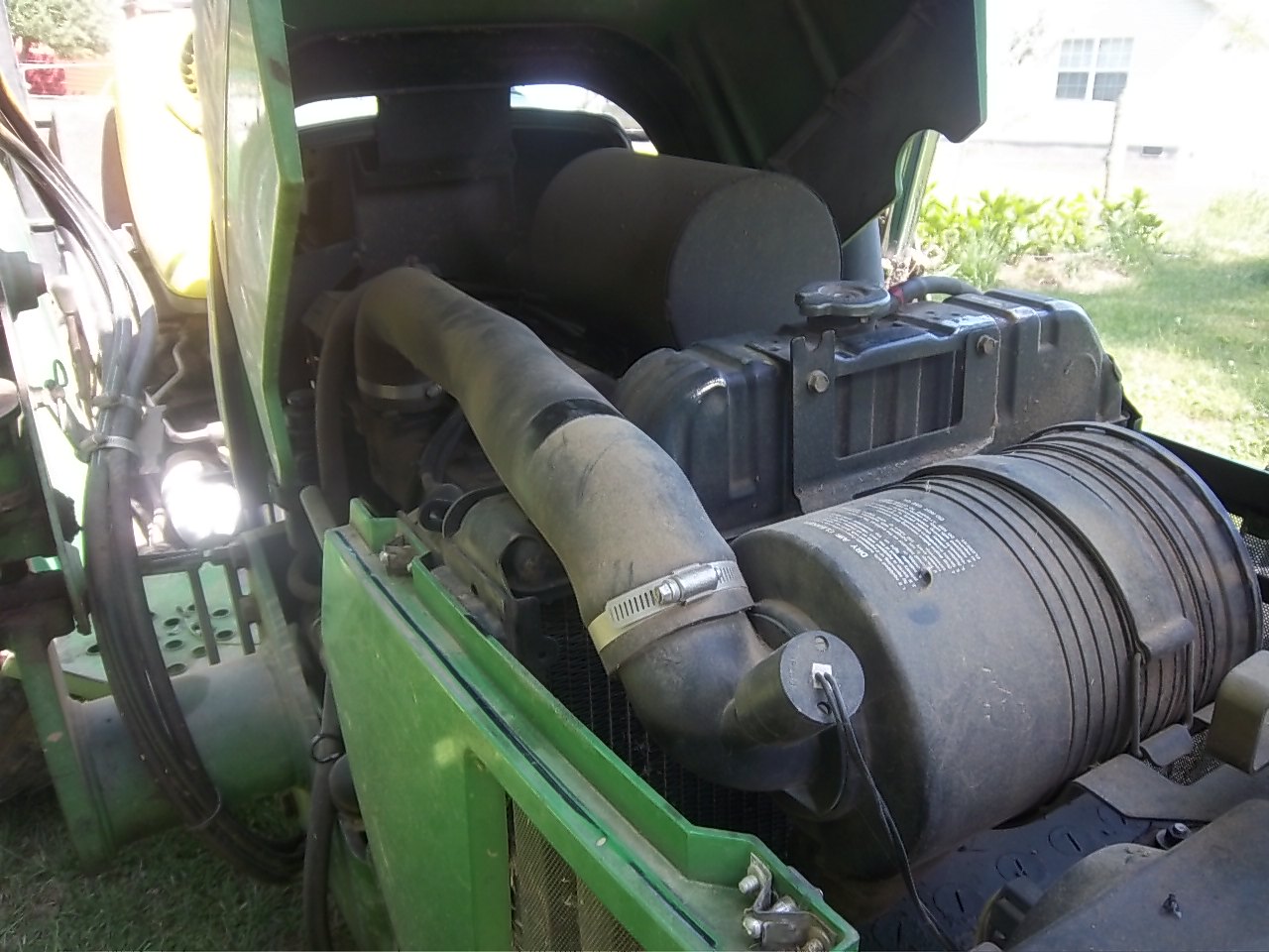

Has the large hose that goes from the air filter housing to the motor (over the radiator) worn a hole in the top of the radiator and in itself? I'm not after that Cuban cigar as I managed to quit smoking a few years ago.

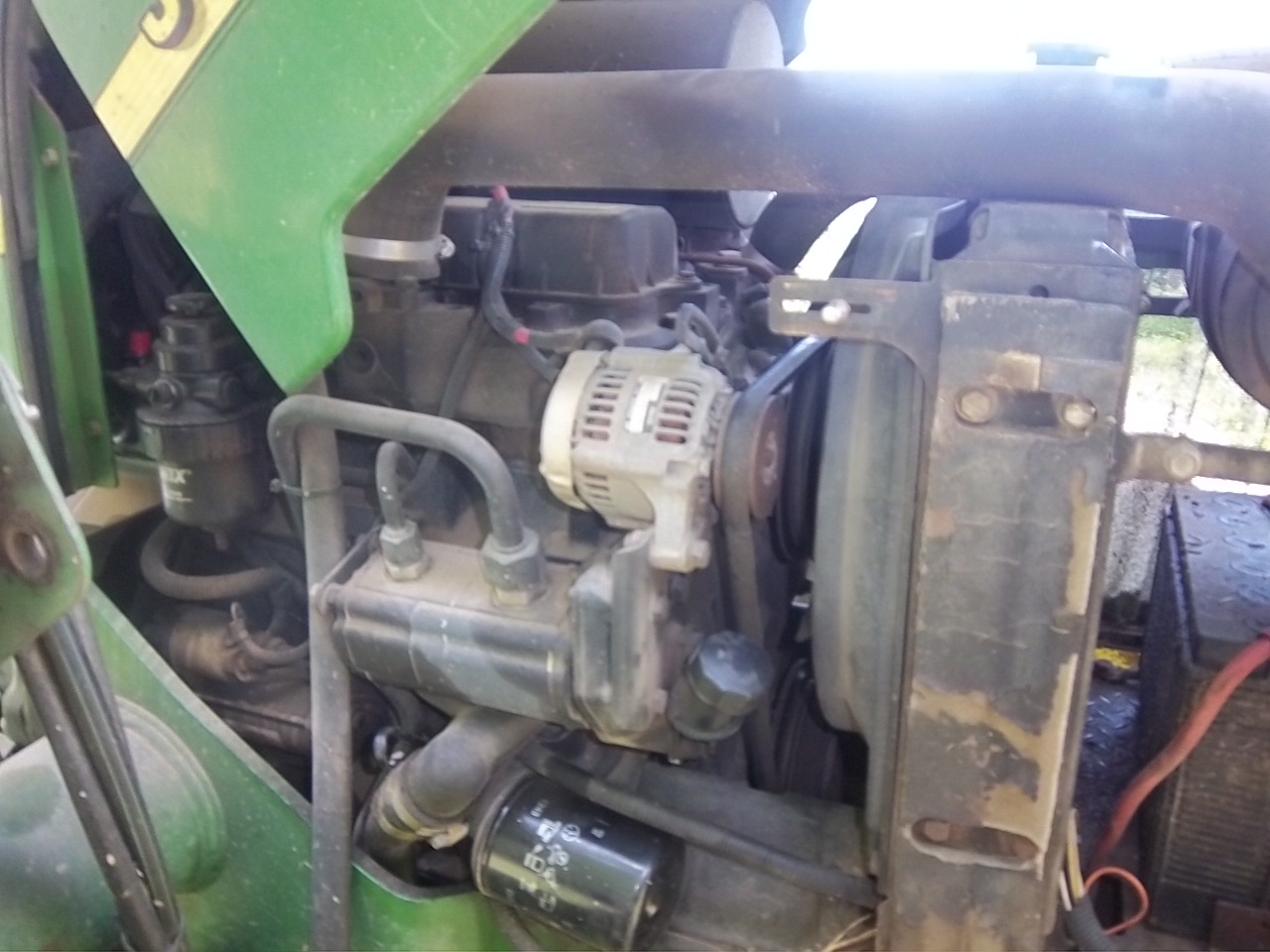

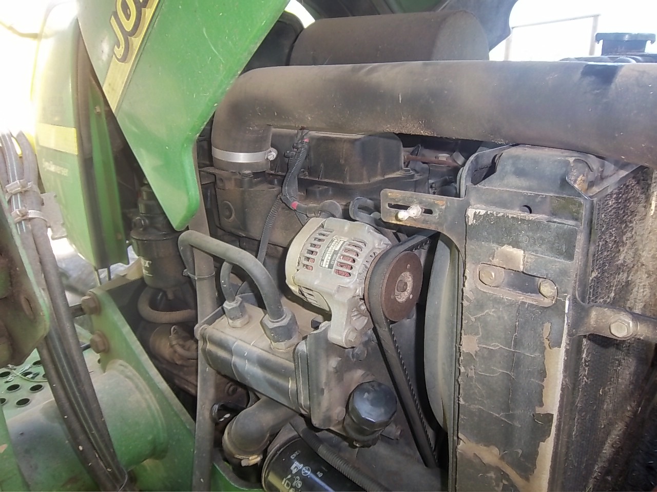

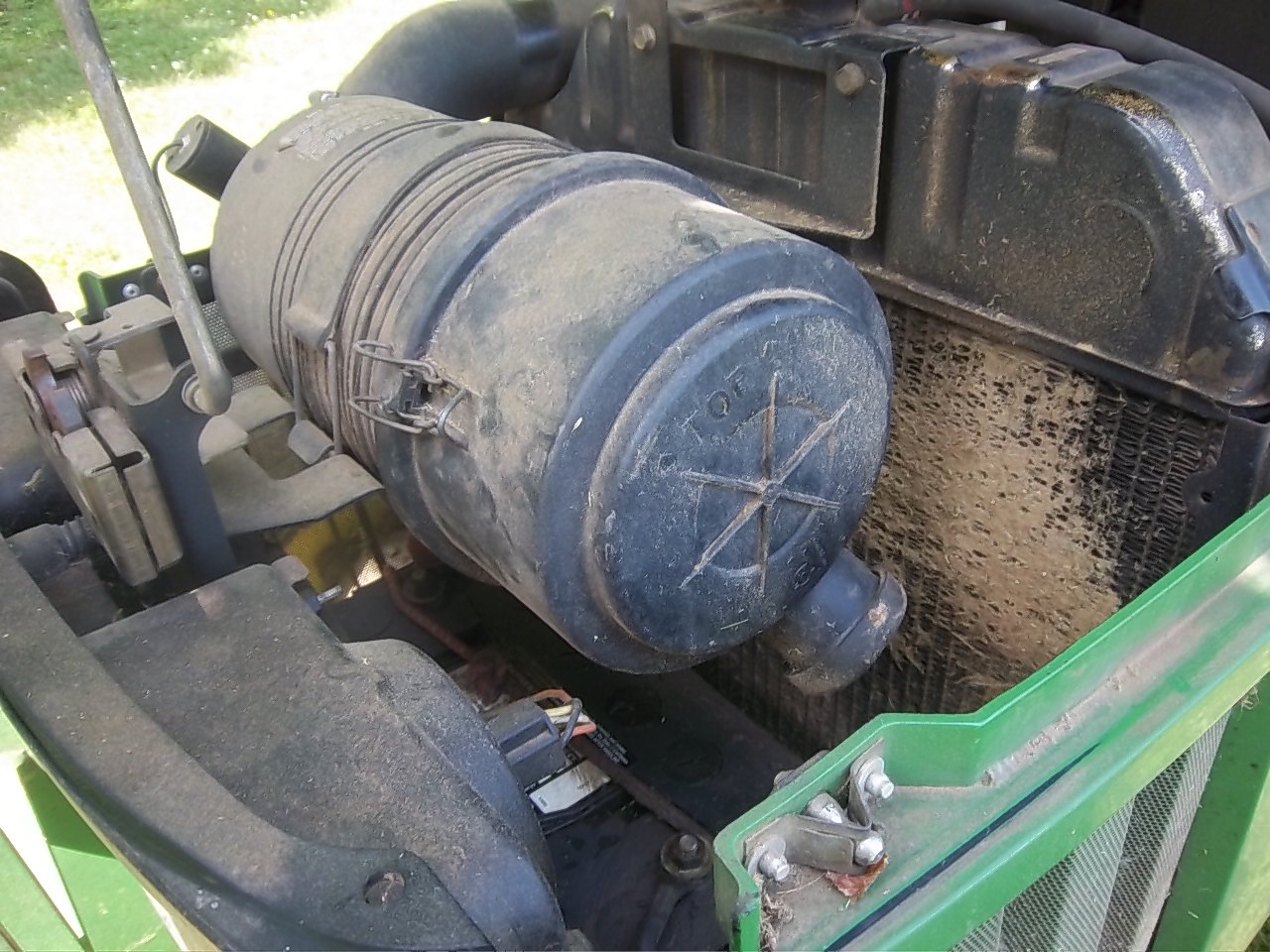

Ok here are some pics. First, I was just bush-hogging so that is why the radiator is dirty. I always clean the front off when cutting for I know how dirty it can get. Second, before anyone calls me an Ole Hippie for the bracelet I am wearing, it's from my 2 year old granddaughter who has me around her little finger like a ring...:) I am pointing to where the coolant was dripping from... Let me know if there are other pictures needed....Thanks Guys!
Good Thought! But no... You can always have that cigar sent to a friend :)

The inside of the filter housing looks nice and dry. The air intake hose from the filter to the manifold goes vertical then horizontal so I think that rules out coolant moving from the intake manifold back up the pipe all the way down the hose, through the paper filter element, into the filter housing and then dripping out.
Inside of filter housing dry.
Inside of manifold hose dry.
Paper air filter element dry.
I think you have a pinhole in the radiator that is shooting a small stream of coolant onto the air filter housing.

The intake is under negative pressure when the engine is running, so a cylinder would have to fill completely to backfeed coolant under radiator pressure when the engine was off, and that would be pretty evident. Judging from the pattern of dust (mud?) on the front of the radiator, I would also suspect a pinhole in the cores or top tank or seam. A quick test would be to pull both radiator hoses, block them off and put a pressure tester where the cap goes and see if it bleeds down. Or tape a piece of cardboard onto the back of the air filter housing and see if it gets wet.

What about that little white spot in the core of the radiator ?
