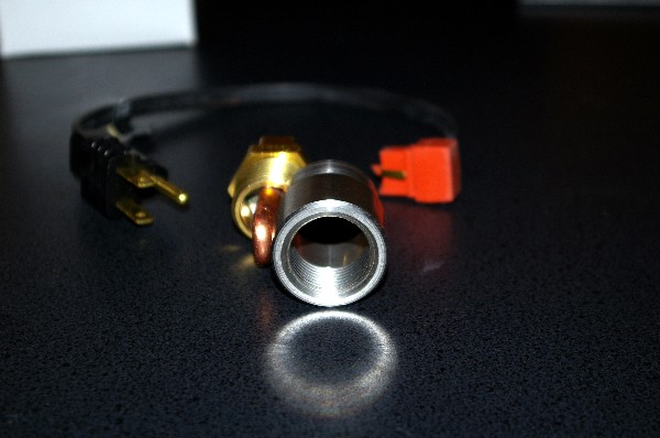

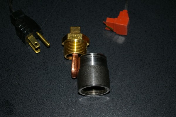

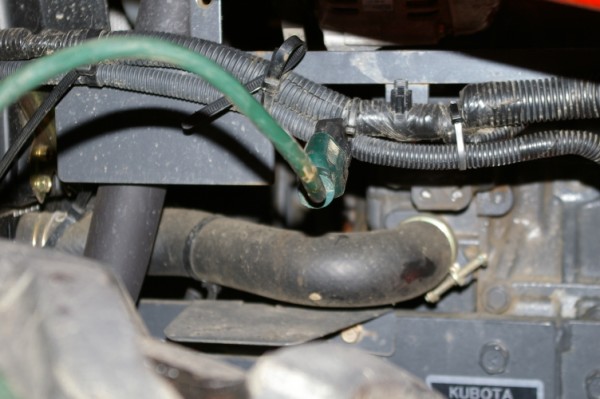

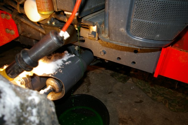

Time and time again I have read here how lower hose heaters are easier to install than soft plug heaters. I have never understood that, and never will.
I'll be the judge of that . I'm going to install the block heater on my Kubota if I get the time this week..
   / radiator hose heater project rant
#14
JOHN K,

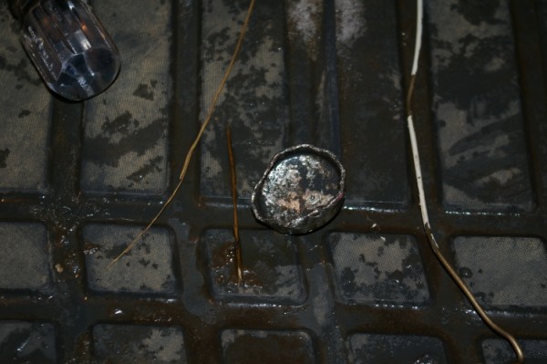

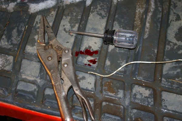

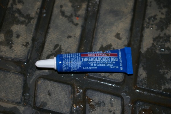

If you get to yours before me,tell me how you got the freeze plug out.The old threads said they npoked a hole in it and used pliers,and one said tapped it in on right side then pulled it out.Gonna use any lock tite?
ALAN
   / radiator hose heater project rant #15

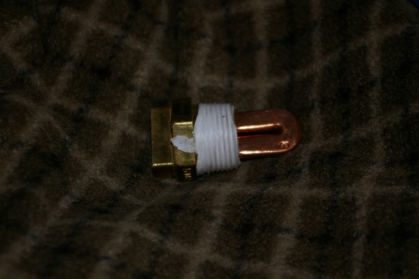

The instructions said to use locktite on the adapter bushing that goes in the block and teflon tape on the threads of the htg element. I'm going to whack it on the side with a punch. I knocked a lot of them out of engine blocks and some are tougher than others but they'll come out. Didn't check how much room I have to get at the plugs though. Hopefully it should be easy. DARN! I shouldn't have said that. You know how things go..........

The freeze plug should be able to be pried out by getting it to cock in the hole. Pound in on one side and pull out from the other. I will sometimes drill and insert a large screw on one side and pry on that while tapping on the other side with a chisel and hammer. Yeah, takes 3 hands...

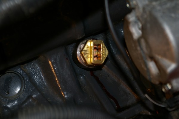

This weekend I put a freeze-plug heater in my cab L5450, same as the one I put in my other L5450 almost 5 years ago now. (step-by-step here) This time getting the old freeze plug out took the most time. The water passage is not very thick so there's not much room to "rotate" the plug out. If I were doing it again, I'd drill a hole toward one side for a large (like 1/4" dia) tapping screw. Grind the screw point blunt before turning it in and jacking the plug out.
