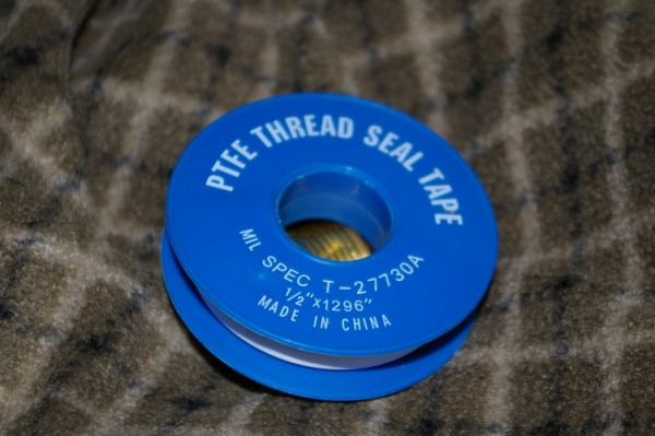

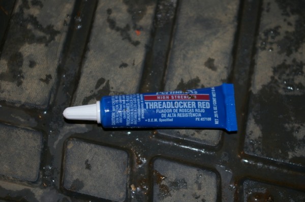

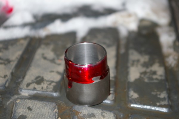

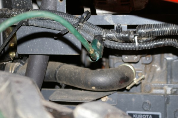

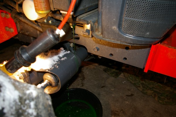

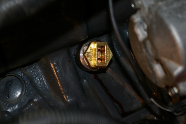

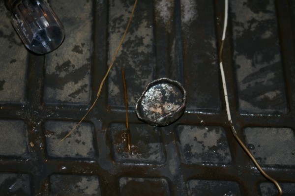

Got home from work today and being as impatient as i am I brushed off the snow and pulled the tractor in the garage. Drained the antifreeze and insralled the block heater. Total time. 2 Beers.........The hardest part was getting the old freeze plug out. Almost lost it inside the block because it's a shallow fit to the inside of the block and hard to flip. Here are some pics...The stress of doing it is now gone. Not a bad hour project. If there's a failure in any part it will probably be with the Teflon Tape made in China...
