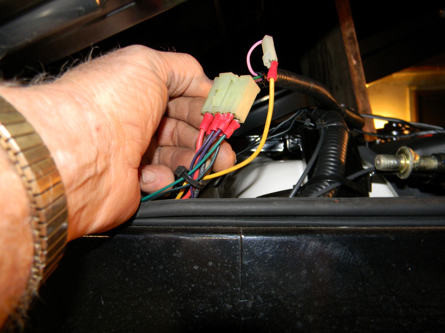

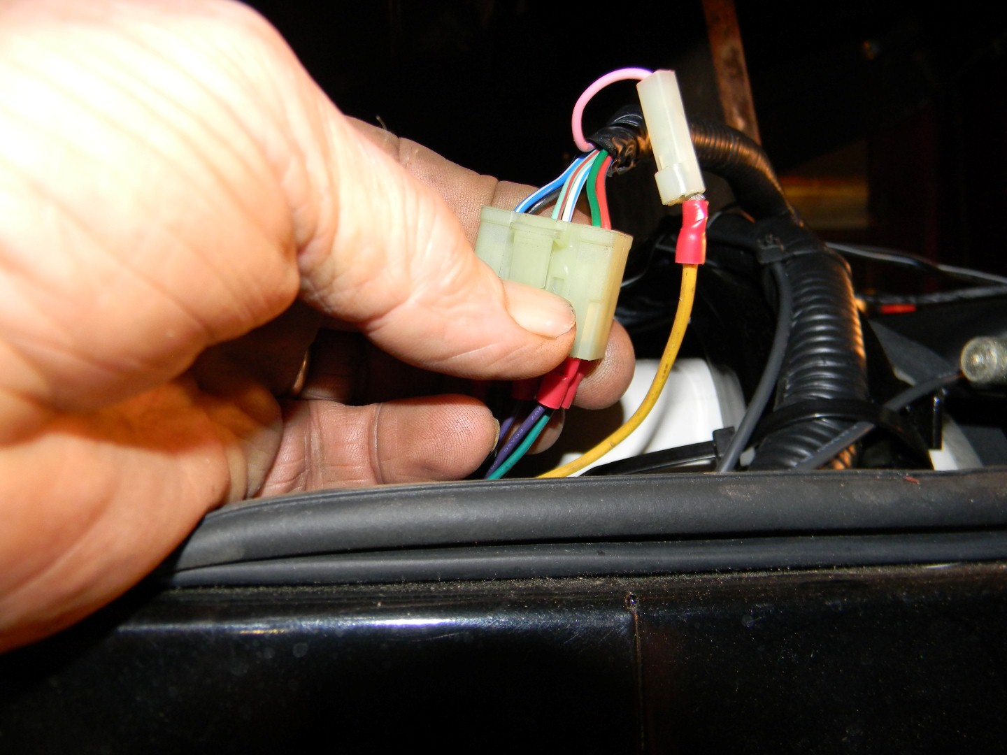

OK guys, for those of you installing aftermarket radios in your cabs here is the wiring for the factory plug.
This will be correct for all 3000 series cabs and I suspect the 4000 series cabs will be the same.
Picture 1 shows the 6 pin radio harness from tractor
Pink wire separate from the harness = 12V Battery Hot
Blue w/white stripe = 12V when ign is on
Black = Ground
Light green w/brown stripe = Right Spkr +
White w/blue stripe = Left spkr -
Green = Right spkr -
Red w/blue stripe = Left spkr +
Last thing to plug in would be the antenna wire into the radio
Second pic shows wiring from my radio (may be different colors on yours)
Also attached is a word doc for the above plug pin out.

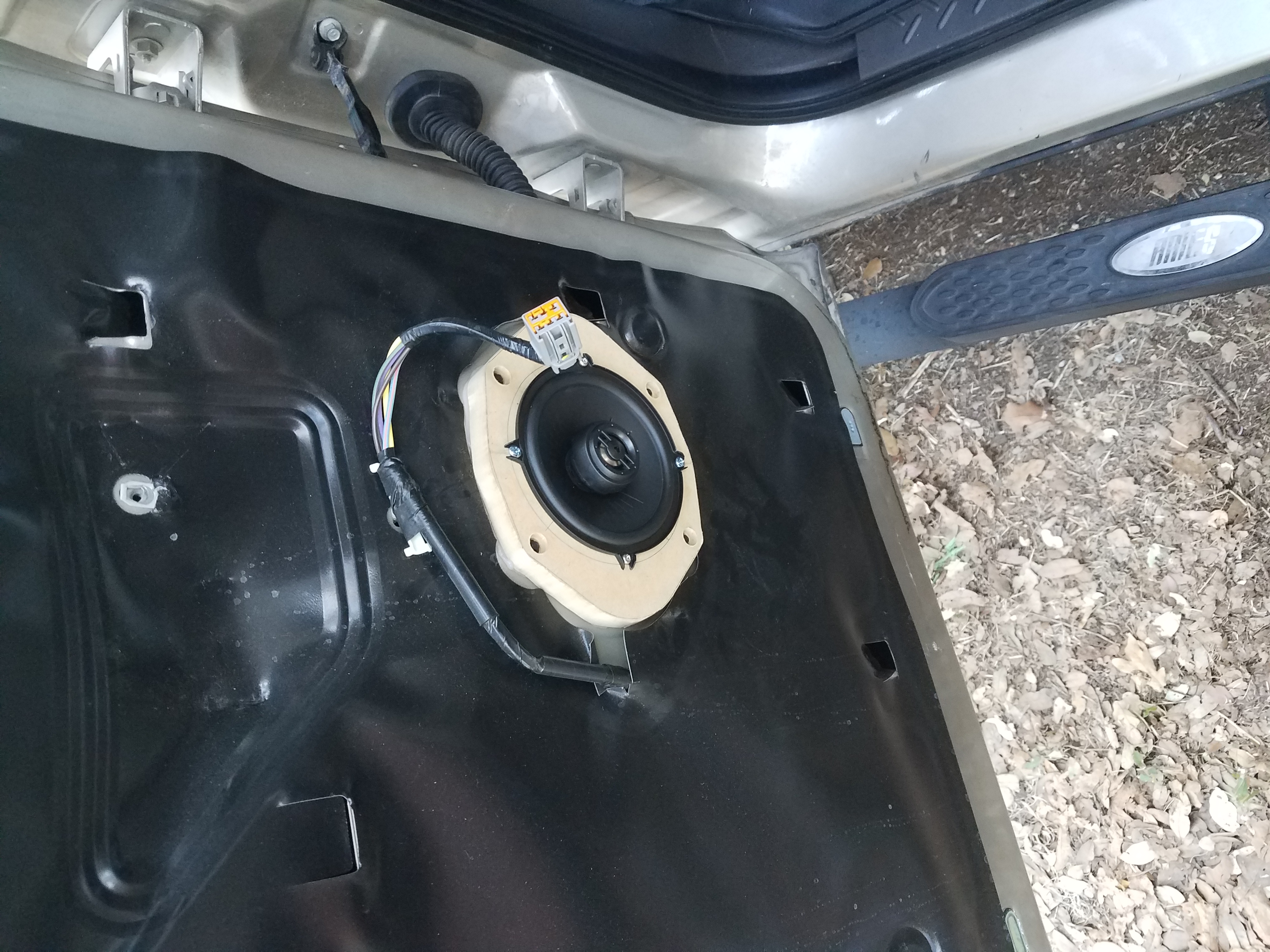

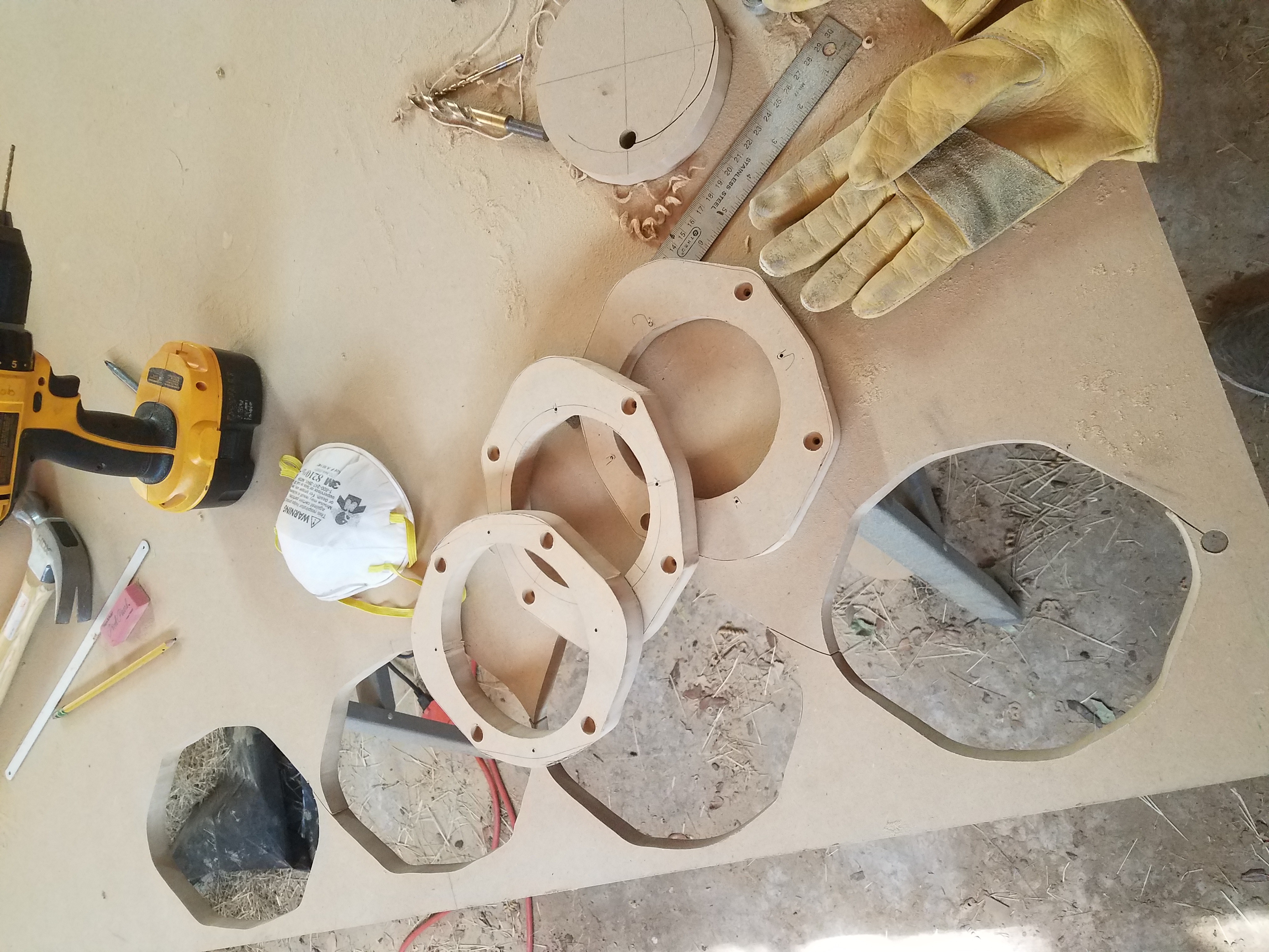

I upgraded to kicker 4” and Kenwood Marine headunit as well. Was pondering putting 6.5” in but couldn’t bring myself to cut the new headliner. It was a improvement, but I agree it needs a small sub.
   / Radio wiring for XR3037HC cab models #10
I made these for a different reason but using the same concept, you could build spacers to give you the room you need to go from 4" to 6.5" without enlarging the holes.
