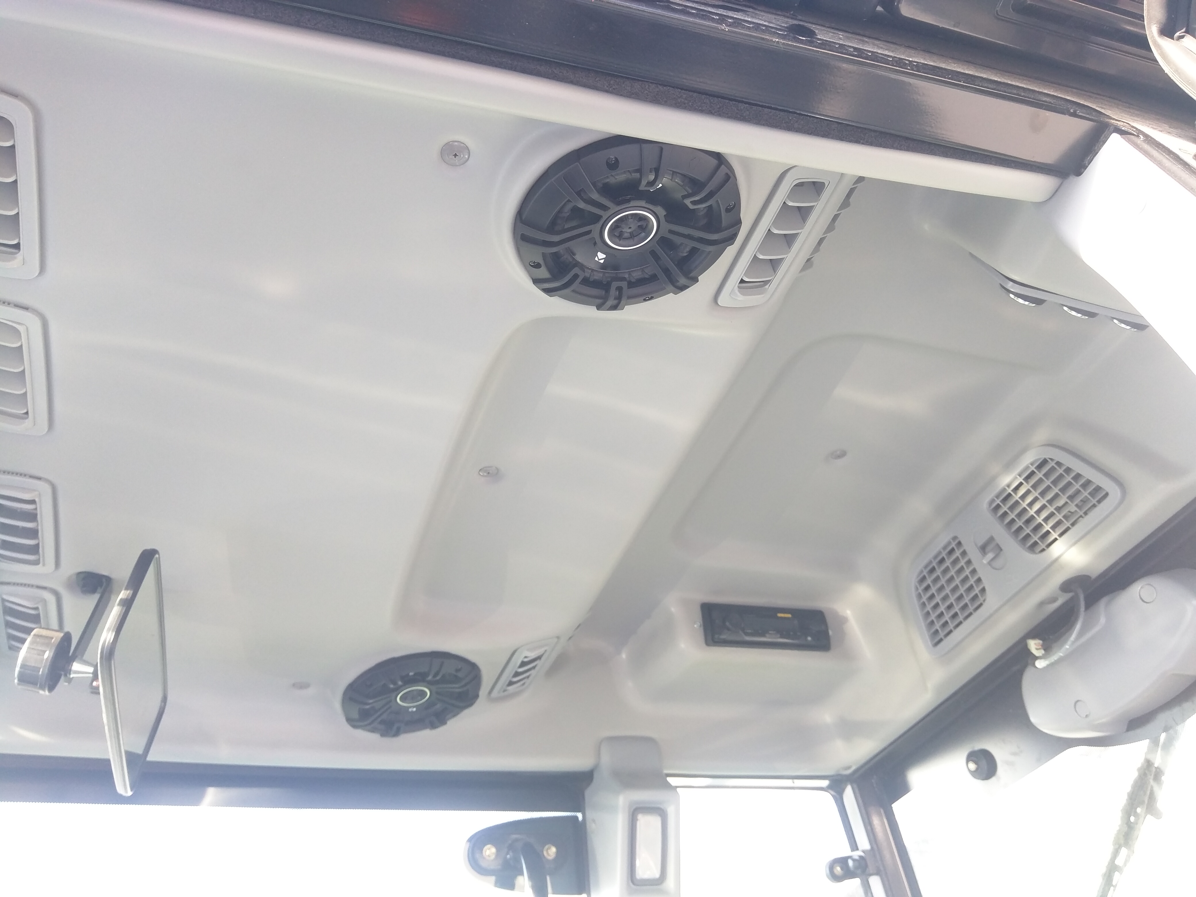

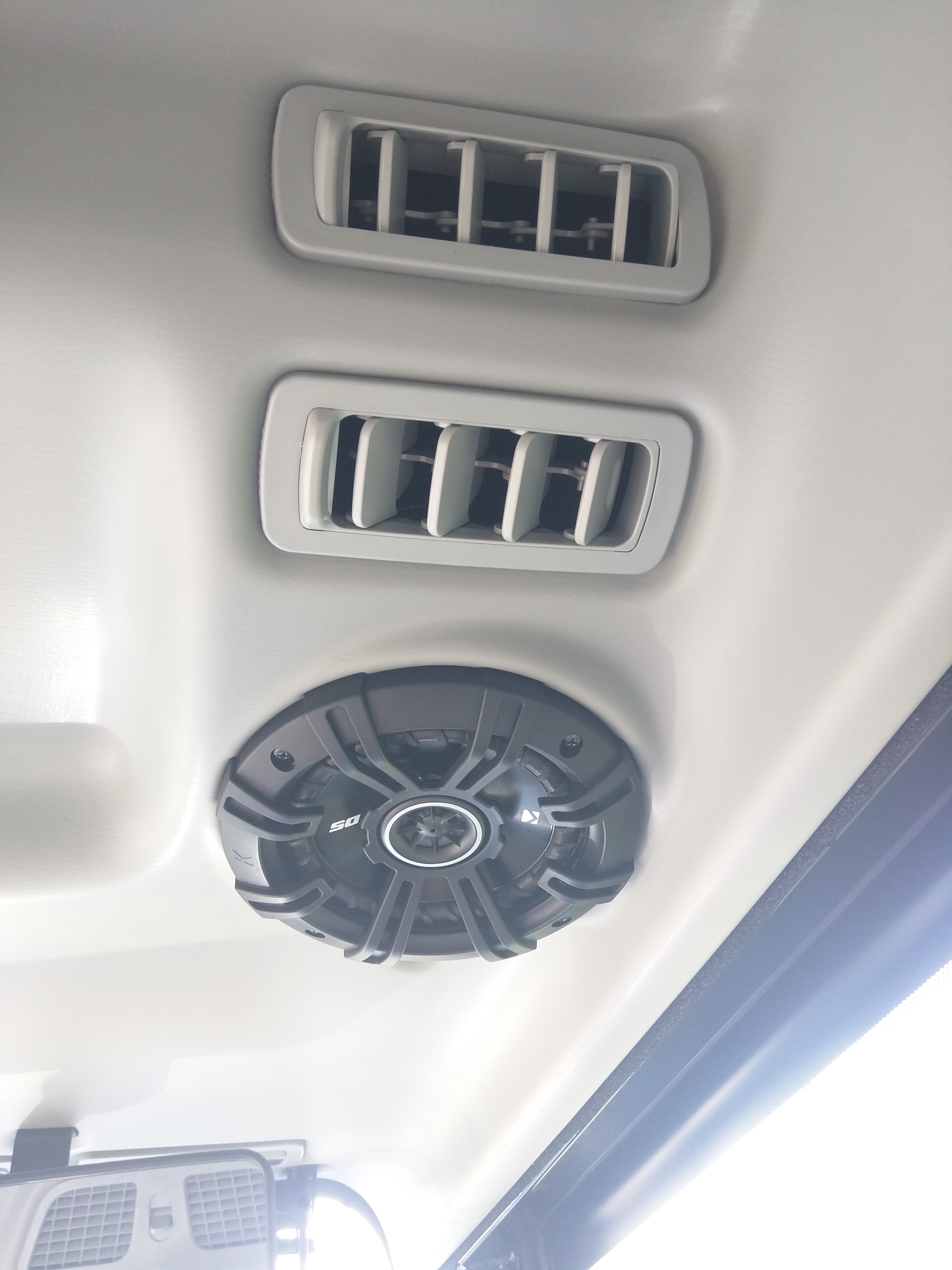

I was doing some digging on this topic and thought I'd add in case anyone stumbles on it. I put some nice Kicker 5 1/4" in mine. I made some 4 to 5 1/4" adapter rings so I didn't have to cut the headliner and then removed the roof panel to install the backing clips for the screws. Turned out very well and made a night and day difference. If you want low end you'll have to add more, but these look factory and sound great with the Sony head unit.
   / Radio wiring for XR3037HC cab models #19
Looks awesome! Good job!
   / Radio wiring for XR3037HC cab models #20
Good speakers make all the difference in these cabbed tractors. I rock out in mine when mowing the pastures.
