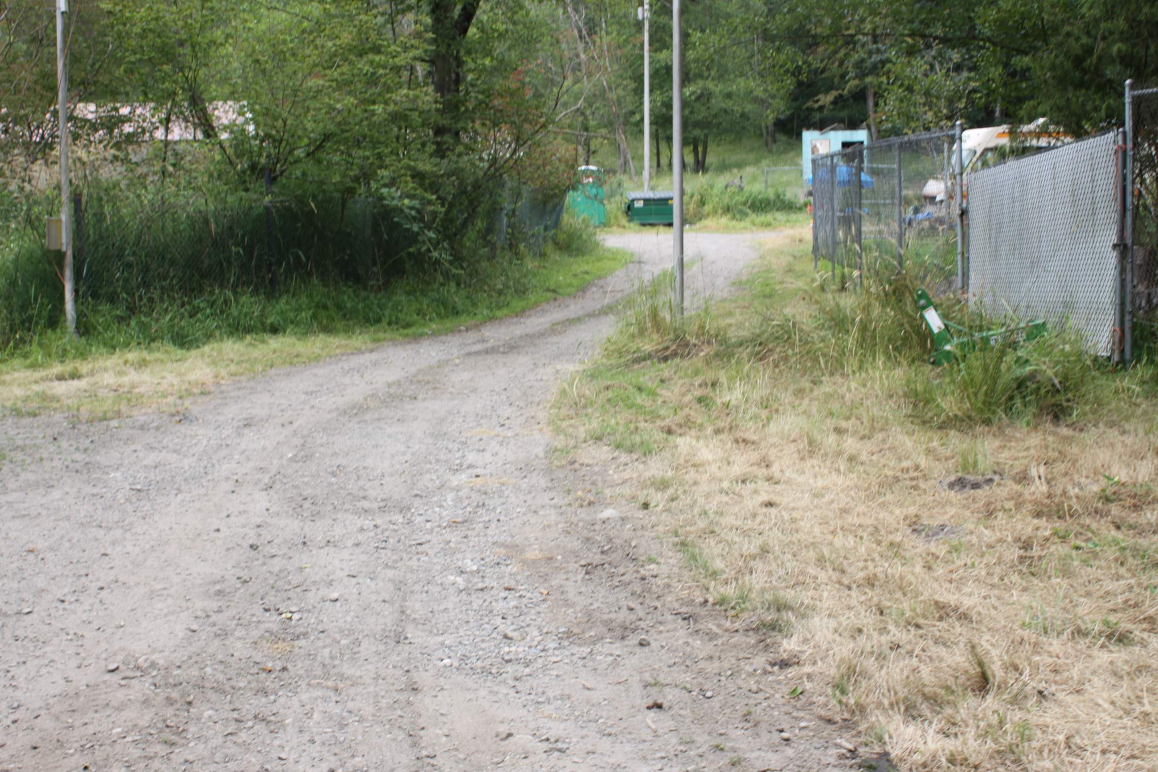

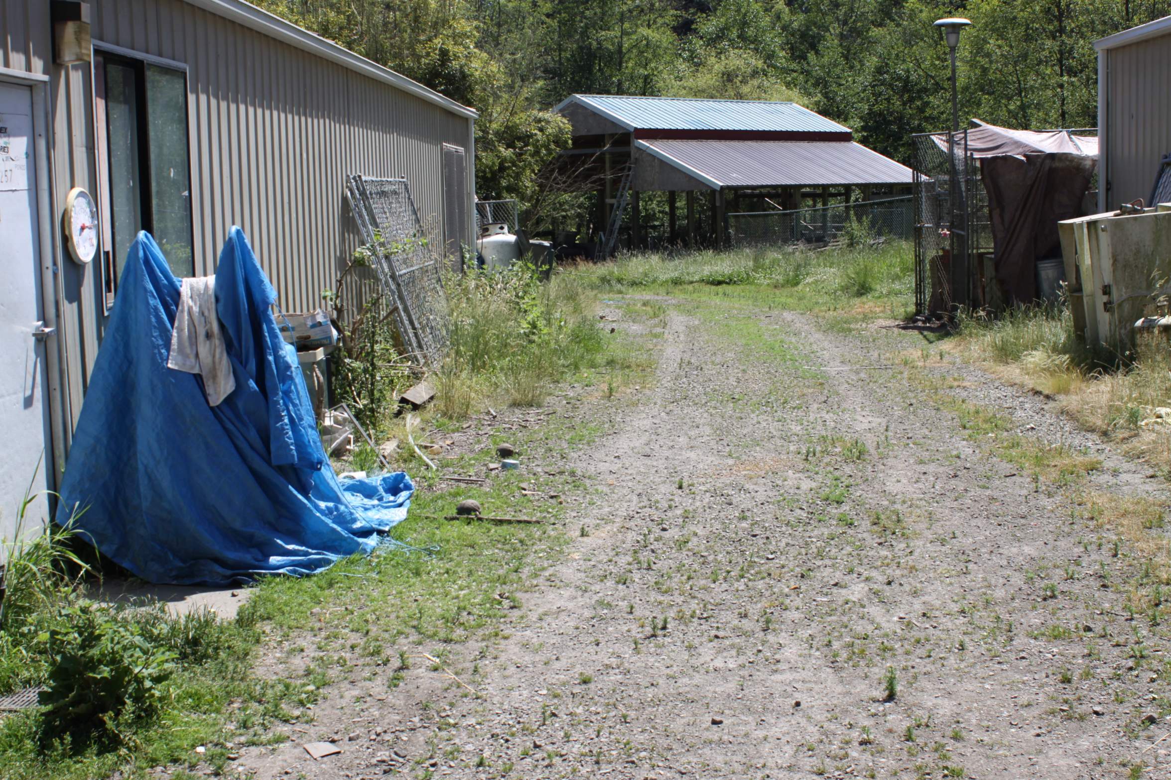

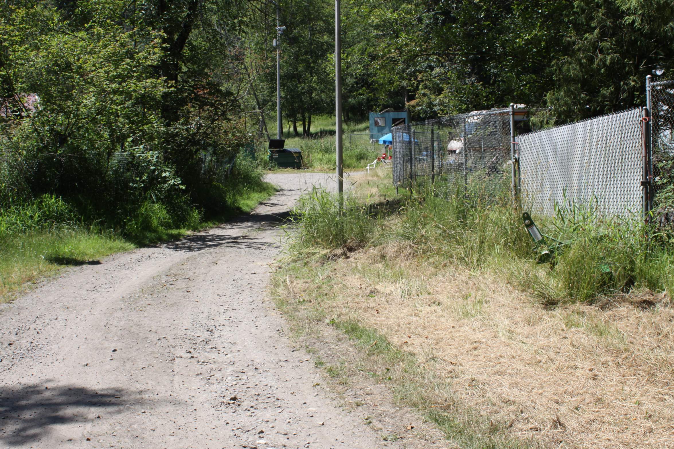

Until last summer when I started doing some rescraping, these roads have had no maintainance in 8 years. No money and no equipment.:(
Now that I have a tractor I am starting to do some maintainance again, but there has been no issues with driving a 2WD vehicle on them throughout the rainy season. To me, this is an all weather road. My road is in disrepair, but it is sound and usable even after 8 years of neglect. This is the difference that having a solid base makes. For the last two winters, I have had water 8" wide and 1/2" deep running 24/7 down one of the wheel tracks and there has been no loss of usability because of it.
It will be getting a major overhaul this sumer though.:D
