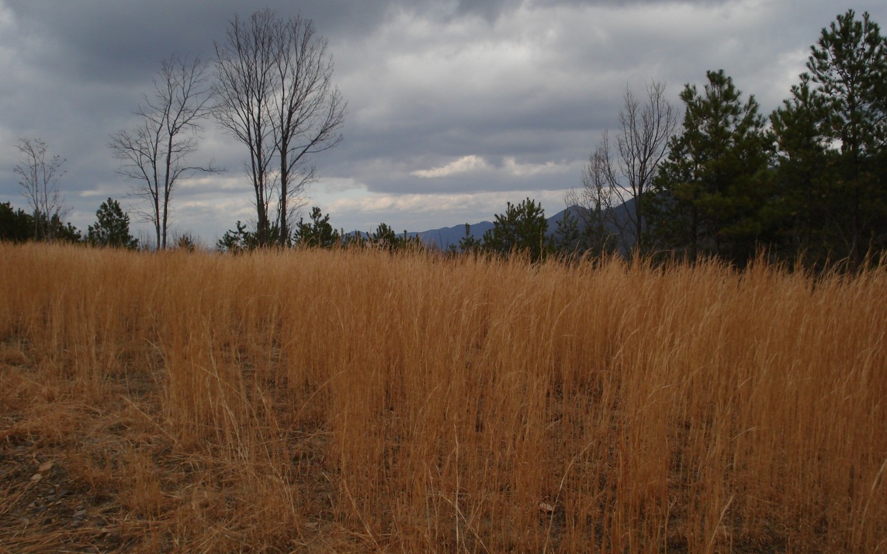

Jim, that road makes my EYES water....I can imagine what it cost. Did you have to foot all that bill? WOW. The ditches look great especially since you "lined" them with huge rocks. And the road looks like crush and run with small gravel OVER that. I had thought of the opposite....gravel with C&R on top. You guys are sure right I MUST have ditches or that road will be history. I'm waiting for the seller/developer now who said he would go out and "evaluate" it.
Thanks to everyone who has helped me with this and I hope it turns out OK, this is to be my "retirement" spot in 2 1/2 years and I'm having fun out there now.

Really pretty place Boeing. It is hard to tell how steep your grade is and with 3/4 of a mile I know you can't show it all. My experience with mountain terrain in N. Georgia was that on the steeper grades crusher run was the best option for holding the road. Larger gravel would end up down hill. In my lower areas where it would get wet the advice for a heavier base gravel is what I did. That worked well. Ditches and maintenance are an absolute. You should look into a rear blade or box blade. You will need it. Water is going down hill and going to take the most direct route. It's a given. Your project is to put it where you want it.
Sure hope your developer comes through with more work. If it were me pushing him it would be for ditches and culverts. Gravel is going to be expensive but you are not going to get it all, only my guess.
Mind if I ask who you fly for? My wife has been with Delta for 29 years.
MarkV
