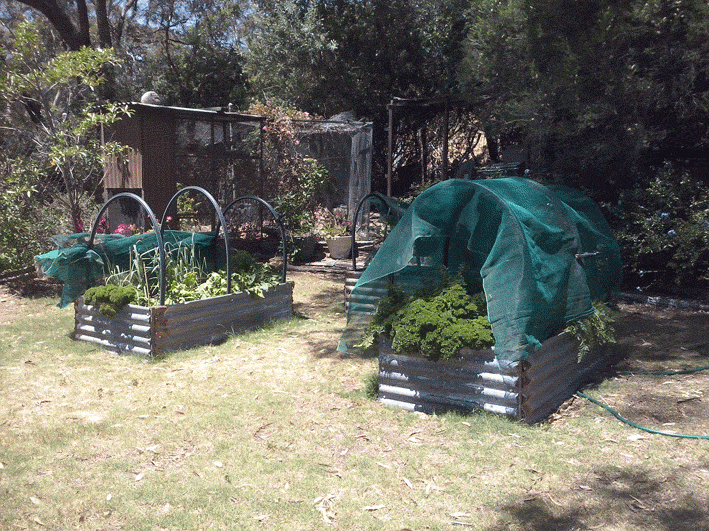

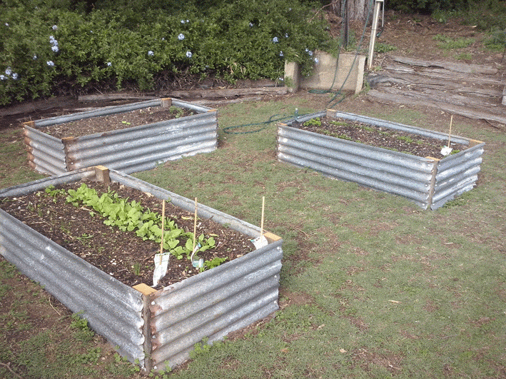

Nothing fancy here, but they work. Just some old corrugated iron, screwed together at the corners. They can be picked up and moved. I've made 9 of these so far and might make more. Most now have hoops of polypipe and shadecloth attached with loose cable ties, easily pulled over the top in summer. Keeping them watered is the main problem here (hence the shadecloth) but I also wish i had fully covered the base with plastic to help retain water.

That is a clever design also. I could get the same color metal as the house roof.
