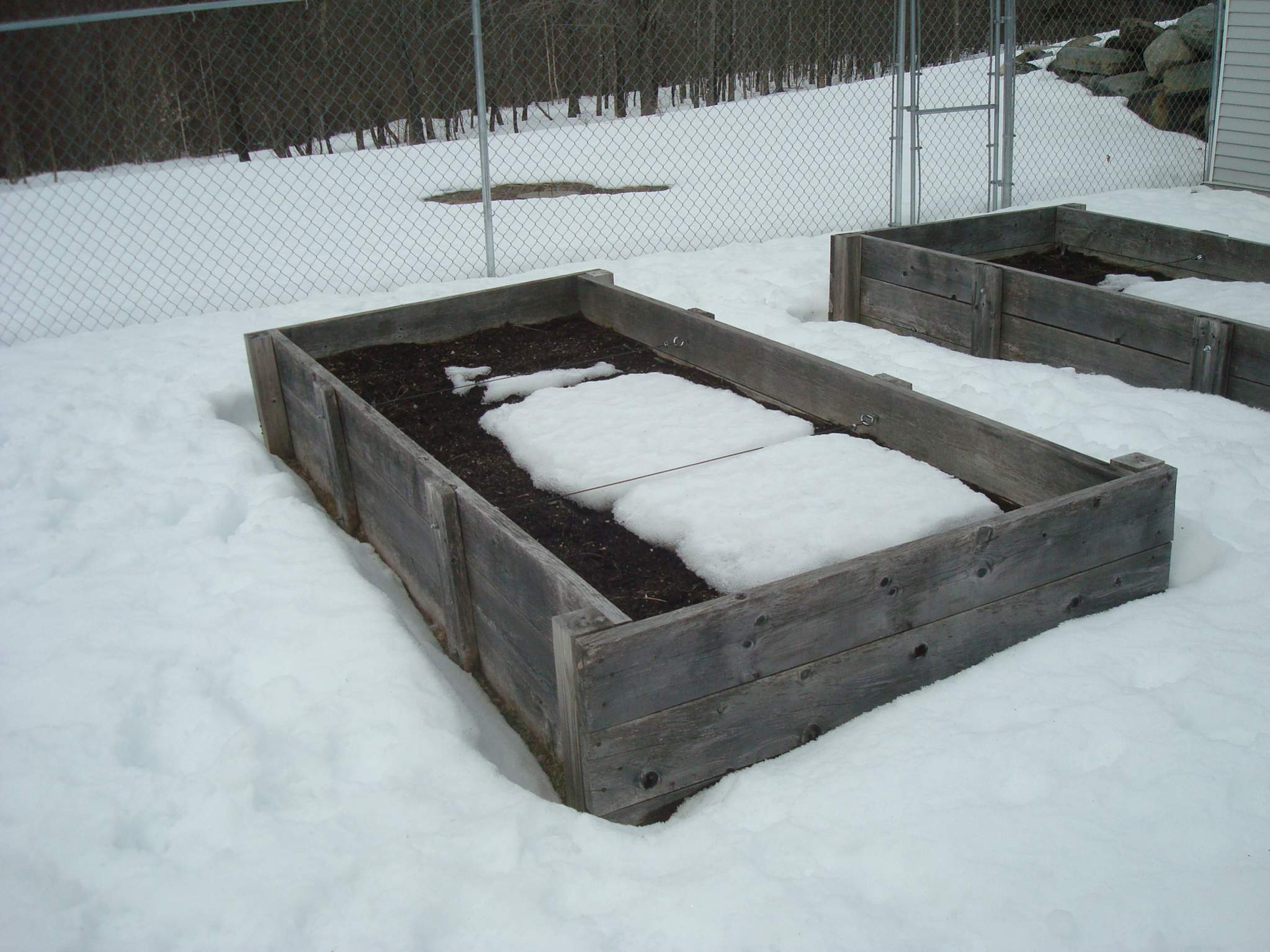

Here are pics of my beds today. They are 5'x10' and three 2x8's tall. There are four bulge restraining cables per bed, two at ground level and two near the top. Not sure how necessary those are, but I have no bulging issues--in the raised beds at least. :p
As you can see, winter doesn't want to leave. :( I will add peat, compost and composted cow manure before planting this spring.
