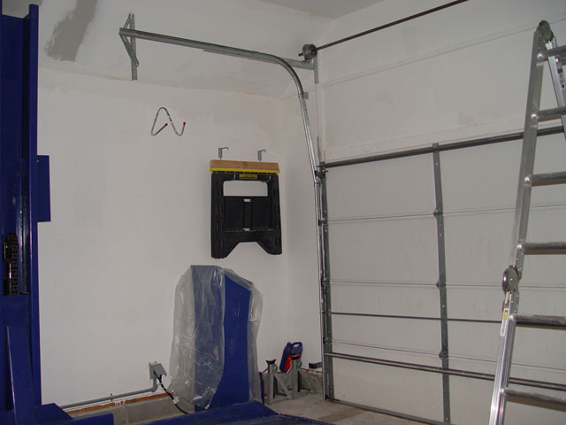

What are you going to do for a door? Overhead door requires a header of 15 inches. Less if you go with low headroom hardware. Stay here and invest in some good photos. The information you are getting is going to save you money down the road.

Pictures would tell 1000 words. What about just raising the whole roof system? And about the door, you can always put a wooden header in if necessary, just have to take out a few more block.

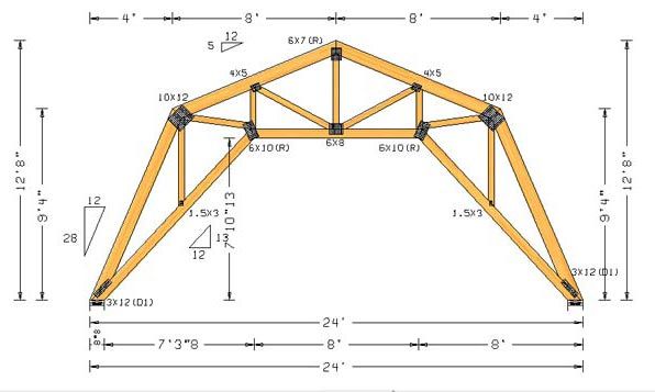

So how much work do you want to put into this? Are the block walls 10' high? It wouldn't be the cheapest option but you could replace the roof with gambrel trusses. This is how my garage is done. The ens of the truss sit on top of the side walls. I added simple extensions to give it the classic barn look. By doing so you could make your new garage door a "high lift" design. Here's a picture of the gambrel truss that I found on the internet. The truss design is almost the same as mine.
and a high lift garage door.

Altering any ready-made truss is a BAD idea. If you need additional ceiling height, you should consider raising the whole roof system.
That's right. Trusses shouldn't get any support they aren't designed for. I read a lengthy article in a farming magazine years ago on roof failures. There were two that were traced to additional supports. One was caused by the owner adding supports somewhere on the bottom chord because he thought it would help. In reality it changed the stresses from what the trusses were designed for and brought the roof down when the snow laid on it.
The other was one that the owner divided the internal space and secured posts to the trusses. Again, the posts changed the way the structure was loaded when the snow came and the roof fell. The article went on to explain that any connections made to the truss needed to be done so the truss can flex. There was a detail to follow that used a sliding connection to the truss so the vertical pipe being used to support the dividers could move up and down without getting bound up.
