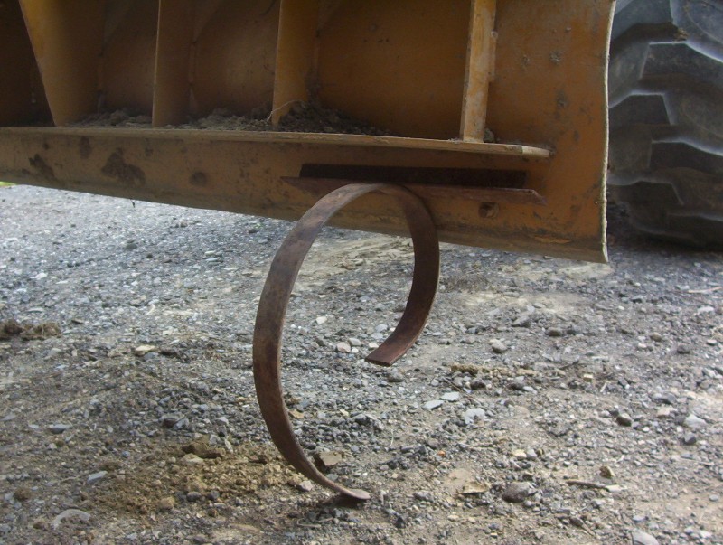

I am in need of a rake to mount on three point. With what I have in mind is using it to gather brush, and to loosen soil, if I want.
I have this heavy duty, 8" rear blade. Instead of building a whole new rig to mount a rake on, I would like to use this blade.:eek:
Con't...

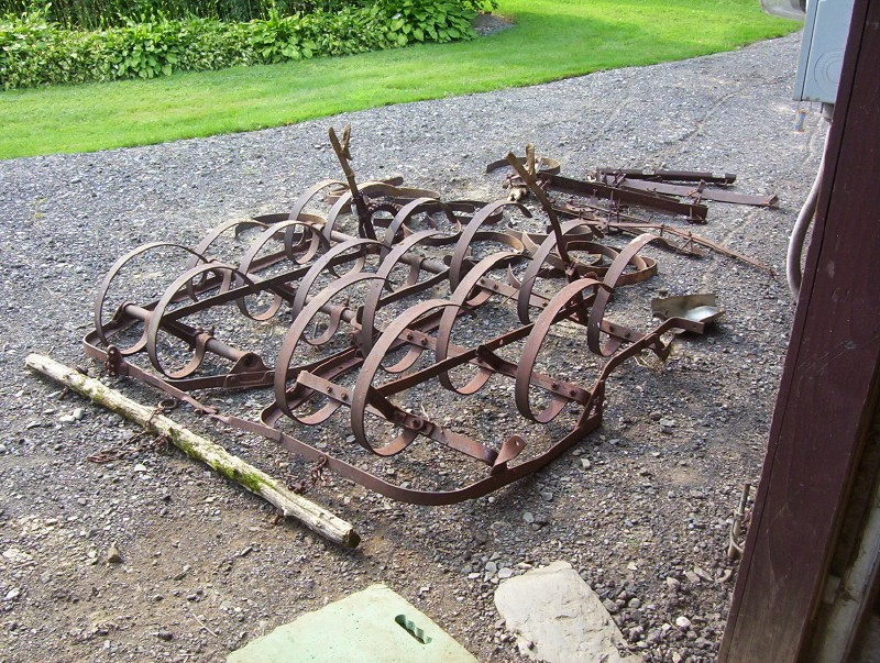

I also have parts and pieces of old horse drawn "Spring tooth" harrows. Have 30 teeth in all. A couple of different sizes, but I think I can make them work for rake teeth.:eek: :eek:
[About 25 yrs. ago I used the harrow in front - pulled by a "63", 4 cyl, International Scout, door yard plow - to help level a couple of acres around my house.]

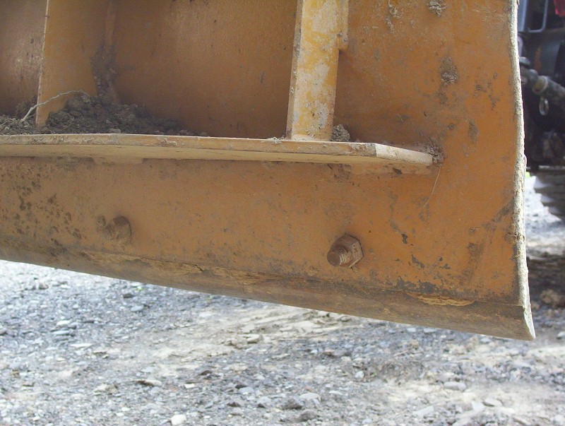

I would like to use these "spring teeth", mounted on a "beam", ( have some heavy angle iron I'm hoping to use), to fab. a removable rake that would attach to the bottom rear of the blade. See first photo.
I realize it would be heavy, that's what I want.
I would like to attach the beam - with teeth permanently mounted on it - using pins (?), or... in such a way that it is not a half hour job to mount/detach.:eek: :eek: :eek:
I am certainly "designly challanged", and have used this forum for many of the ideas it has presented.
When I think about attaching/detaching this rake, my face says :eek: !!!, and my brain turns to oatmeal.
I am looking for people with Visiion to help me solve my problem....well this one, that I'm willing to talk about anyway.
Al

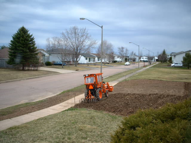

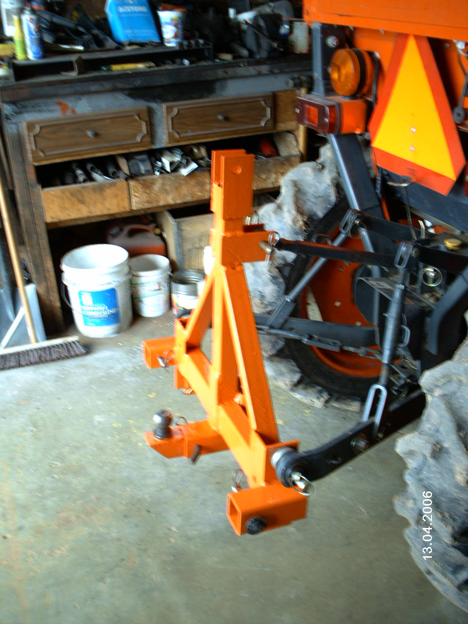

I rigged some spring teeth on an angle bar as you plan and it works extremely well. I find I need no weight to draw the teeth into the ground....their shape takes care of that: the harder the digging, the deeper they want to dig. Anyway, I built a multi-purpose receiver hitch for my 3PH. It has 3 - 2" x 2" receiver tubes, 1 in the centre for a trailer ball and a pair on the outsides to mount the spring tooth bar, future forks, etc., etc. Installing the spring tooth bar is easy - just pull 2 pins. insert and reinstall the pins. Perhaps you could weld 2 receiver tubes onto your blade for the quick attach setup.
Attached are photos of the receiver hitch and the harrow in action. Sorry, I don't have a closeup of the harrow.

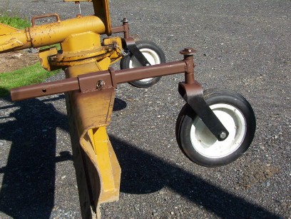

I actually do have a couple of recievers on the blade, per attachment.
You've got me thinking that perhaps I am making this more complicated than need be. I wanted to use the blade because it angled and swiveled. Maybe I don't really need the rake to do this.
I appreciate your input, cause now I'm really cogitating on it.:D

your mockup is almost there IMO
take some heavy gauge C cannel weld a series of 1" pins to the top 6, 8 , 12" whatever on center , drill matching holes in the rear stifening rib of the blade.
then bolt the tines on to the C.
something like
or you could go with heavy angle and bolt the font of the tines to the back of the L and weld some little reinforcemnt triangles to the inside of the L
i could be underestimateing the bending force involved but if properly braced i think it would work
the reason i say C or L is with tube you'd have no way of fishing nuts into the tube, although if it was heavy wall stuff i suppose you could tap it.
   / Rake Design Help Needed.... #10
Schmism has a good idea there, real simple to build. I would bolt the C or L to the blade rather than use pins, to avoid play in the connection.
