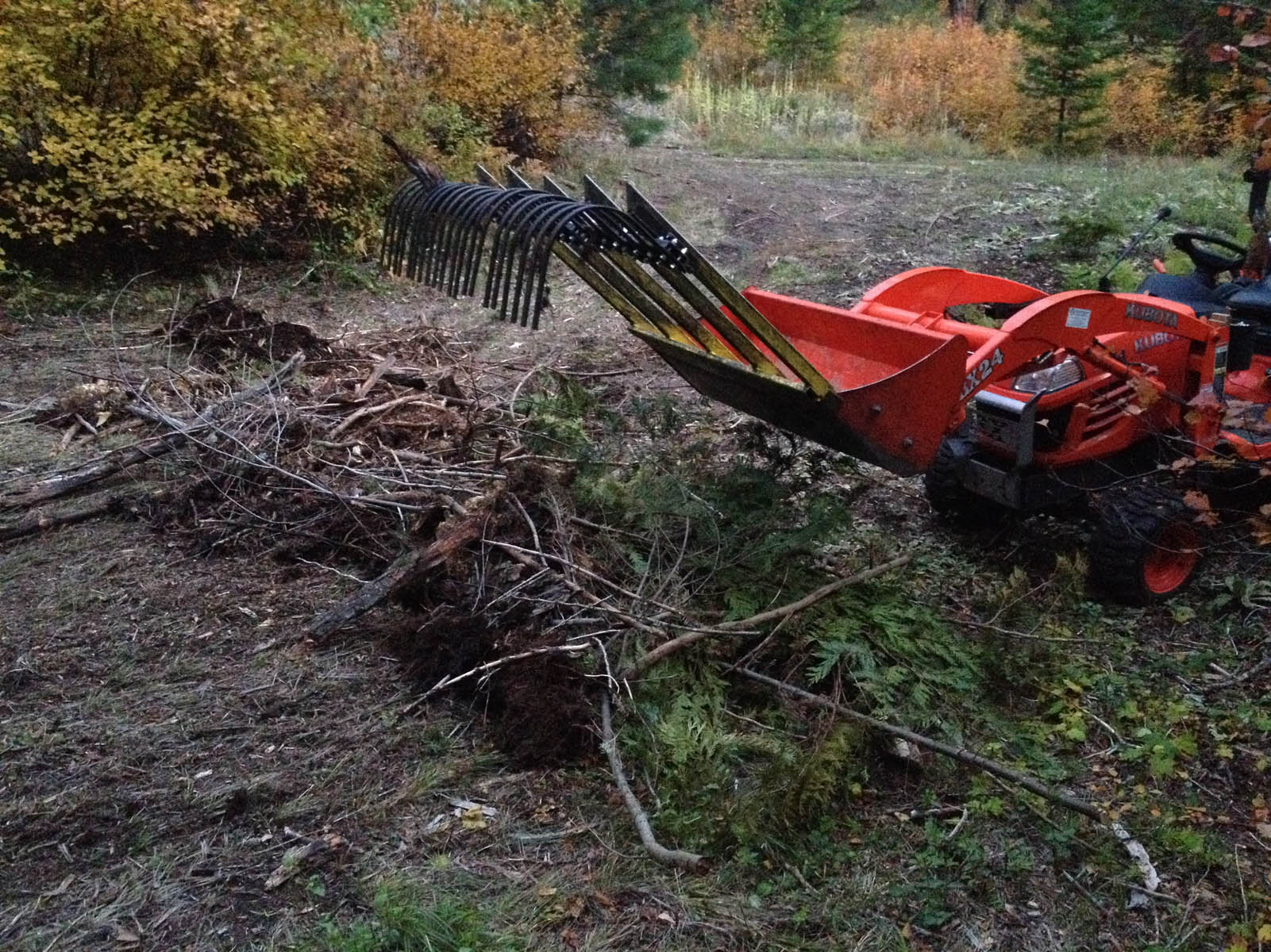

Until I have the money for a grapple bucket this is my thought.
?...I need to clear acres of loose brush after having an area cleared by a tree harvester. It was awesome to watch 90 foot trees being removed every 2-3 minutes. It is fast but leaves a mess behind. I have cleared areas before with a york rake but then you need to drive over the brush. This has cost me 2 hydraulic lines and a transmission filter.
The teeth should grab the brush and when I encounter a stump I will not be impaled by the steering wheel.
Thought?
My thoughts exactly!
Here's what I did to clean up old logging debris. It's mostly sticks laying in the grass, everywhere, Someplaces you can't barely walk because its no fun to walk on sticks, and no fun to pick them up by hand either. The grass growing thru them matts them to the ground. But with a tractor I can rake up big piles easily.
