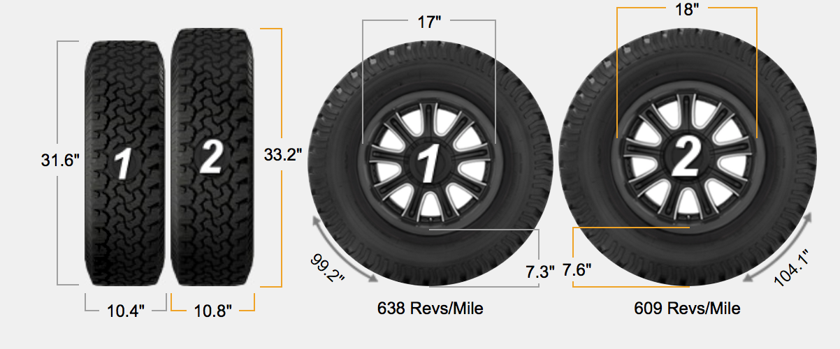

There is something to that. The third gens had the 48R trans. it had a 1st gear that was too high for proper towing and a 4th that was similar to what we have today. About .69 or so. The Aisin has a very low 1st that never strains for pulling power, sort of like a granny gear.
A significant difference is how the engine is tuned. The 5.9s, with a little tuning will pull from practically idle on up and do it aggressively. The 6.7 is so hobbled by its emission tuning that it needs to run a bit faster to build boost and to keep from downshifting.
The problem with the 3.42 gears is that 6th will not pull anything because it is running too slow to build boost. As soon as you want power, it has to downshift. High altitude or pulling a moderate trailer pretty much disables 6th gear. Even a head wind or the slightest grade. I have run for many hours in 5th and even 4th, just to keep it from hunting. The only time it felt, more or less OK, was at sea level and with no load in the truck and not towing.
Now, with the 4.10 gears, 6th becomes a useful gear. It will build boost and pull grades or pass if done with careful throttle use. Of course, mine is also deleted and mildly tuned.
Other differences that are nice are the more aggressive engine brake, lower gearing from a standstill that, under normal driving, makes the truck more peppy. The Aisin, which can't be tuned, likes the gearing better and shifts better. So, the bottom line is better drivability, better shifting, better braking and more useful gears, since 6th was mostly useless if doing any work. The noticeable seat-of-the-pants engine feel is that now, the top gear is between what 5th and 6th was before. 6th is a little higher than the old 5th was. With my 295/70r18 tires I'm right at 1800 RPM at 70. Cummins wants the engine running at a minimum of about 1800 while working and it will build about 26 PSI boost quickly if asked. I doubt any of this will have a bad affect on mileage because I was using 4th and 5th most of the time before.
Manufacturers tend to gear vehicles too high for my liking and I've geared down a number of times. Without fail, every one of those trucks drove better.
When comparing with the 3.73 gears in the 3rd gens, remember too, those trucks came with 265/70r17 tires. Now the stock tire is a 275/70r18 with about 29 revolutions less per mile. They put in higher gears and larger diameter tires for a big overall change in gearing.
