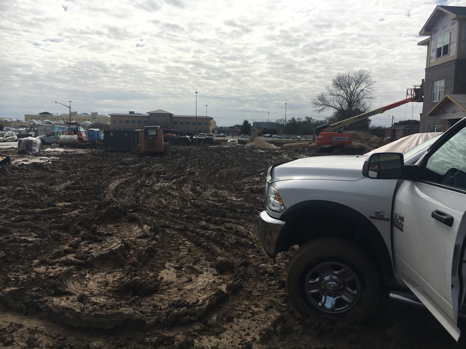

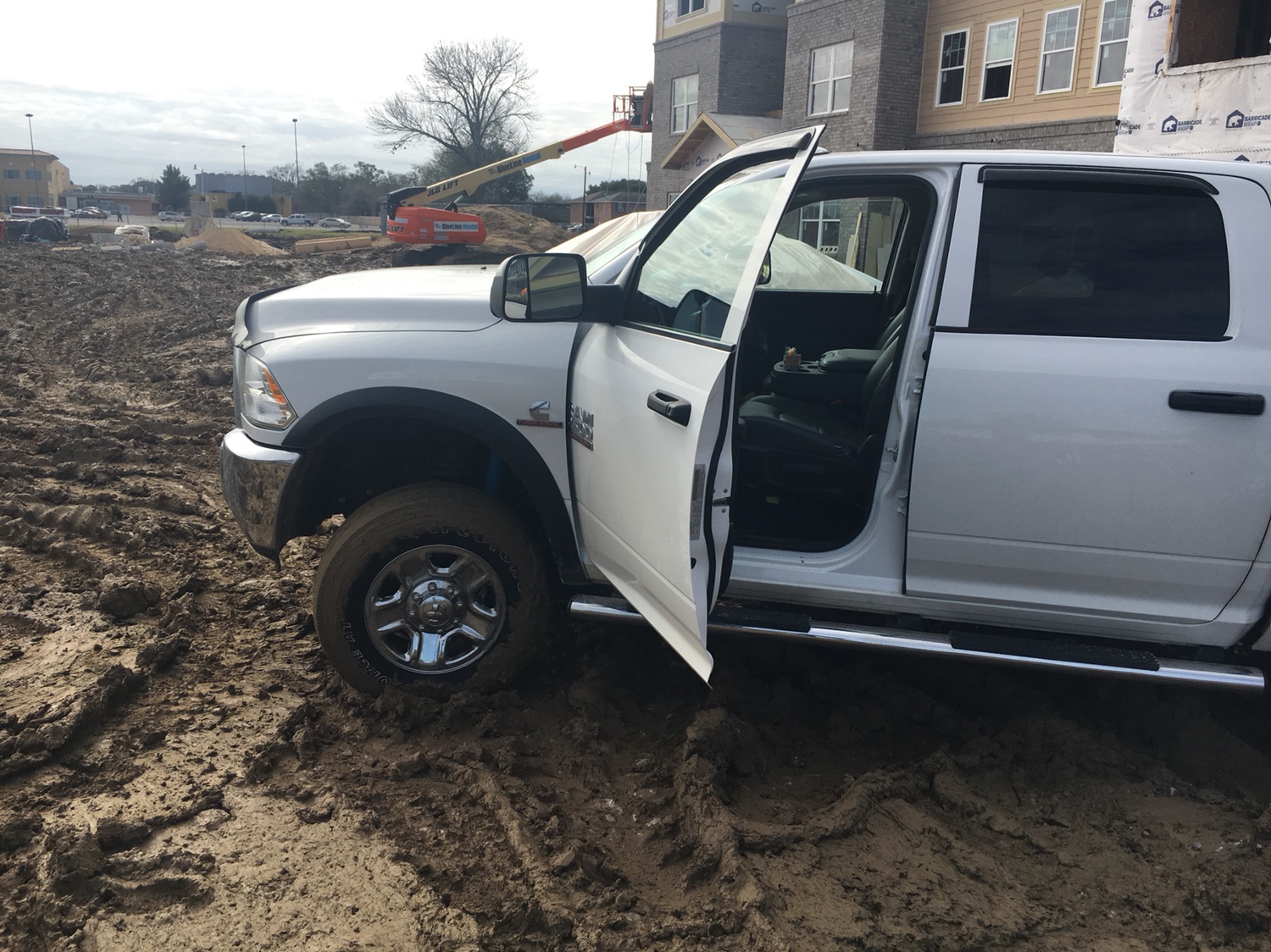

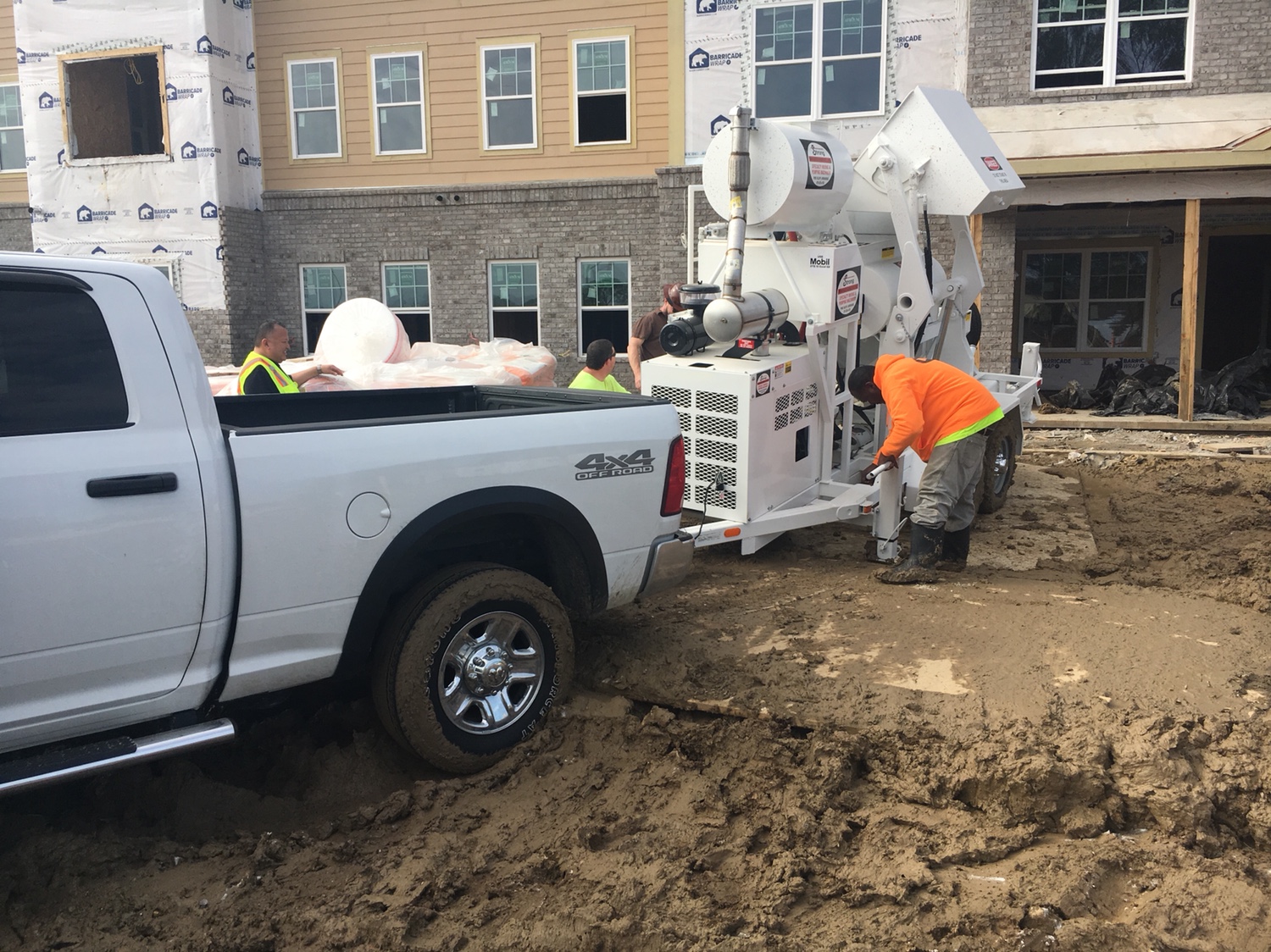

Just an update. Have put over 6k miles on it. Averaging 19 mpg hand calculated. Had one rough idle issue, no codes, cleared quickly. Began adding seafoam every few tanks or so. Tows well and the 4wd has been a life saver. Had to put a 10k lb pump in place on a muddy site today. Backed it in in 4 low, didn’t break a sweat. IMG_5947.JPGIMG_5949.JPGIMG_5948.JPG

I've found the low range just as important as the 4wd, especially with an automatic transmission when backing up. Makes it so much easier on the transmission.
