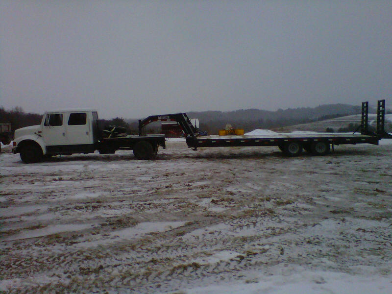

AN MDT is def not required to pull a 14.5k gn. I just happen to use it to pull it. The MDT is very well suited to pulling a 6 horse GN with a dual front tack that has the axles at the very rear of the trailer and fully loaded. My FIL won't even pull it with his duramax dually unless its empty and he doesn't like doing that. Too much pin weight. The international, however, eats its up and asks for more.
AS far as the tractor, no the trailer axles aren't overloaded because I can carry all the pin weight that trailer can throw at the truck. The 5083E specs out at around 7400lbs bare. 1600lbs of beet juice, 1700lbs for the loader 400lbs for the bucket. I leave the mx10 off because its to wide to transport hanging over the edges of the trailer(102" wide trailer, 11'6" mower). So we are right around 11,100 or 11,200 just for mud and chains or what not. Now the trailer weighs 5400lbs by its self. 11200 + 5400 =16600lbs If we take 25% off of that, we get 4150. SO, 16,600-4150=12450. hhmmmm that seems to be less than 14.5k? but maybe my math is off here???? Oh wait, 12450/2=6225/axle. HHmm that math checks out too. In all reality I put the bucket either all the way up against the front edge of the trailer or I put the bucket on the GN to try and get MORE pin weight for better traction. Seems my math works out there Brett. The truck rear axle is spec'd at 17klbs so I'm golden there too. There is night and day difference in the 1 ton light duty pickup and the MDT hauling that same load. I had a one ton SRW cummins that was only good for 23k combination. I was well over that with the gn and tractor and the pin weight was very heavy unless the tractor was placed exactly right. I have to keep checking my mirrors to make sure its back there and with the air ride, its smooth as can be.

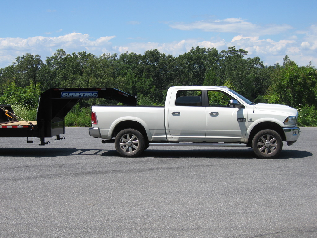

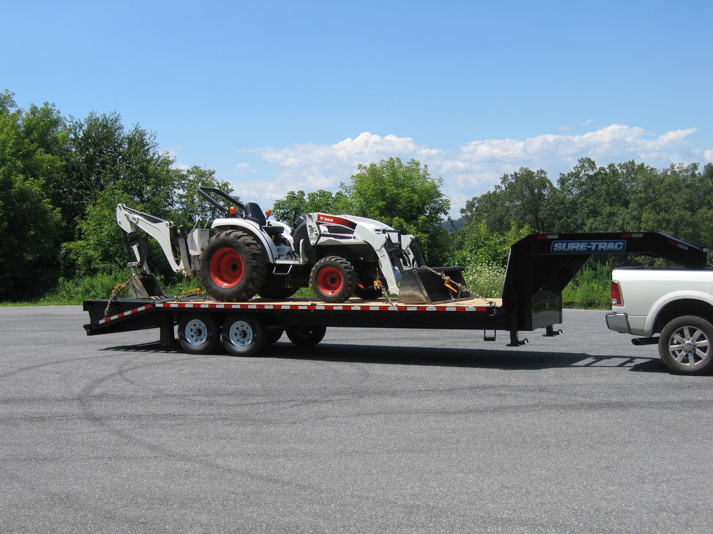

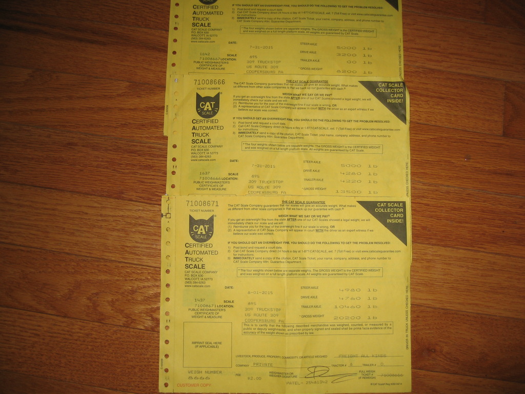

Okay Some pics of my truck with trailer. As you can see it does not squat to much. I also posted my weight tickets. 1-Truck, 2-Truck with trailer, 3-Truck trailer and machine. Can somebody tell me how to figure the pin weight out from these? thanks thanks
   / Ram 2500 vs 3500 Gooseneck? #28
take the rear axle weight of the empty truck in this case 3200lbs (from top ticket) and subtract it from the rear axle weight of the truck and trailer 4220 (middle ticket) you get 1020 lbs added that is the pin weight if the trailer weights 5240 lbs (add pin weight and trailer axle weight) you have 1020/5420 18.8%. the loaded trailer has a pin weight of 1560. or 1560/12020 = 13%
