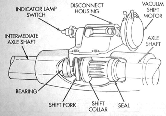

Not sure about the newer ones, but my '96 2500 with dana 60 is the same as the 1500's. There is a vacuum switch in the transfer case that engages a sliding "coupler" that disengages the right side axle shaft. Shoot, my '91 dakota with ifs had a very similar system... had to change the vacuum switch ($35 iirc) and it looked like the same part used on my ram.
I am almost sure that when they changed the trucks (2500-3500) to AAM axles and the manual or electrically shifted transfer case- (New Process 273) they got rid of unlocking front hubs altogether - so no hubs to fail and no (axle disconnect ) just a transfer case front drive line engaged or disengaged mode.

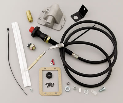

Yeah, the vacuum actuator on the axle is what I just had to buy online - cheapest was $70.00 US but I had to pay a bit more from another supplier that would ship to Canada. I think the CAD (Center Axle Disconnect) design is superior to the complex and expensive locking hubs. Your Dakota probably had a Dana 44 which is similar to the Dana 60. These are not exclusive to Dodge, but many brands, Ford, Chev, Jeep have used Dana axles over the years. I like the design as there seems to be less to go wrong. Either vacuum leaks or the shaft inside the actuator binds preventing the fork from moving the sliding collar to couple the center (intermediate) axle to the outer passenger-side axle. It takes about a half-hour to replace the $70 dollar vacuum actuator, assuming there aren't other problems elsewhere. Some people consider the vacuum system failure-prone, but I got 19 years out mine and in my case was not expensive to repair. There is however, a nice retrofit where you can convert this vacuum actuator motor to manual cable actuated (Posi-Lok). You engage the front axle manually from a pull cable in the cab. The nice added benefit is you can have 2wd LOW.

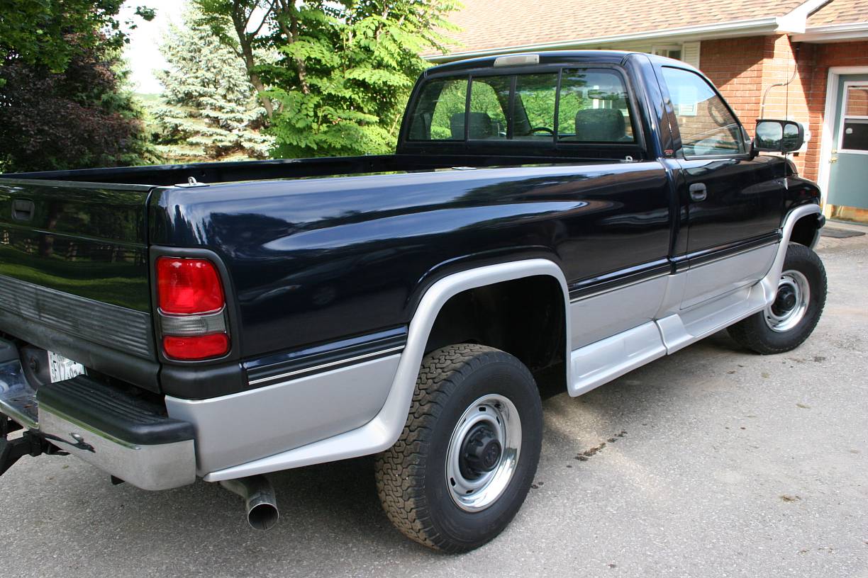

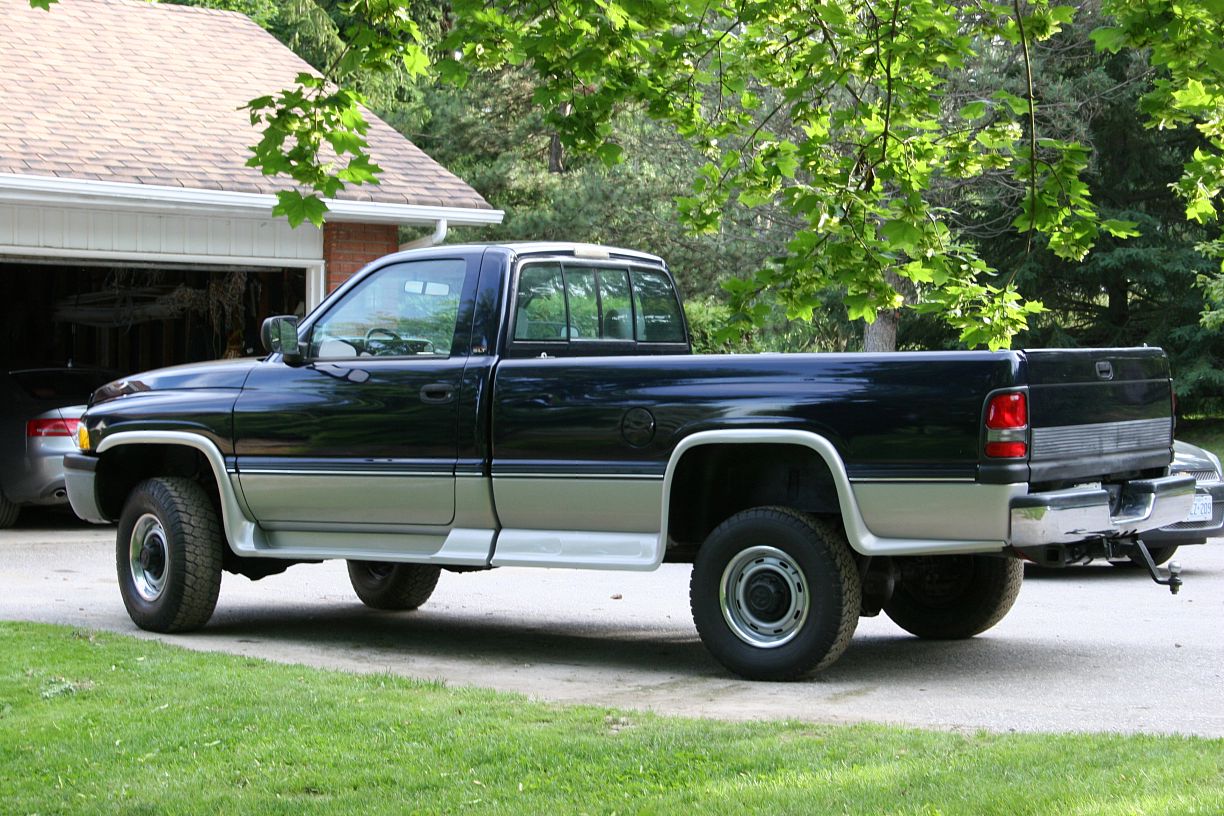

TRhats gotta be one of the nicest mid-'90s Rams I have seen :thumbsup:
Why thank you! :) I bought it new and the longer I keep it the happier I am that I resisted the urge to replace it over the years as the new diesels got progressively more complex, powerful (beyond my requirements), thirstier and arguably less reliable due to added emissions. Even this new Ram Eco Diesel has more horsepower! Instead, I decided to give the '95 a refresh as a far cheaper alternative to replacement. Complete new oem quality fenders, front and rear (not a patch job), paint and assorted other stuff such as all new brake lines, tailpipe, grille, headlamps, taillight assys, headliner, carpet, upholstery repair to driver's seat etc. It's like a new truck again! Still original clutch, about 250K kilometres on it now. Can you consider keeping an older vehicle as eco-friendly too? Saved building one less new truck! :D
