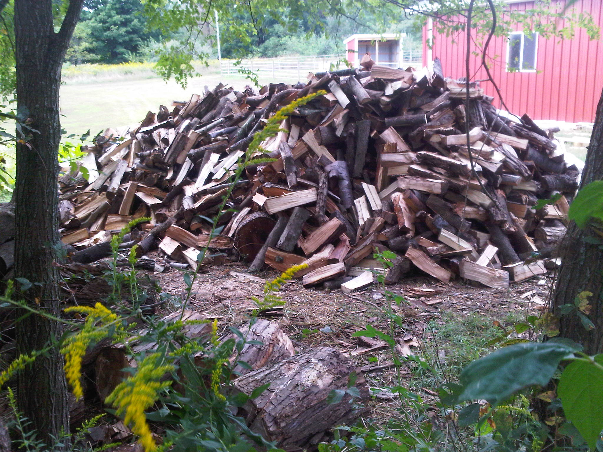

A couple weeks and a couple cords later. All is good.
