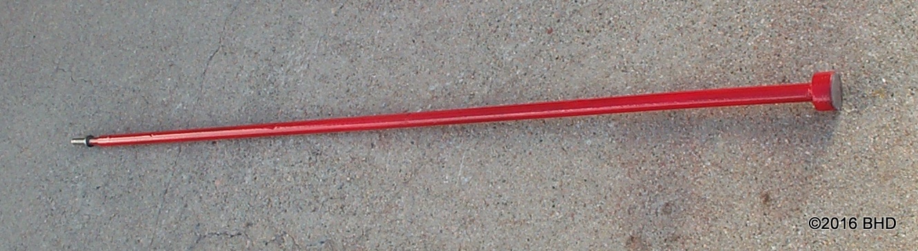

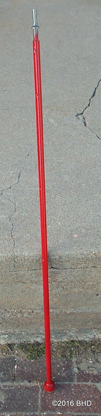

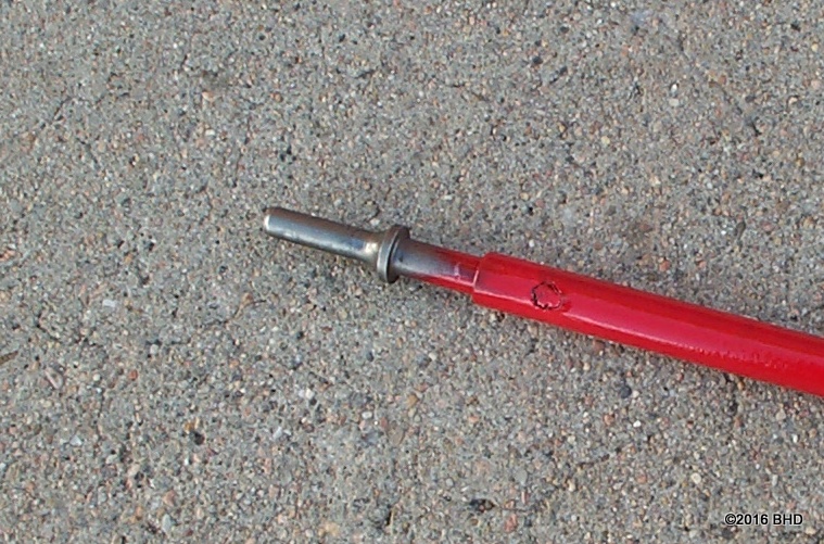

this is what I came up with for the time being. or my first try, I may try the Rohrer ponder, but it is not light either, I was wanting some thing that was light and easy to move and lift up and re positon, the tamper,
so I was thinking about an air hammer, (have seen the air floor scrapers, but figured if I would put one of them in a hole with a altered end on it the dirt would kill in short order,
so I went to the shop and found a old air chisel, and some bits, one was a center punch type bit,
it nearly fit in side a 3/8" pipe, loosely, and then took a 7/16" rod and ran up in the pipe and drilled the end with a center drill so the punch would work on it, and then, cut a 1 1/2" shaft off about 1" long and drilled it so the pipe would fit in it, and then drilled holes to plug weld the rod in place, and the punch. I used 7018
I know in past experience, welding on chisels is not very successful,
so is there a way of doing it where it will hold, in about 2 mins, of use the plug weld is loose, it is entrapping the chisel, the picture with chisel end,
is there a way of welding the chisel, so it will hold,
Or should I just, turn out a regular shaft to the shape of the chisel and put in, but then I am concerned it will mushroom out and not last either,
I do not know if this will work reliability but I wanted to try.

I have a larger air hammer (chipping hammer), that I tried to make a rod driver with as well, for driving in the 1/2" and 3/8" rebar electric fence posts in to frozen ground, and had mulipital pieces in short order as well. I was able to find a rod driver for the air hammer, and use that now, with it, it is a air hog, but the larger hammer drives the post so fast that even a small tanked compressor keeps up as it take time to move to the next post, I lay the hammer on the bed of the truck and slip the post in ot it and then tilt the unit up and the post in place in the ground and one short burst it is driven,
the "tamper" I made is light just a few pounds, and was concerned about the inertia of the heaver rod or extension, to tamp with, I tested it in the drive way which is well packed all ready and it would drive the head of the tamper down in the drive way about 2 to 3 inches in a few seconds,
my digger is about a 9" auger, and the posts are 6 5/8" around so there little room,
my hand tamper is a piece of 3/4 pipe with a solid shaft welded on one end and a small section of 2" on the the other end to pre compact it some.
but on these steel pipe posts I am using there is not much room, so even if I could afford it, the commercial tamper would most likely not fit most of the time,

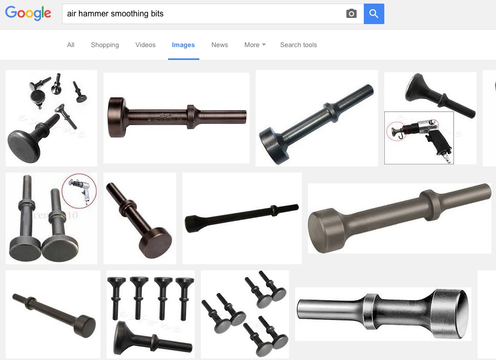

I think you caught the right idea, but by the wrong end. :)
Buy a smoothing bit for your air hammer.
Attach it to an in-line air hammer with a 3 to 4ft long handle, or modify a pistol grip air hammer and add a long handle. The goal is to have the hammer down in the hole, with a short bit and a long handle.
