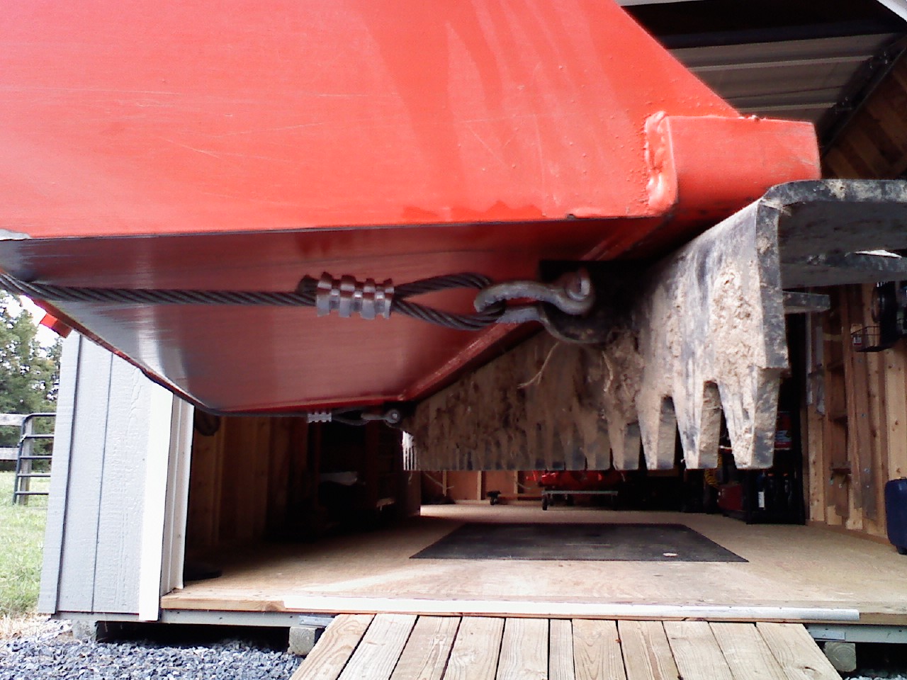

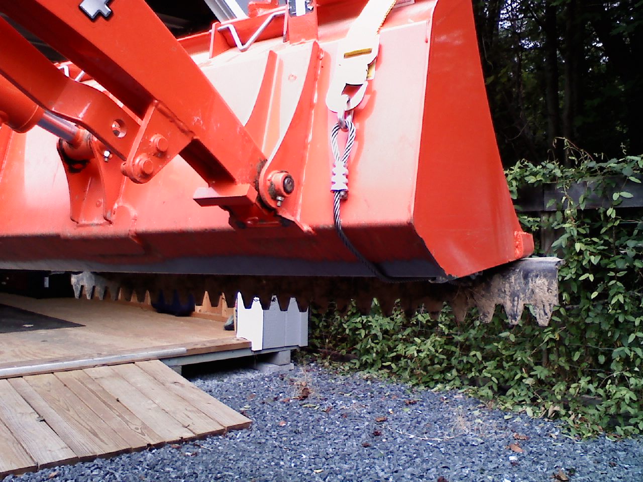

For anyone interested in the ratchet rake, here are a few pictures I took today using their new steel cables to mount the rake. Nice improvement over the straps touching the ground (if you back drag with the heal of the bucket with the rake attached).

Thanks. Had planned on ordering these but had read where I needed to measure bucket before ordering. Haven't gotten to measuring my 60" Kubota bucket on a BX2660 yet. Figured they would already know that since it's what they do is sell bucket attachments. Looks like you use your old strap so measurement of bucket doesn't look like it's needed/critical measurement. May call now and see if I have to go measure my bucket before ordering.
