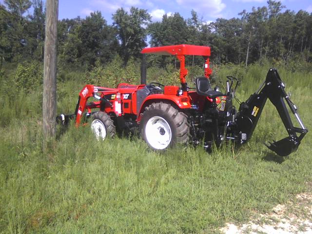

I got my 72" RR two months before I got my tractor and that was just a incentive to make sure my wife made me get a tractor. Would send potos if I can figure out how to do it again.

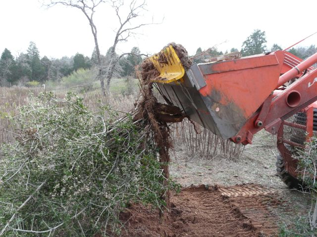

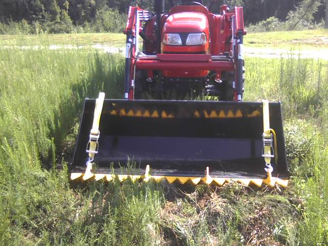

I bought my hd 72" round back Kubota bucket new 10 years ago. Does yours look like this?
(note: picture shown is strap/cable not FS connectors)
I also included a photo of the busted cable - the reason why I suggested going with the chained FS connectors.
My chain measurement for the FS connectors - 55" each.
My FS connectors arrived promptly from RR, however I have not used it yet - working on other projects-
