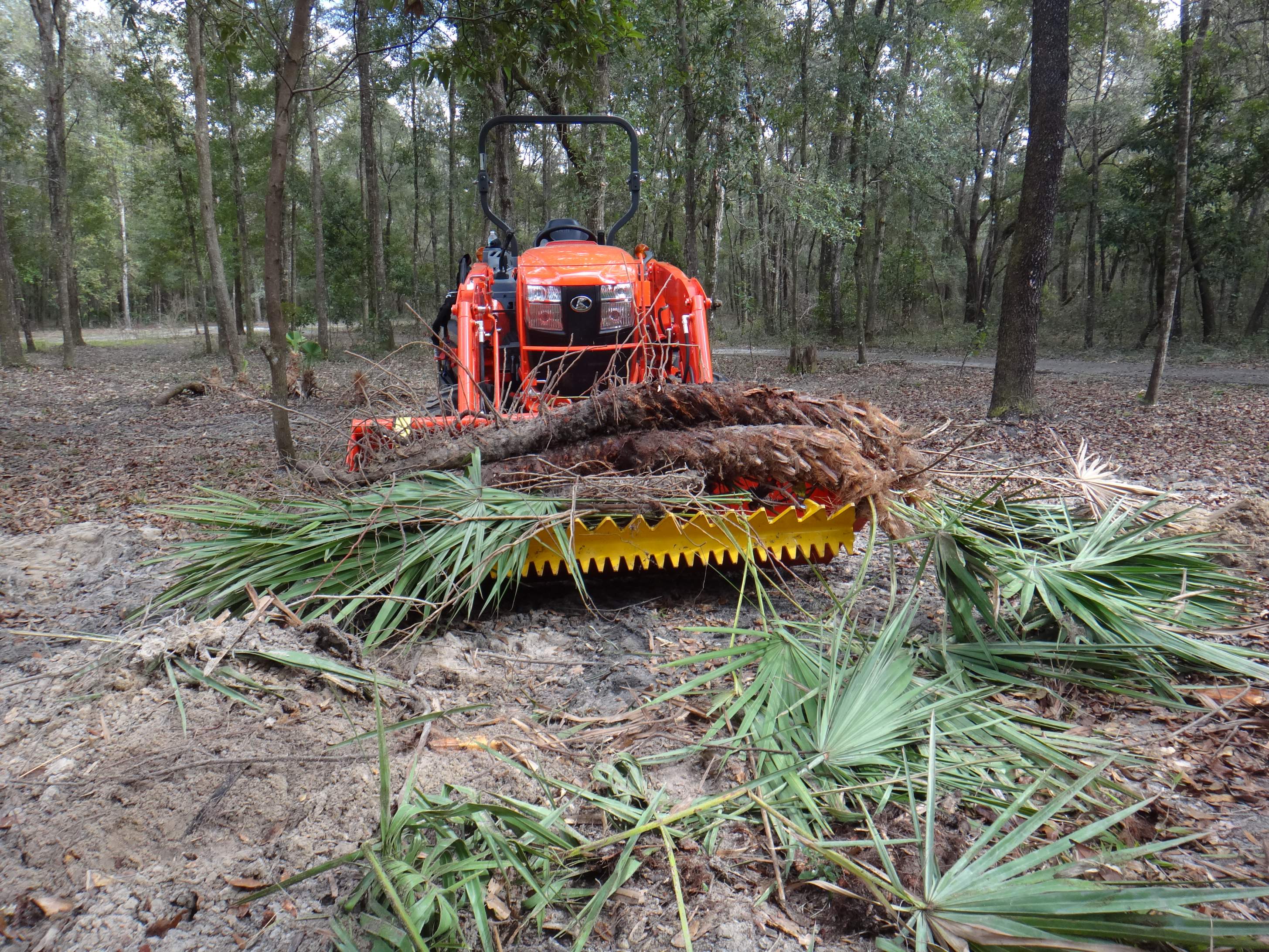

Previously I had a Kubota B3300SU tractor/loader package which used 52" Ratchet Rake. Worked well.
Now I have heavier Kubota L3560 with optional (L2296) 397 pound, Heavy Duty, Round-Back Bucket and 88 pound, 68" Ratchet Rake; heavier, works better.

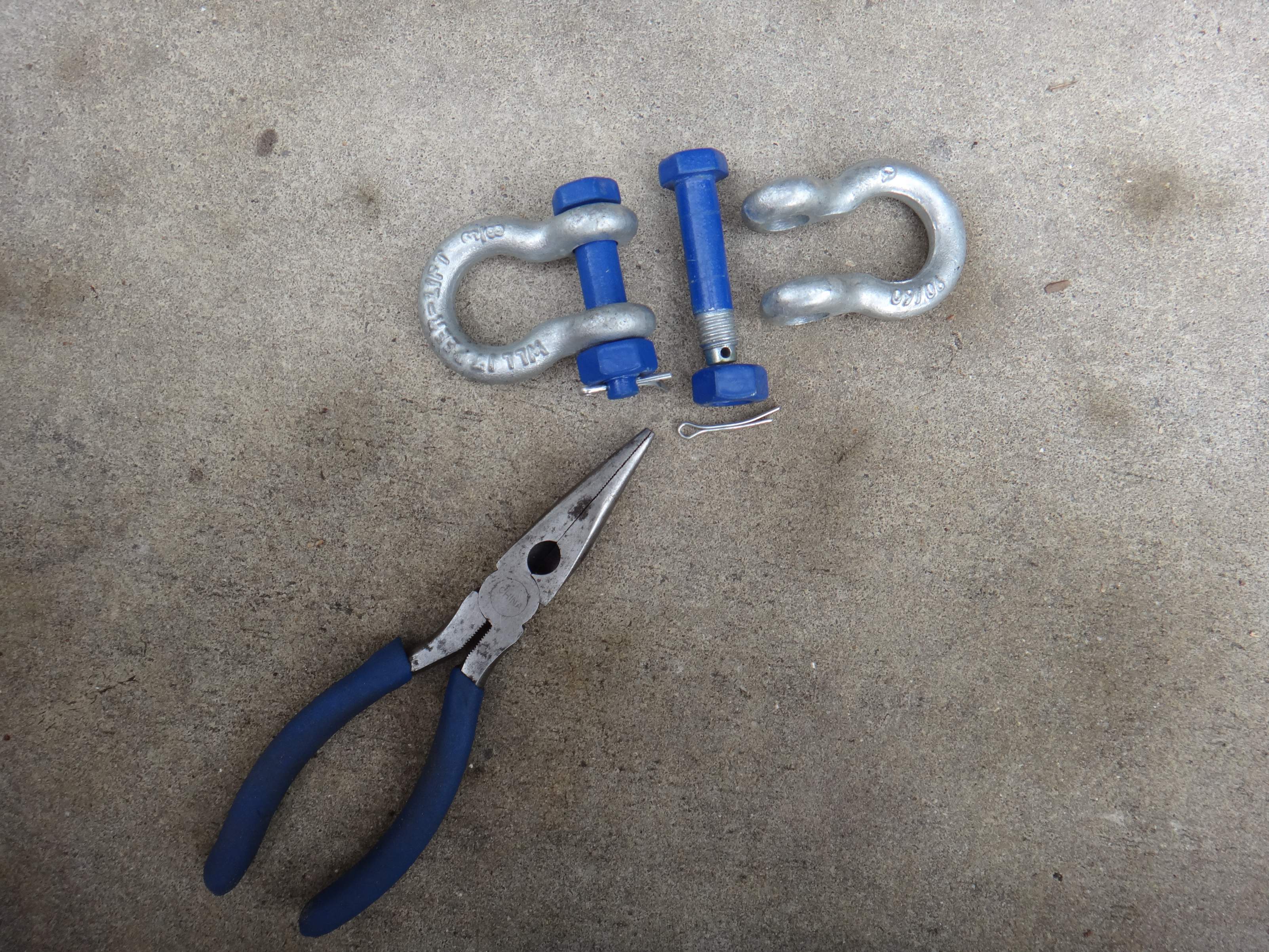

I had issues with cable attachment shackle pins unscrewing, despite application of Loc-Tite, on two occasions. I found nutted and pinned clevis shackles on eBay @ $2.99, which resolved the problem. RR, LLC should make some type of secure shackle standard. Downtime is the field is expensive.

Great tool. Effective tearing out tenacious Palmettos.
NUTTED/PINNED 3/8" SHACKLE LINK:
3 8" Shackle Clevis Safety Pin Peerless 1 Ton WWL | eBay

Pads are gone, if I ever had them. Don't need or use anything.
I've had the bigger RR for L3240 and the smaller one now for Bs and BXs and never had an issue with losing or unhooking of attach points. Will look and see if they may be loosening up after all these years of frequent use.
