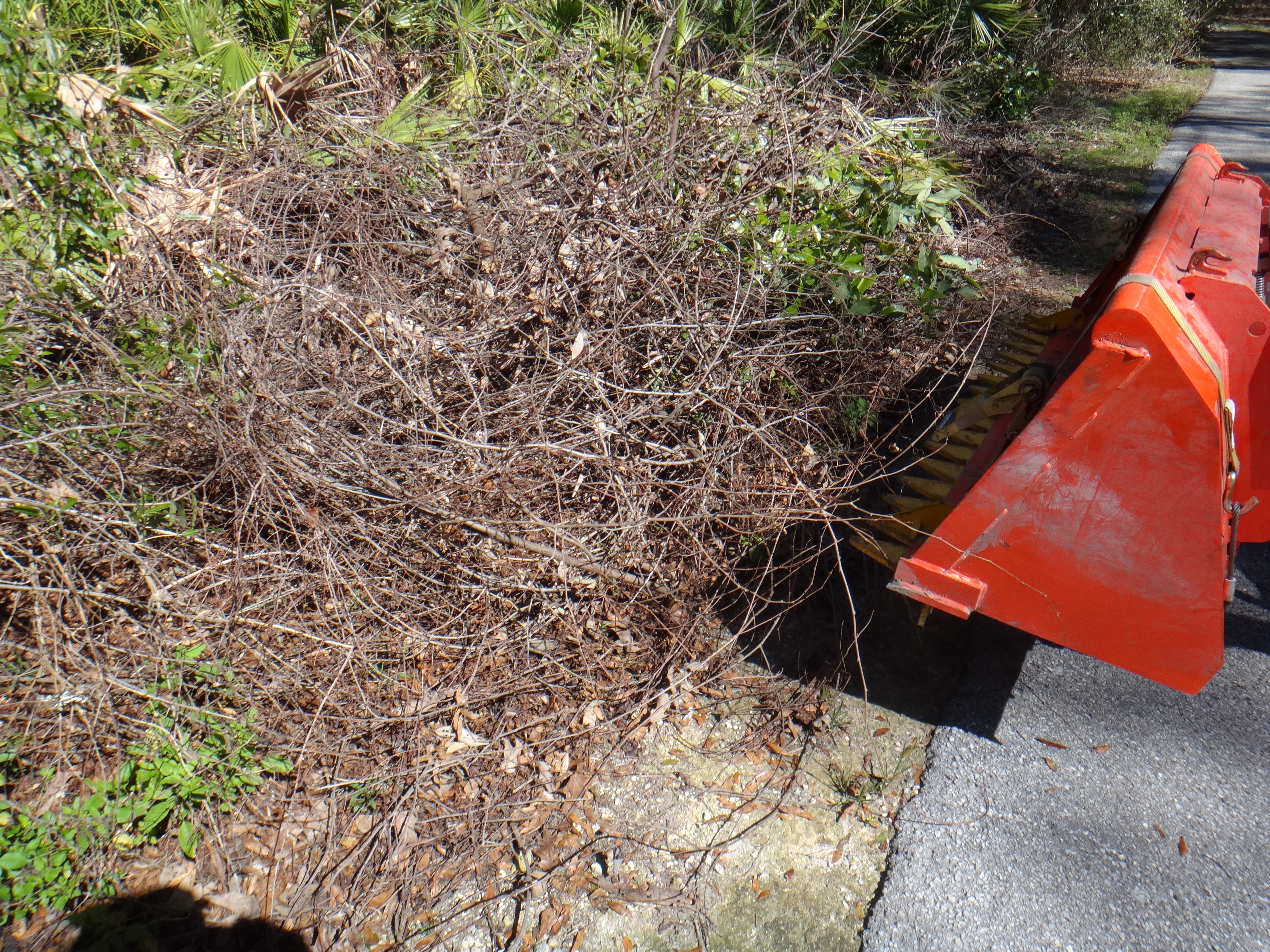

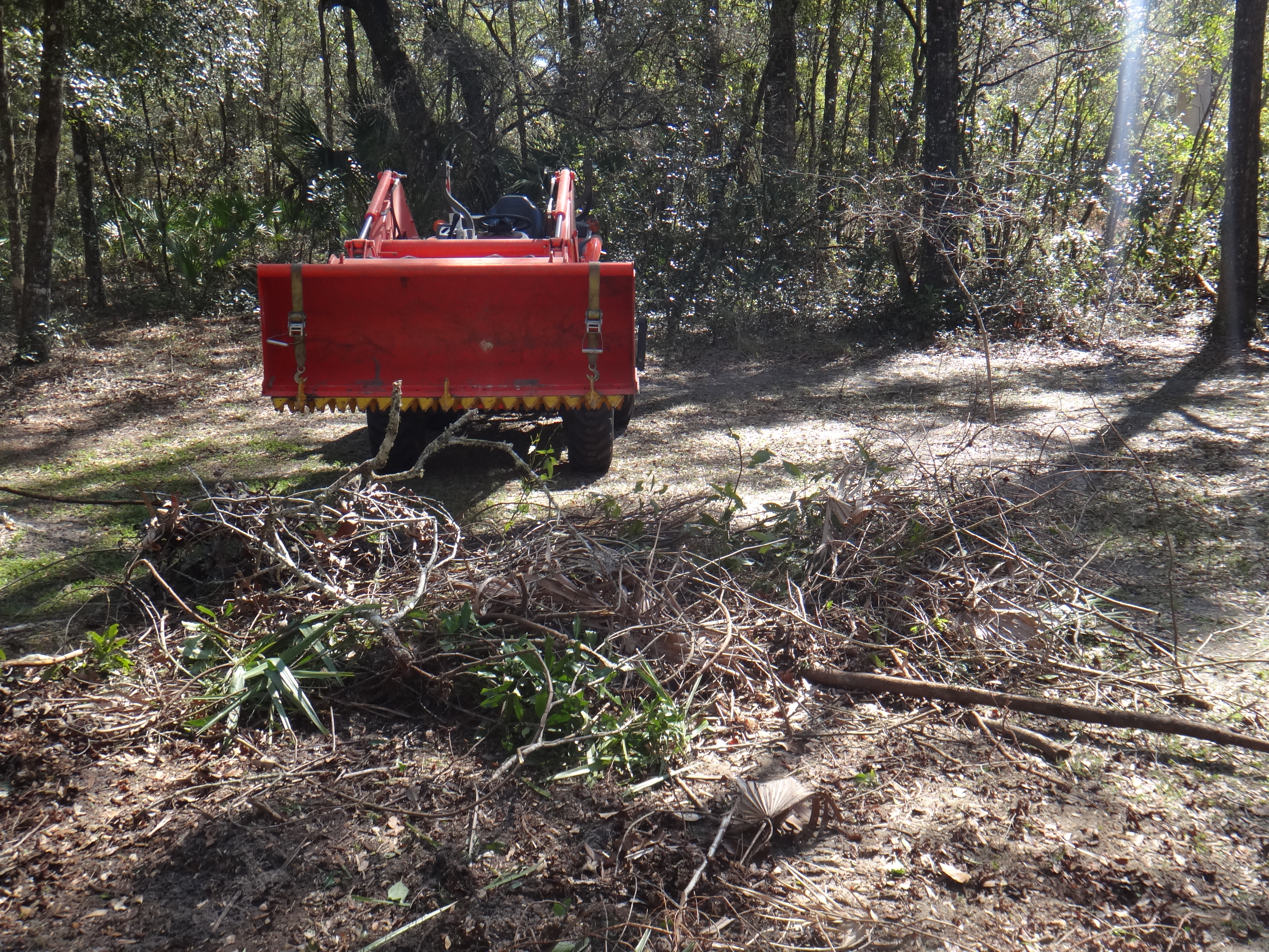

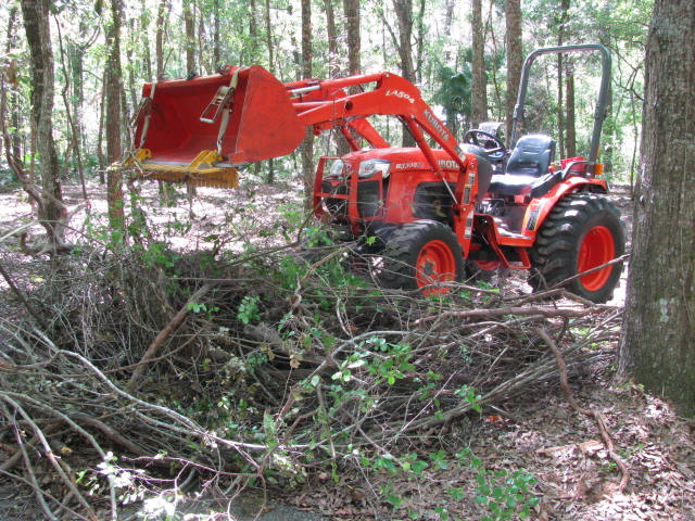

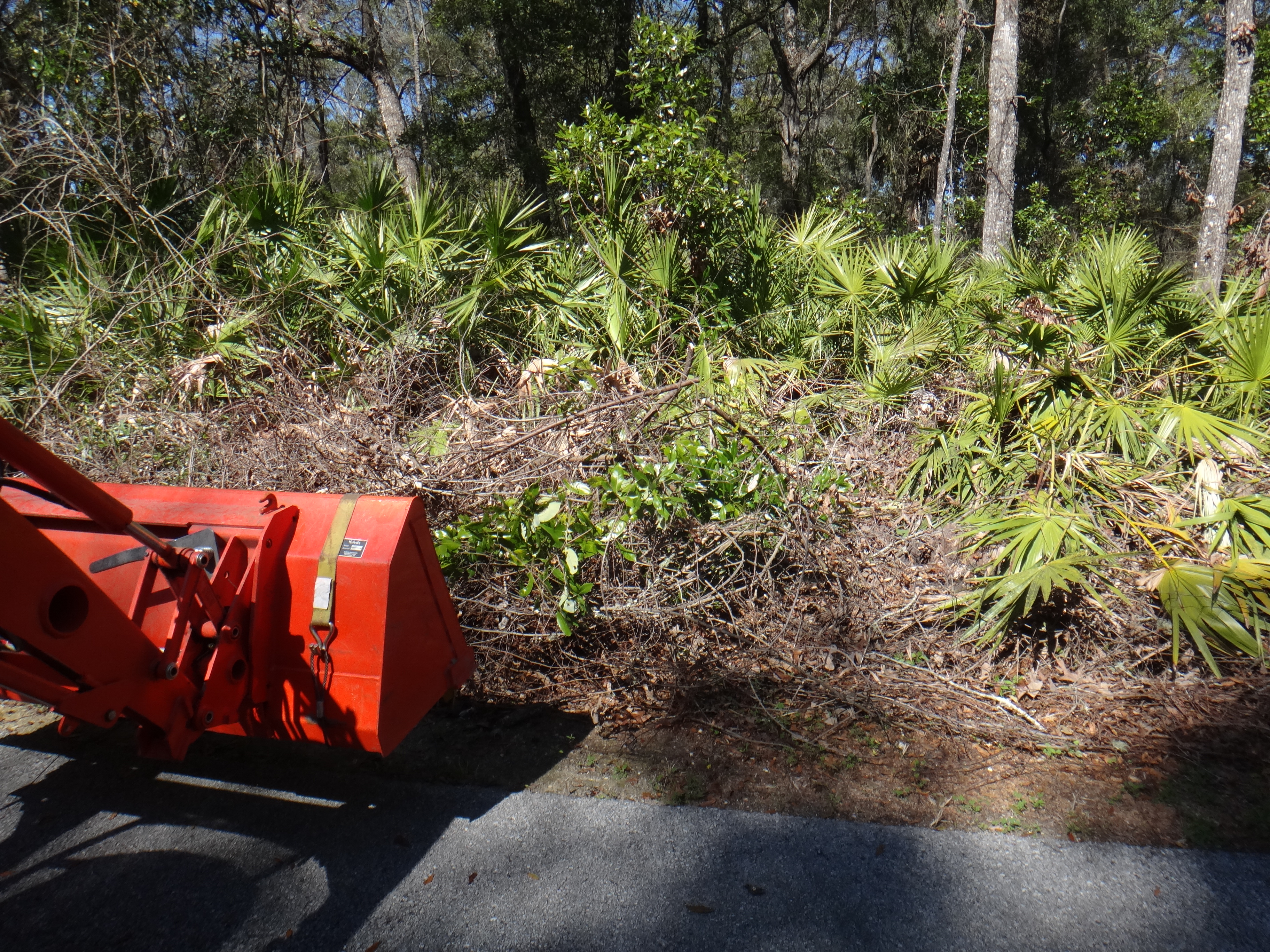

I had a snarled mass of wild grape vines and brush near a gate. Decided I should clear it today, before everything emerged from dormancy.
Photo #1 Ratchet Rake on bucket. Downward oriented teeth make this attachment excellent for pulling brush and light grading, but you cannot dig a hole with a Ratchet Rake attached to your bucket.
Photo #2 "Before" Note Ratchet Strap tensioning Ratchet Rake against FEL bucket lip.
Photo #3 Another "Before" photo.
Photo #4 Technique I used today was to grab the vines and brush with the downward facing teeth, then pull them out with the tractor in reverse. Then lift the bucket to drop debris. Drive over debris to take another bite.

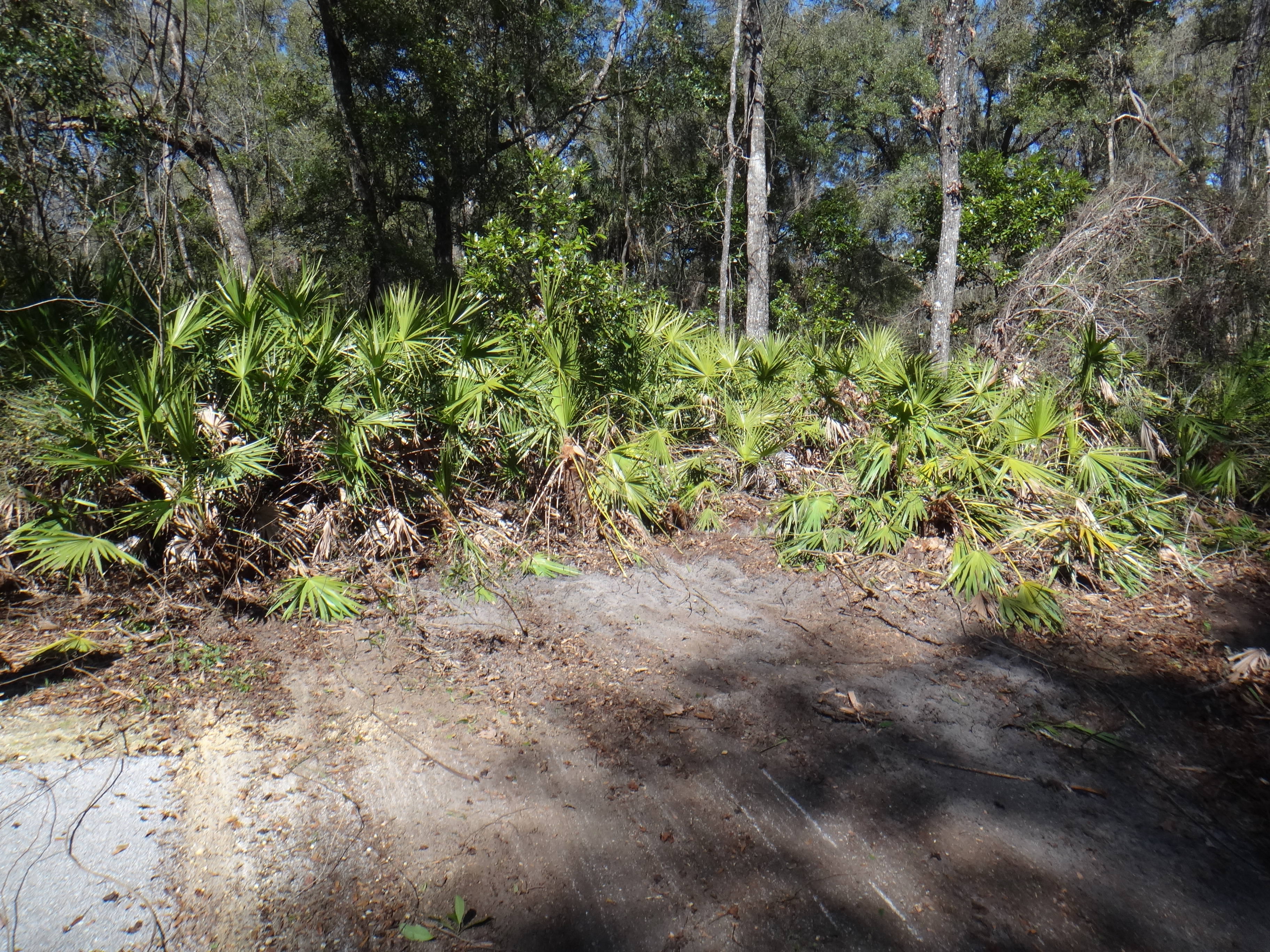

Photo #5 "After" I will let weather settle the dirt for a week or two, then excavate the Palmettos with a Bucket Solutions' Bucket Spade FEL bucket attachment. Finally, I will add fill and smooth.

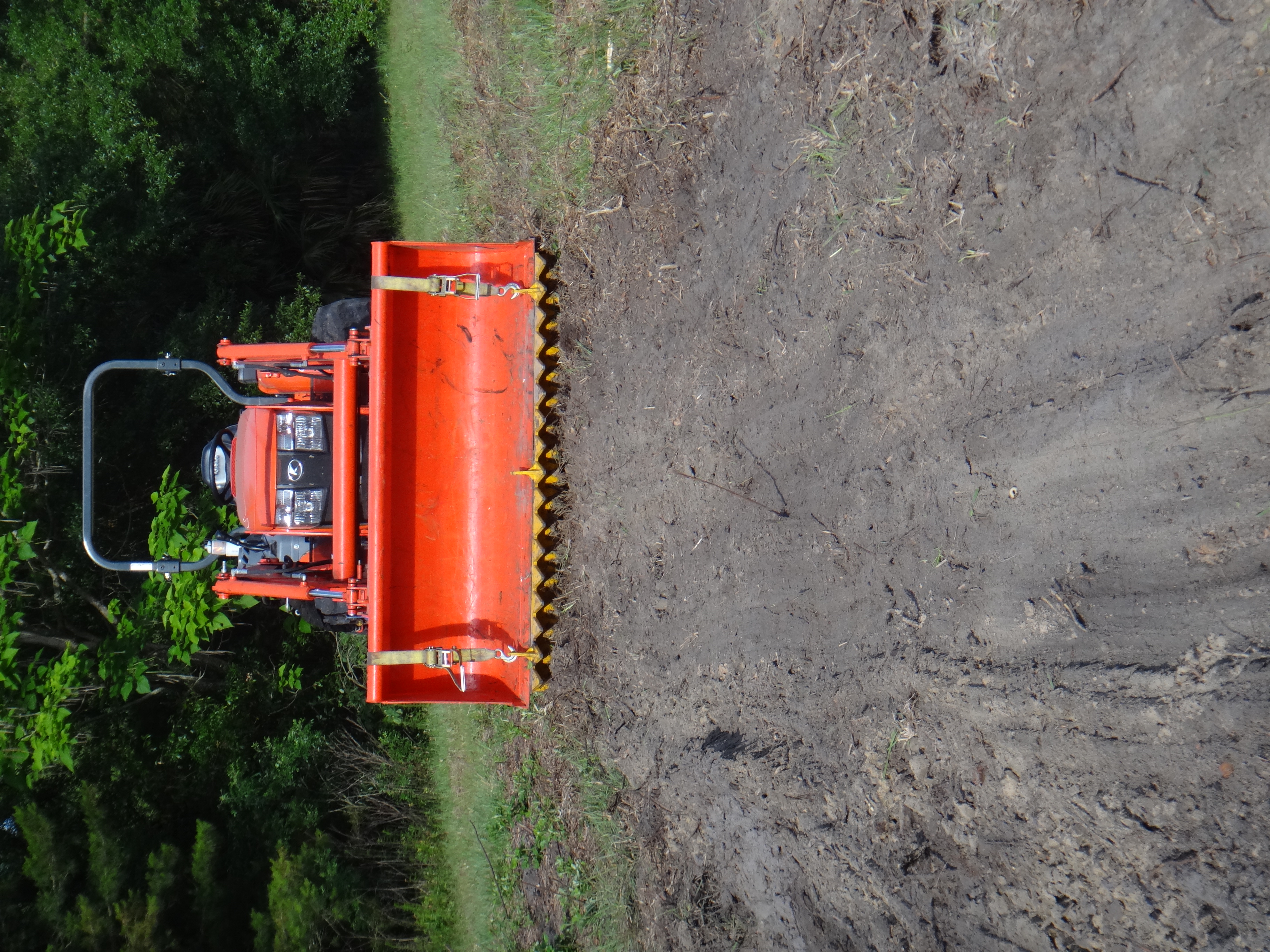

Photo #6 Ratchet Rake spreading fill dirt.

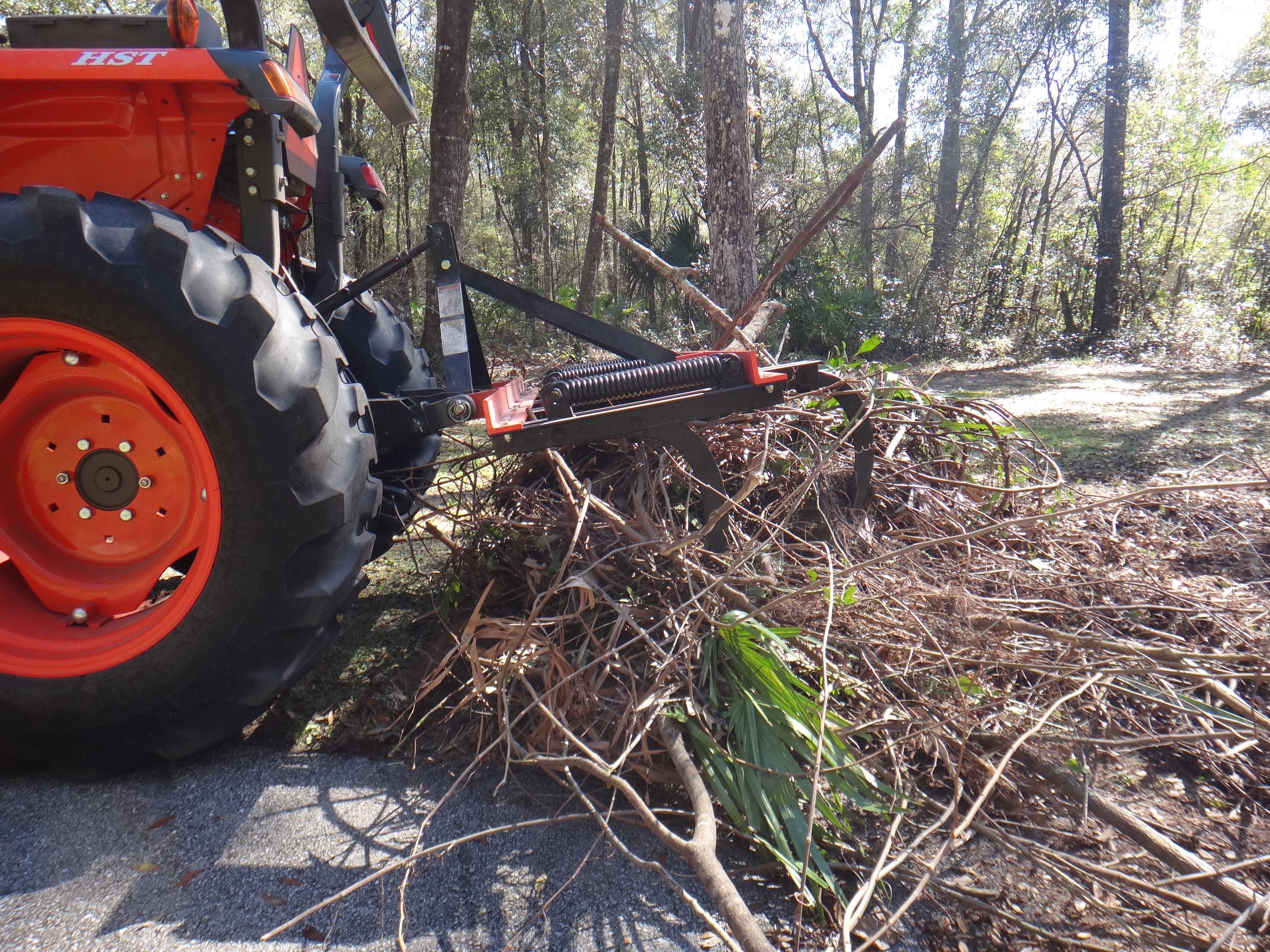

Photo #7 + Photo #8 I had my seven tine Dirt Dog "All Purpose Plow" AKA Field Cultivator on the Three Point Hitch.
Photo #9 + Photo #10 Used DD Field Cultivator to pull 500 pounds of removed detritus to the burn pile. Very little of the load lost, though it was a 1/4 mile pull over an asphalt road to the burn pile. Probably as effective as a grapple for transporting tangled detritus. I never got off the tractor.

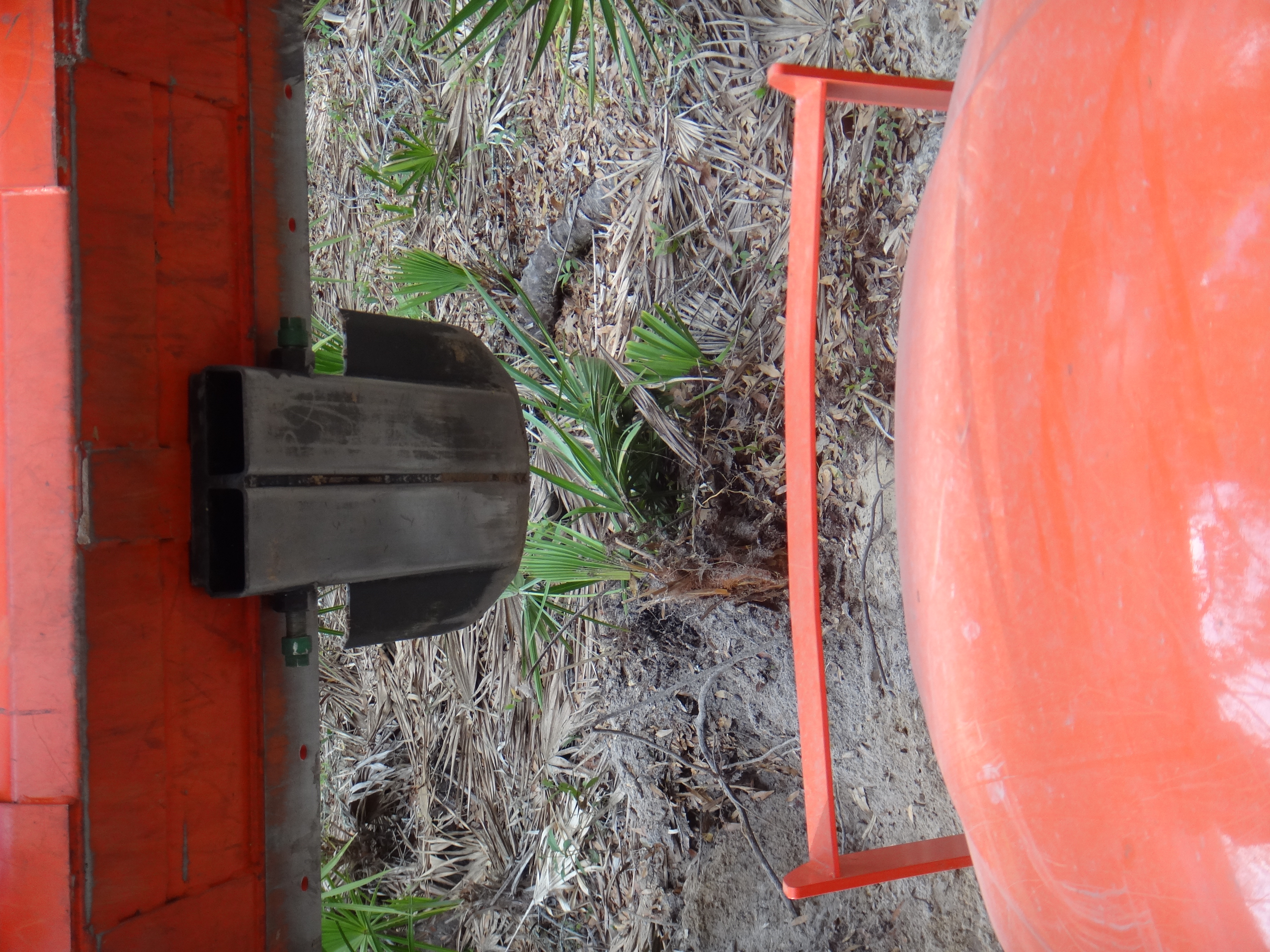

Photo #11 Bucket Spade on Kubota B3300SU.

Good luck with removing palmettos with the shovel bucket attachment. They are a force to be reckoned with.
/ Ratchet Rake // Today
I have excavated over 1,000 Palmettos with the Bucket Spade. Occasionally Palmettos four layers deep. It is usually a two or three stab job. Sometimes up to six stabs.
I have Kubota's optional L2296 Heavy Duty, Round-Back bucket, which is a rigid base for the Bucket Spade.

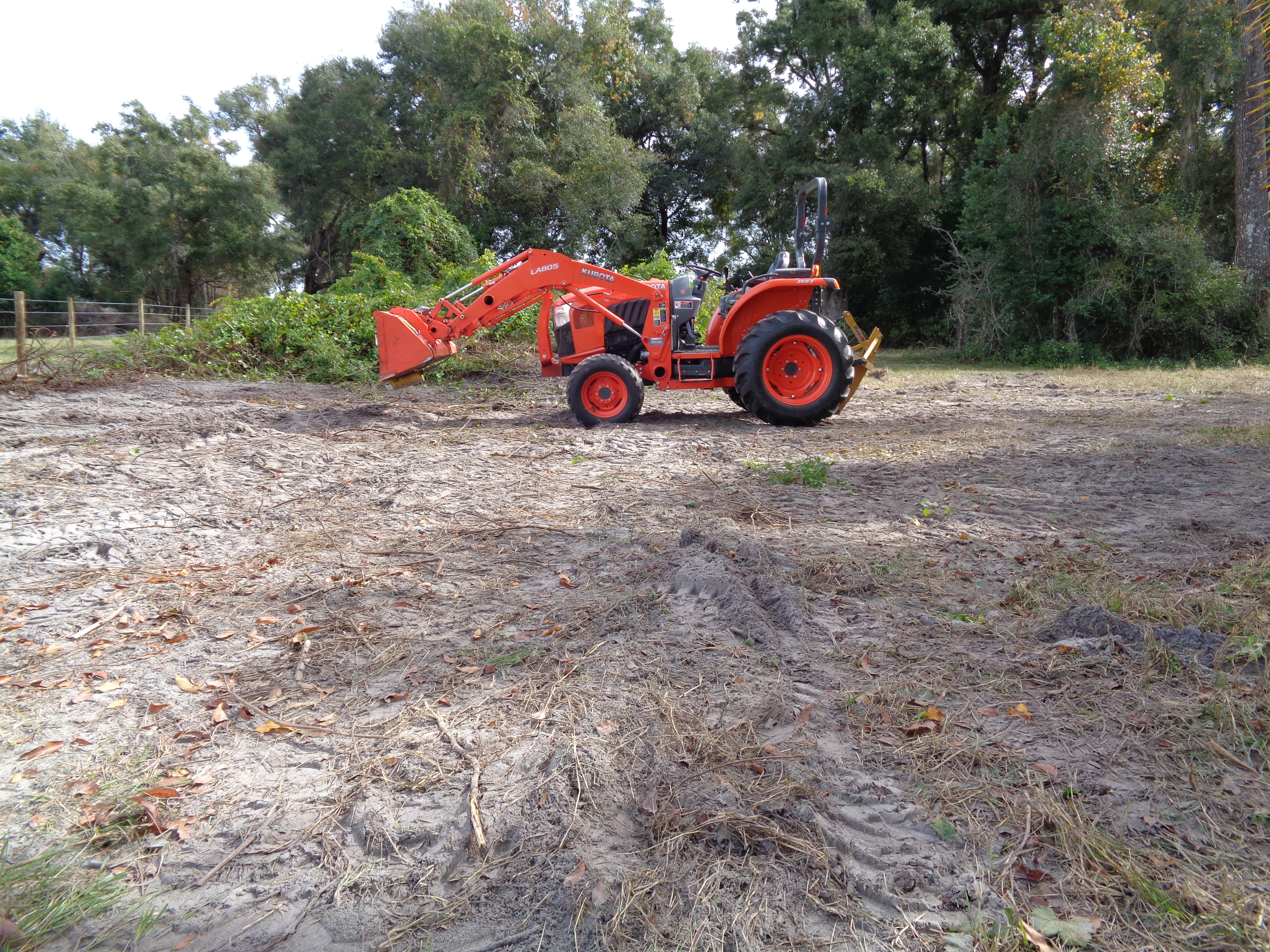

I've been looking at one of these and figured it would be much more useful than a landscape rake for what I want.
Yes you can. Either with both set of teeth engaging the ground or, alternately, with just the short, lower teeth engaging the ground.
A Ratchet Rake is better than a Landscape Rake for piling brush. When piling brush with a Ratchet Rake you usually operate the tractor in reverse, pulling the brush into a pile.
Expand on the precise task you wish to accomplish ~~~~~

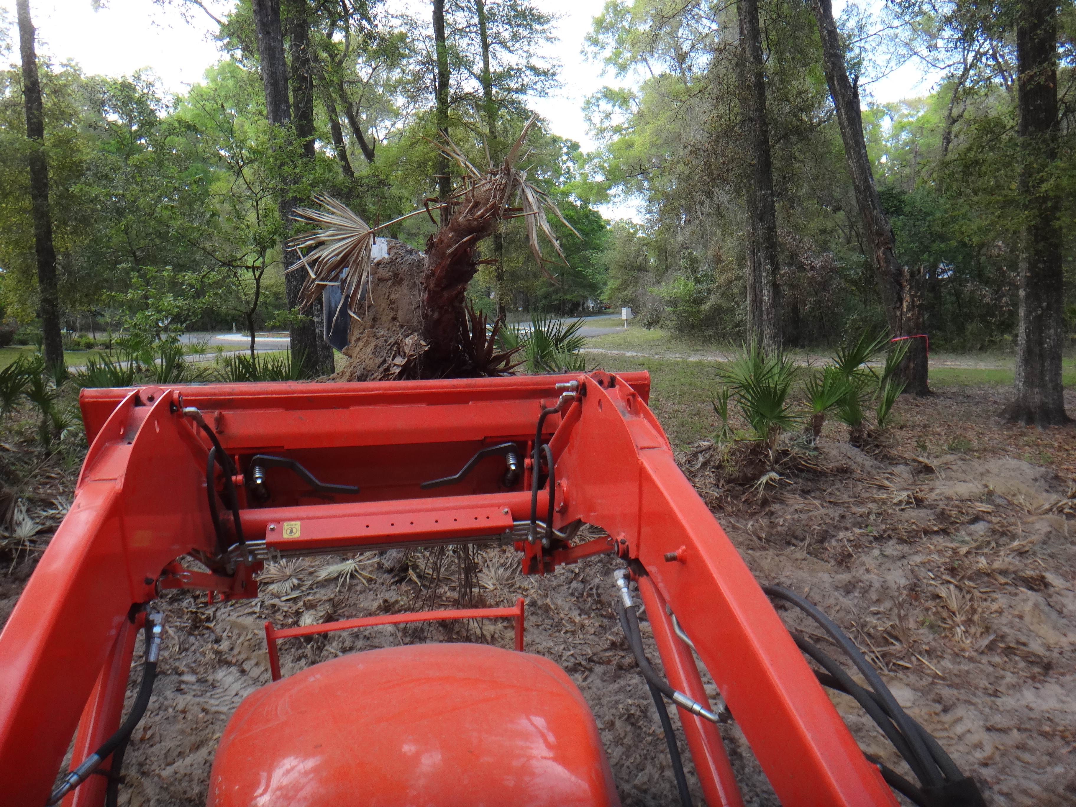

Recent photos.

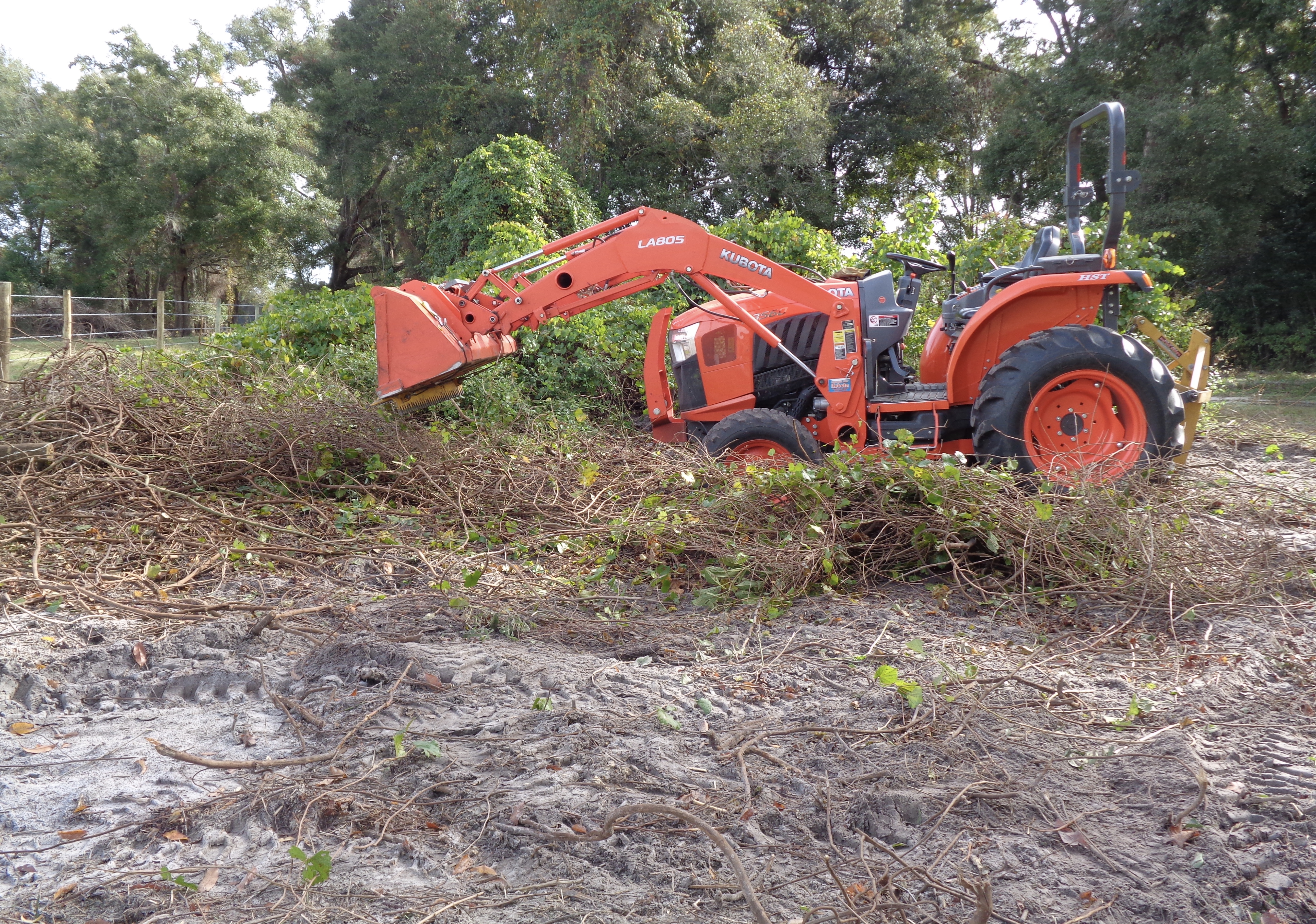

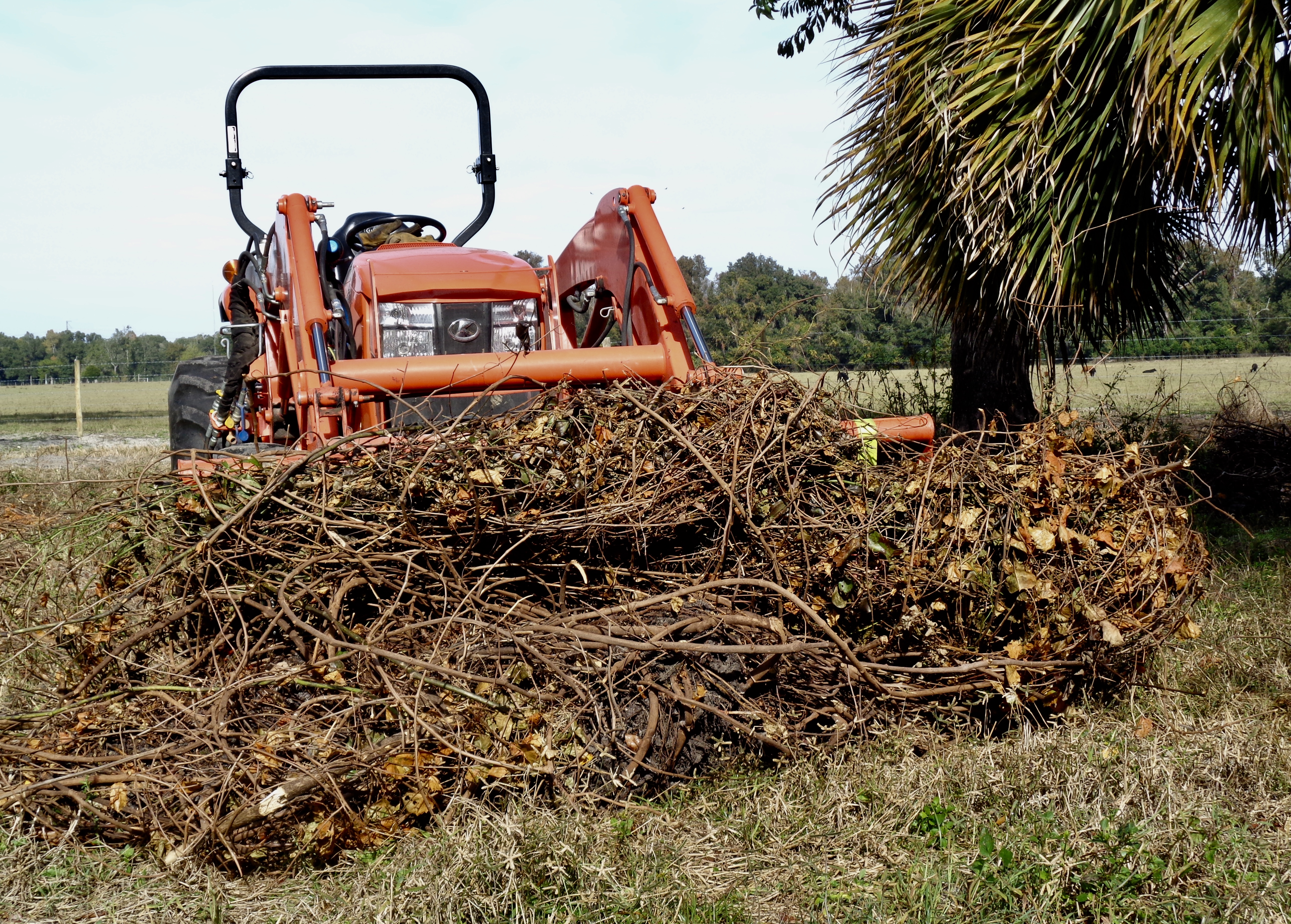

Decided to clear a mass of wild grape vines from an overgrown fence row yesterday. PHOTO #1
I attached the Ratchet Rake to the bucket and mounted my EA Subsoiler to the tractor's Three Point Hitch.
Pulled out a 1-1/2 tons of vines in an hour.
The Subsoiler was useful in pulling/loosening grape vines below soil grade.
Ratchet Rake gripped vines above ground and pulled surface material plus considerable loosened roots.
Ratchet Rake is a first rate tool for consolidating debris. PHOTO #2

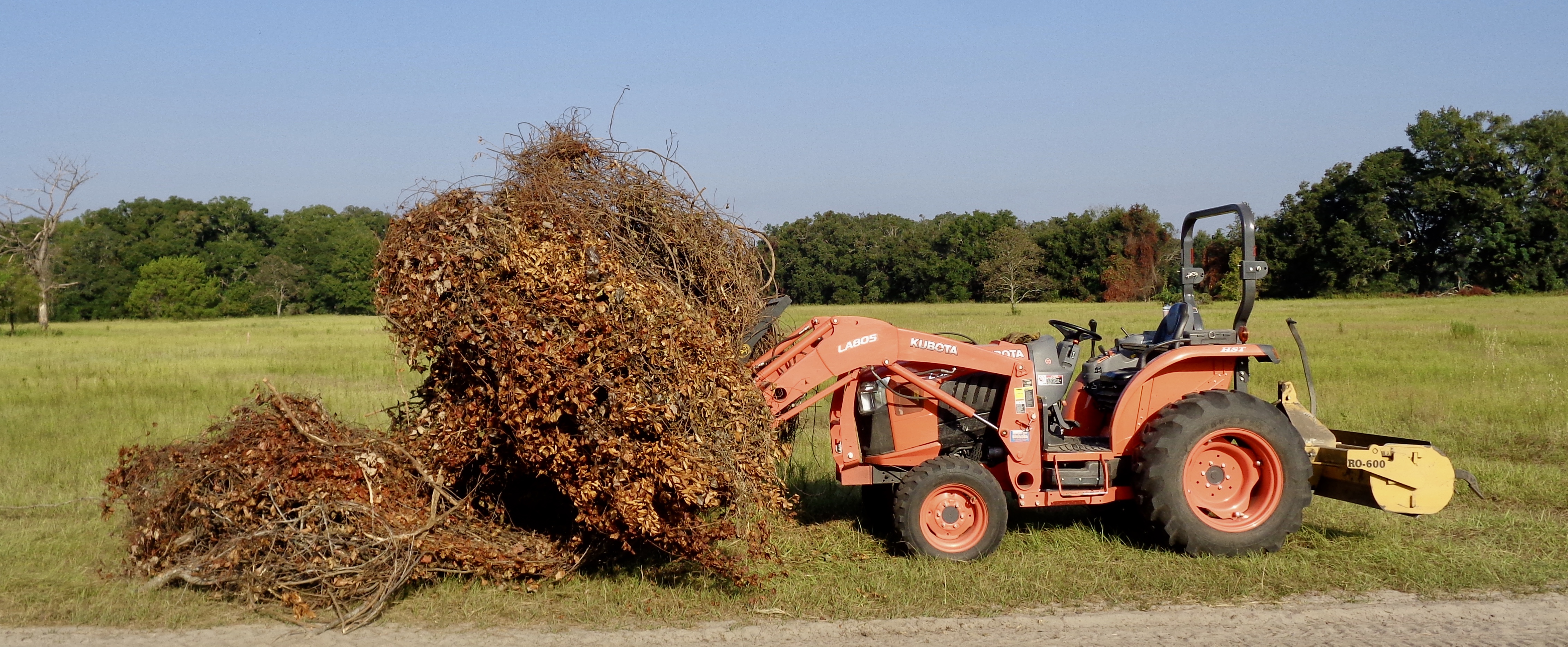

Green debris is piled against a tree as a backstop, so pallet forks can be fully loaded. PHOTO #3
I will have my 650 pound Box Blade mounted as counterbalance when carrying dried vine debris 1/3 mile to the burn pit. PHOTO #5 not taken yesterday.
Next I will mount a Dirt Dog APP (All Purpose Plow/Field Cultivator) in place of the EA Subsoiler and rake out residual roots 12" deep. Subsequently I will Disc Harrow lightly and Chain Harrow in order to leave a very smooth, attractive surface, then seed with Buckwheat in mid-March as a green manure to shade out weed seeds which germinate. Considering a row of mixed fruit trees after the ground is lovely. Perhaps two each Satsuma Tangerine, Fig and Sand Pear.
I have more vines to remove but I made a start. PHOTO #4
I was appreciative of the 1,650 pound FEL lift/downforce capacity (estimated after 1,700 engine hours) and the extra weight of Kubota's optional L2296 round-back, heavy-duty bucket during this job.
