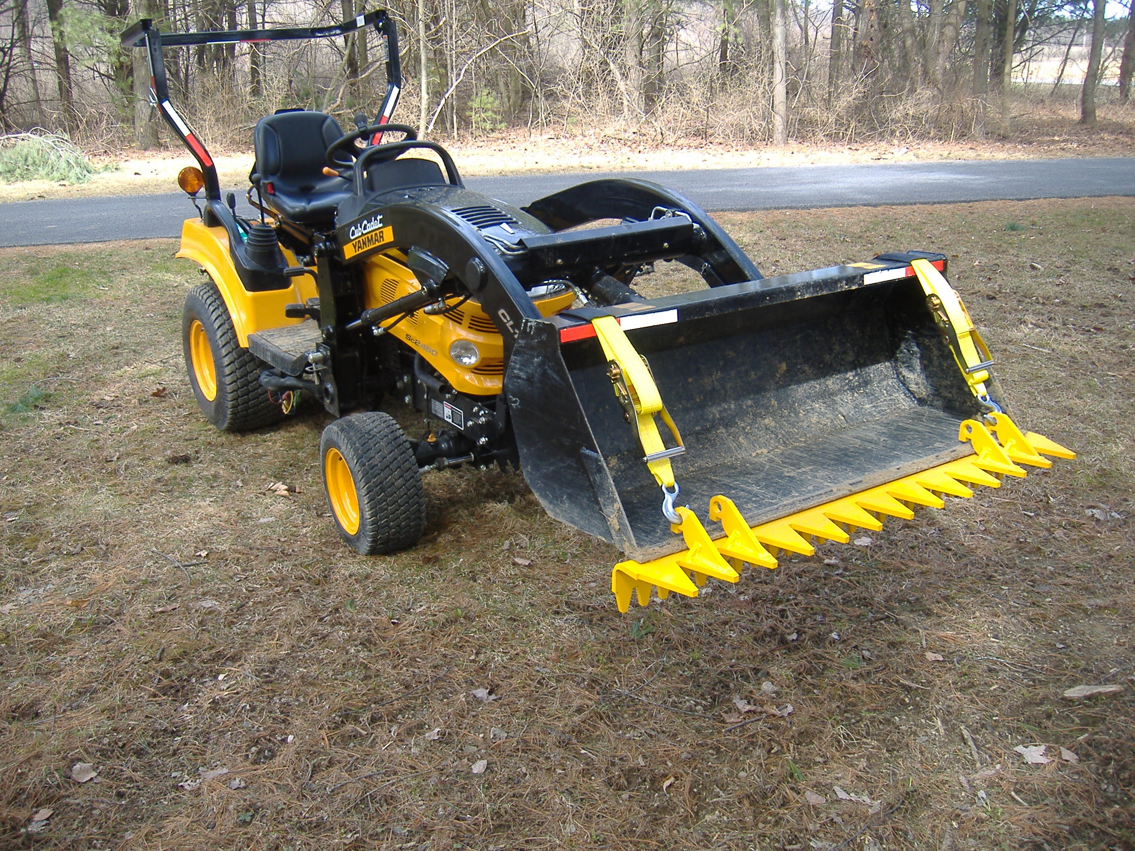

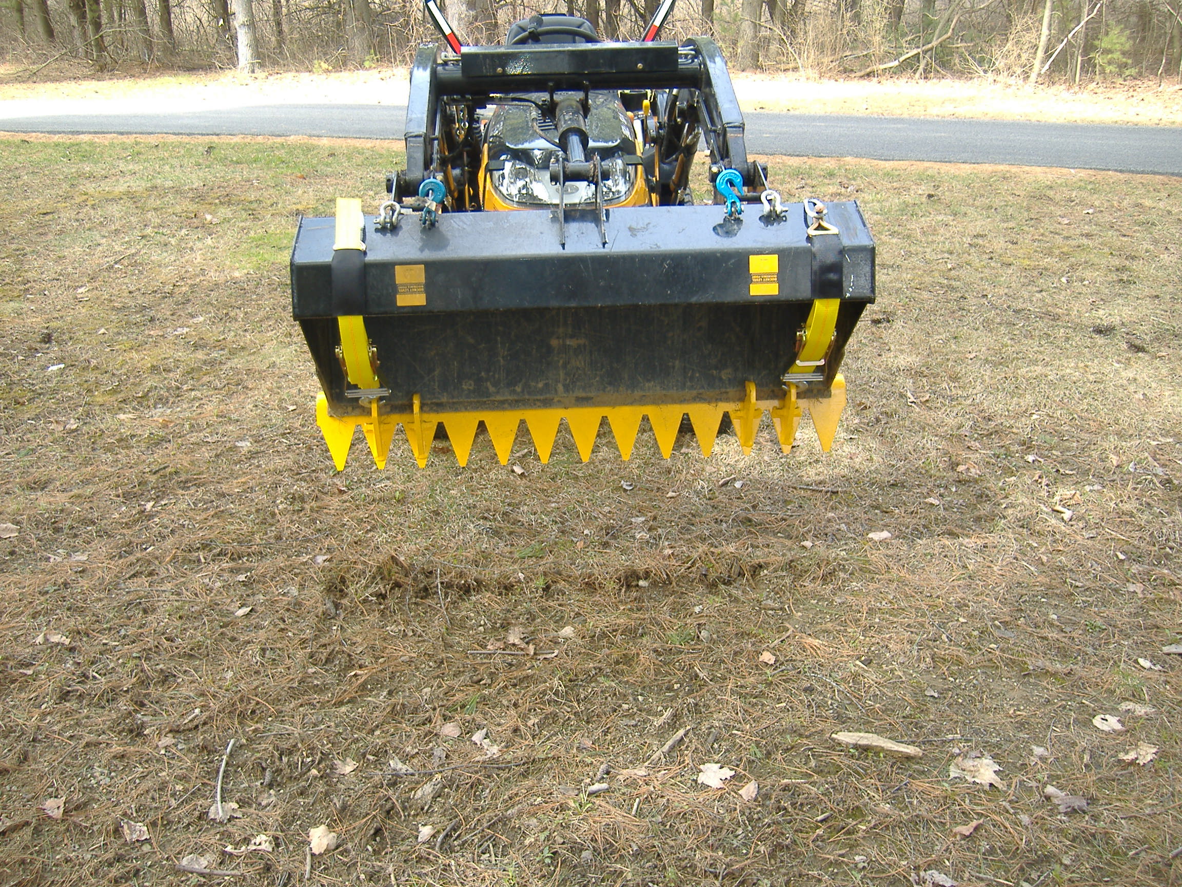

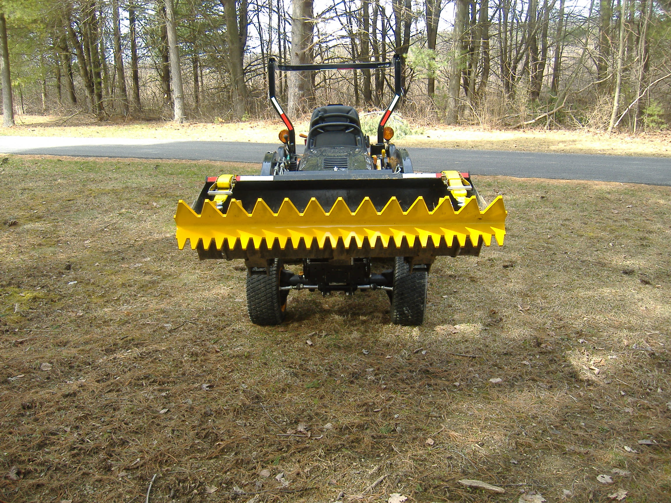

The issue with picking up debris is easy to understand if you imagine an attachment sitting just below your cutting edge that extends two or three inches directly down. When you try to scoop up a load into the bucket you are actually digging with the RR. Look at a sideways profile of a mounted RR and you will see what I mean. The solution is either to comeback later with the plain bucket or, at the end of the clearing remove the RR and secure it to the top of the bucket to get it out of the way.

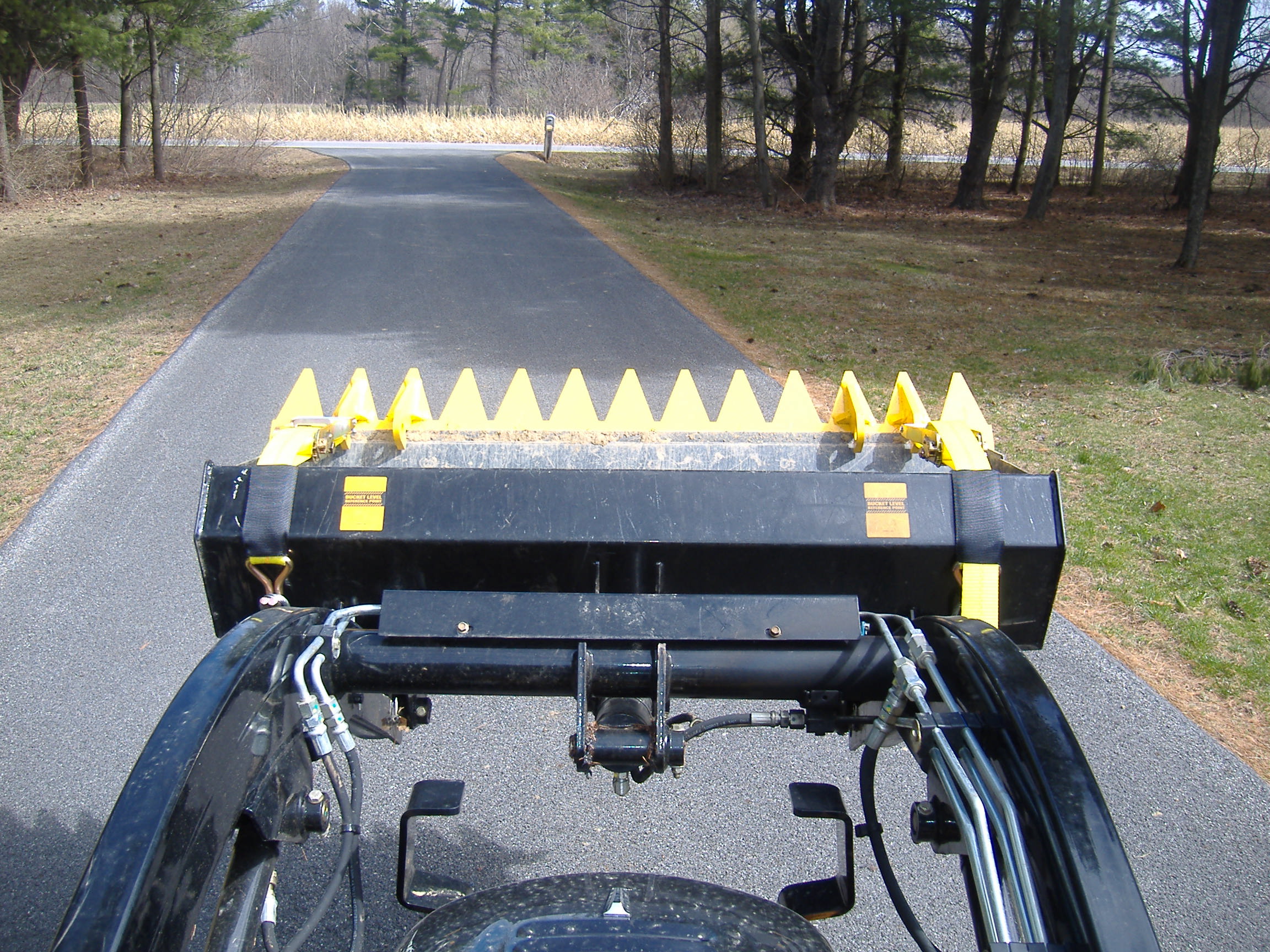

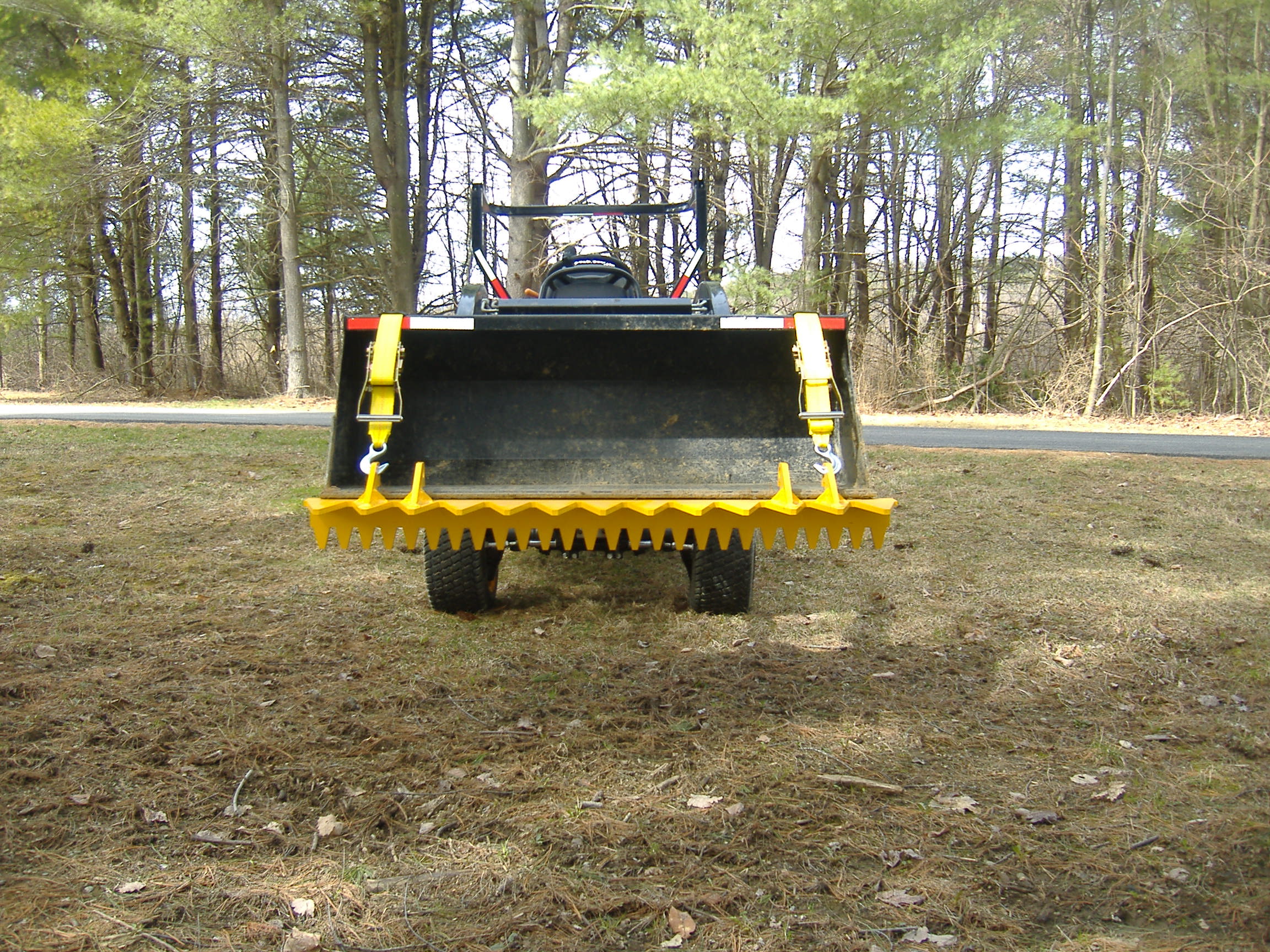

Just a thought as I have concerns with the straps being exposed to debris and how they would hold up. Wouldn't it have been better to have the ratchet and straps exposed only to the back of the bucket, and using the two cables, one on the top and the other on the bottom, keeping the ratchet and straps in the back of the bucket and out of the way of debris? I think the cables could stand the beating much better that the ratchet and straps.

That would seem to be a pretty easy modification. Just a couple of cables (I think there were two extra ones that came with the bucket) attached to the top links and shorten the ratchet strap. Certainly less obstruction of the bucket.

I haven't had any problem with the ratchet placement. It is in a convenient spot for me. Of course the ratchet does obstruct part of the bucket but you cannot use the bucket anyway due to the RR attached to the cutting edge. I suppose you could manually load the bucket but I tend to just pile stuff and then get it later once the RR has been removed.
