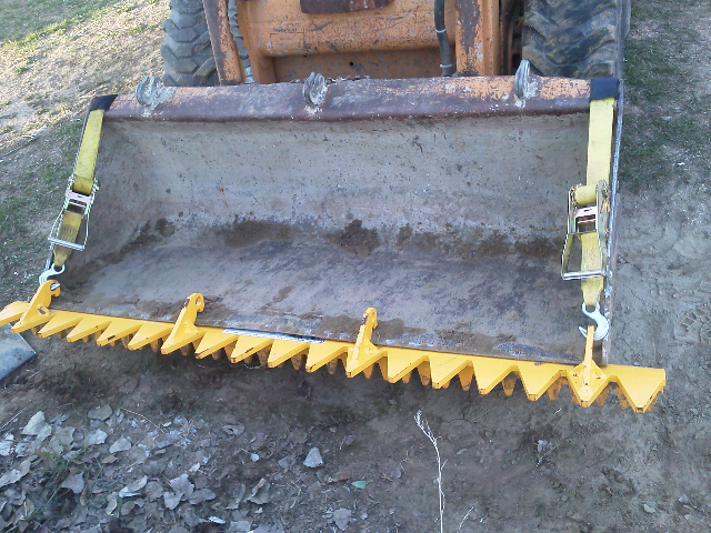

You welcome and good luck. Ill see if I can't get a picture of how I put the ratchets if I remember
   / Ratchet Rake #25
Here is that picture how I put the ratchets in the back of my bucket rather than in front.
Good idea radrock, this is how mine fits. I was thinking of adding a 1/2"plate extension, to the side of my bucket and bolting it on.
   / Ratchet Rake #27
I turned mine around cause I messed up one of the ratchets in the brush. You have a lot wider rake than I do. Mine is actually a little small but I wanted it that way. I have the 52" on a 60" bucket. It is pretty rocky here and I didn't want it to stick out the sides like that. I'm guessing you have the 68" And they only had the 52" at tractor supply at the time. You could bolt yours on pretty easy but then it would take a little longer to put it on and take it off.

The bucket is 66" and the RR is 72", it was clearance priced, from $359 down to $150. The next size down was $300, I figured I could cut off the excess, but the added length comes in handy on the skid steer, may be a pain with a tractor? I will be sure to flip my straps next time and try your idea, thanks
Dave

I've seen several folks flip the straps. But I've never had any problem with then even in my heaviest brush. My fit is not like either Radrock or Dr Dave. My mounts are about 2 " inside the bucket edge with the RR projecting out about 2 " on each side. I thought about a bolt on using a sleeve over the bolt, but - even with some reinforcement - I'm not sure how much force the bucket edge could take.
