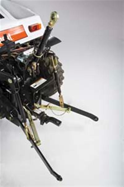

Looking for a cat 1 ratchet top link. Thought I had seen them at the local tractor store but when I went to buy one I couldn't find any. I read about taking a ratchet binder or jack and welding ends on it but I just want to buy one. Can anyone direct me to them?

Unless the ends of that Cat II one are too big for the tractor or implements, couldn't you just use a bushing on each end to sleeve it down to fit Cat 1 pins? The length of it looks like it wouldn't be a problem, but I dunno.

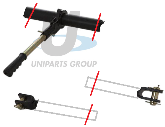

Just buy a ratchet jack and weld category 1 ends onto it. I don't know where you can buy ends in the States but in Canada they are available from Princess Auto

alright i feel like a bigger fool than normal. when i posted pictures, i wasn't paying attention and grabbed U ends ratchet jack. but now that i go back and google the stuff up. i am barely getting any ratchet jacks, let alone the cat 1 or cat 2 ratchet jack top links with swivel ball ends. i had amazon, ebay, (grainger or harbor freight don't remember which), and at min 4 other places that were showing pictures of a complete assembly. to make it a cat 1 top link setup.
google search "replacement 3pt top link screw" to change out the U ends for cat 1 swivel ball ends.
This would be the simplest , if you don't find a cat 1.

The retracted length might be a problem on some attachments. Plus both ends have to be narrowed and any store bought bushings would have to be cut shorter also.

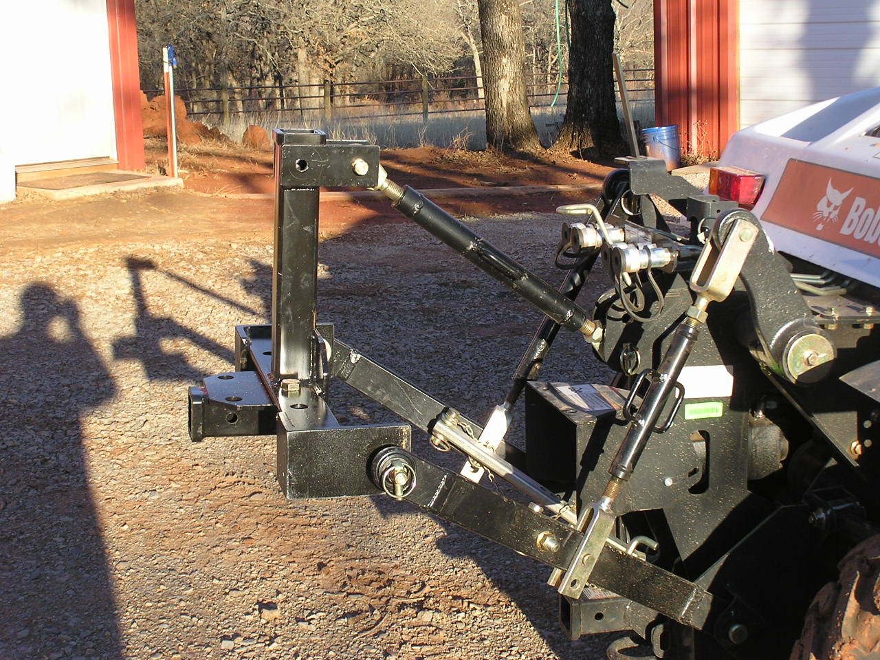

The cat 1 top link on our Toolcat adjusts from 20 to 29 inches. I think most tractor top links are shorter than that.
/ Ratchet top link #13
View attachment 386019 View attachment 386018
I just noticed that the Cat 2 ratcheting toplink posted above has a min/max length of 25.75 - 32.75 inches. I think a typical Cat 1 toplink is 21 - 28 inches. So the Cat 2 one might be too long for some uses.

what is the harm of unscrewing the ends, and simply cutting the ends down, both the "ball ends" and the center pipe ratchet itself?
/ Ratchet top link #15
Where are you going to cut the center pipe ratchet?
