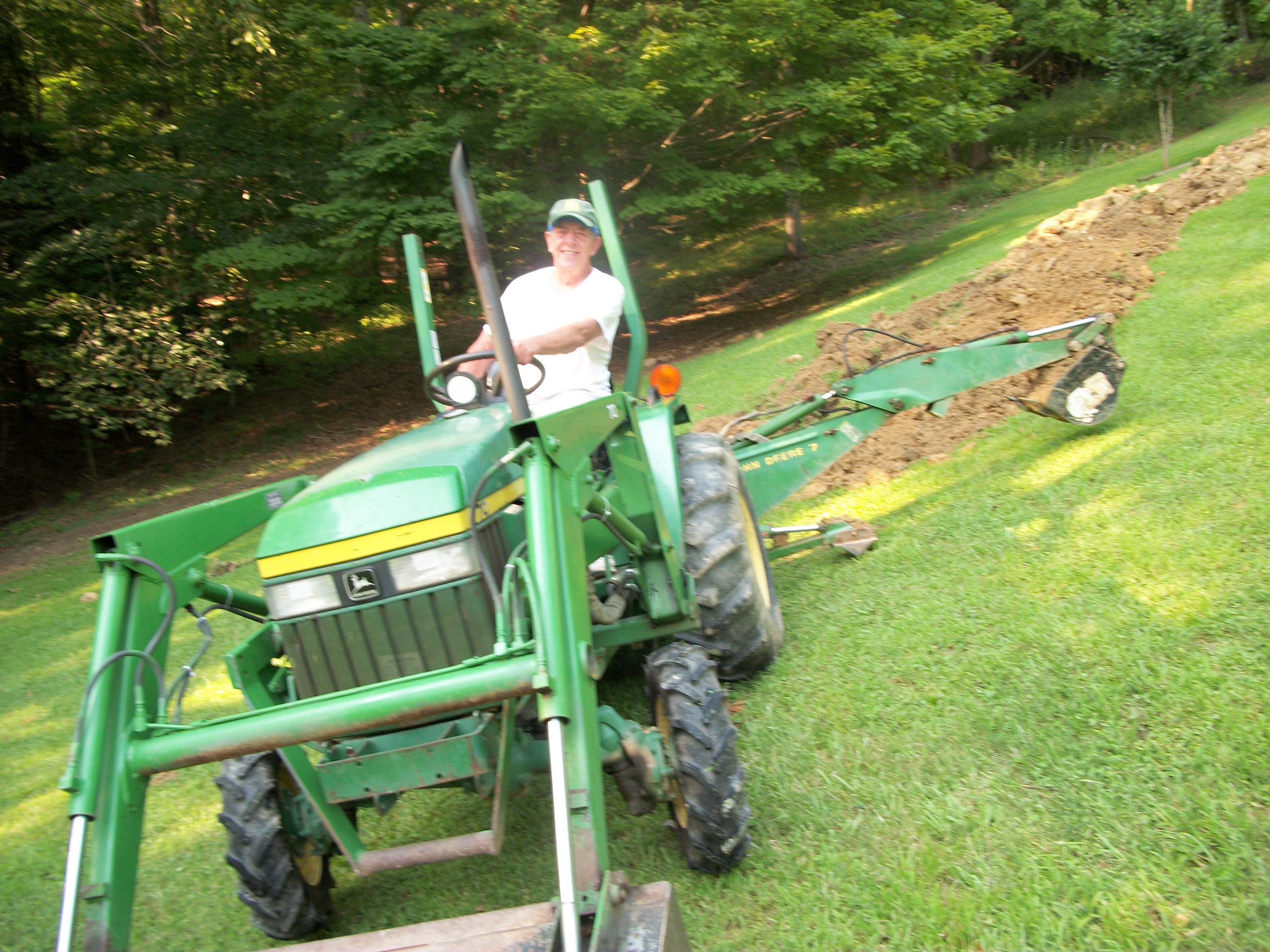

I wasnt mowing but withe my backhoe swung up hill when I moved my guage read just alittle over 20 degrees. I was concerened a few times. 247.jpgJust be safe. cobb71
   / Rate this Slope #26
cobb71,
If you do much of that stuff Just be safe, fix your rops.
   / Rate this Slope #27
cobb71,
X2!!! That not even Roll Over Protection System the way it is. Its just the remenants of what used to be a ROPS. Its one of those things you probably want to fix BEFORE you need it!!:D
