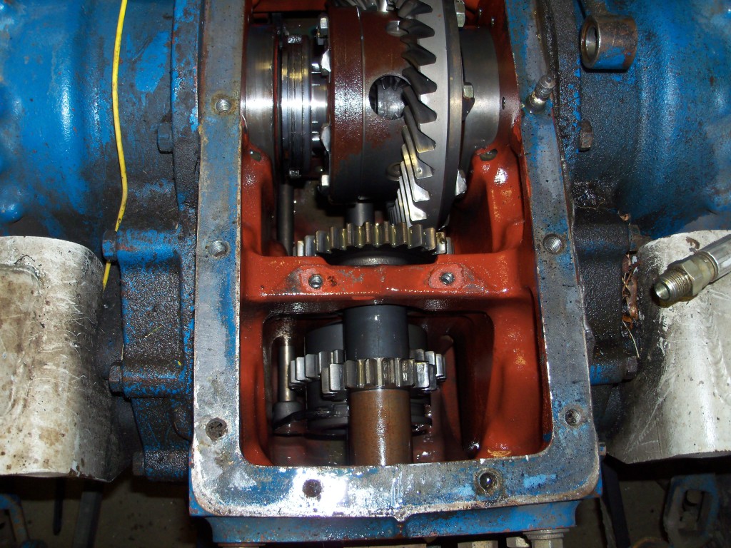

I started dissasembly tonight. The seat came off without any problems. I disconected the hyd lines for the loader, I removed all the bolts for the lift cover. I tried fo 1/2hr to get the lift cover off with no luck. Some one had had the lift cover off before and used some type of glue or sealer that I can't break loose. I even hooked the engine hoist to it and tried lifting it off. I just lifted the rear tires off the ground. I checked 3 times to make sure I had all the bolts out. So now I am on hold untill I can figure this out.

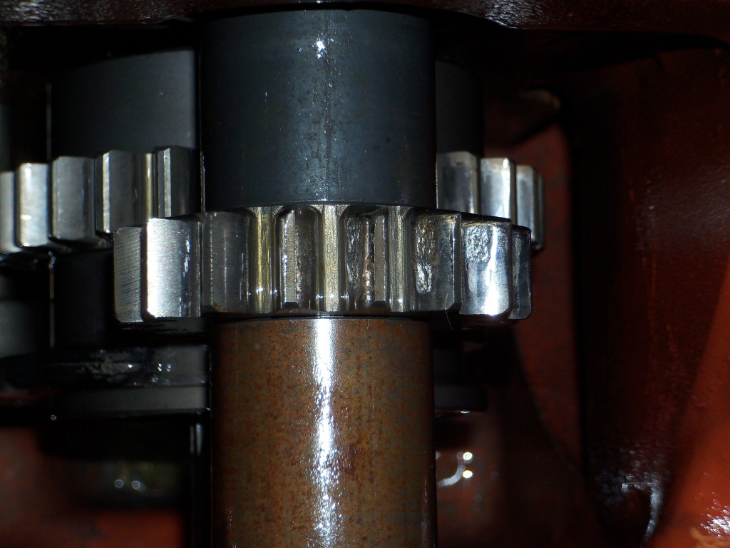

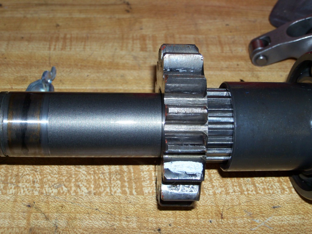

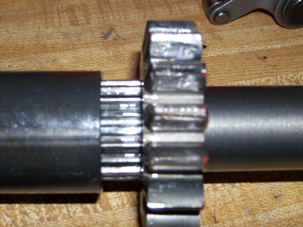

I got it apart. I used a portapower going from the drawbar to where the top link attaches. :thumbsup: What I found was a gear that is chattering not a bearing. The shaft and gear came out pretty east after removing the retainer and driving out the expansion plug. As you can see the gear is is chewed up on one side of the tooth only. I don't know what caused this. I looked on Messicks and the gear is $306.00.:thumbdown: I am thinking about just turning the gear arround so it would be driving against the smoth side. The gear that this gear drives is in perfect shape. I am wondering if vibratin from the flail mower or brush hog may have caused this.

Some of those gear teeth look damaged along the full length of the tooth. I don't see how turning the gear around will help.
I wonder if they was a screw up when thy hardened the teeth (they may not have hardened all the teeth )because all the teeth are subject to the same load when the teeth are engaged but not all the teeth are damaged. If it were me, I'd bite the bullet and replace the gear. If it fails, you'll be replacing more than one gear!

Bill,
did you check with Wengers of pa, I think the gear in question is pto counter shaft. They have one in stock for $56, although they list out 1910 instead of 1900. you might give them a call also. If that is what you want then it beats the heck out of NH price. If I did not have a better option I would turn the gear around like you suggested and lock it in place and put a threaded cover over the pto. It always turns but if you have a cover on it would not be very dangerous. Obviously you'll hook implement always with the engine off. Check the link below to see if that is what you need. what is NH part # you're looking for?

Today I took a closer look at the gear and it apears to have some hair line cracks in it. I called Messicks and ordered a new one. $330. to the door:( I hate buying used parts like gears. You never know how hard they were used. I should have the gear friday so I can have it back togethr this weekend.
