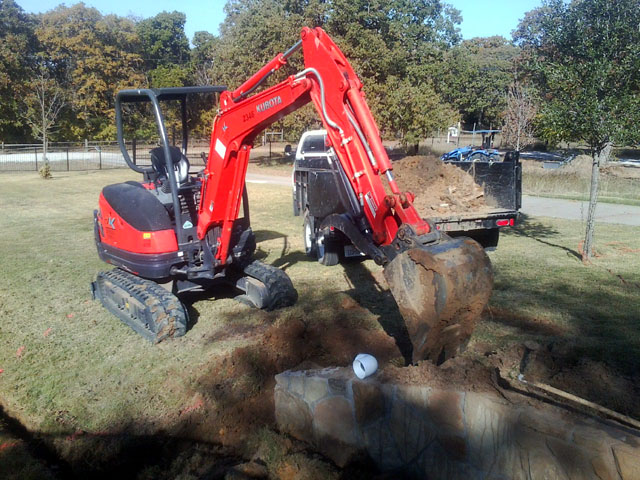

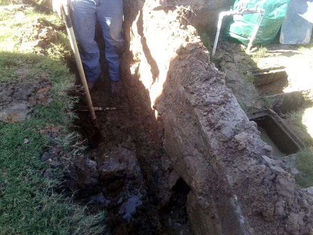

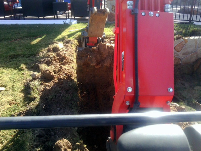

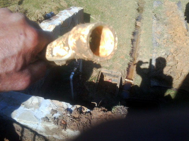

Here are a few photos from today.
I had help today so I started on the french drain. Apparently the pool contractor connected the fill valve directly into the main water supply without a backflow prevent valve. The homeowner knew better and had him change it but the pool company got the last laugh. While re-routing the line (goofy routing I might add) and putting in this little retaining wall (completely incorrect as a matter of fact) they must have hit the main and broke it. They repaired it but never primed or glued the coupling and obviously didn't pressure check it before back filling either! :eek: So this turned out to be the source of all of the water surfacing inside the water boxes below the wall...that the plumber said was from over watering the lawn. :rolleyes: We got it all put back together and left the hole open so I can check it again in the morning. I can't believe how many schedule 20 main water supplies I've seen since I've been here in Texas. It's hokey and just plain stupid IMHO.
