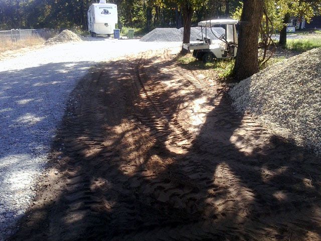

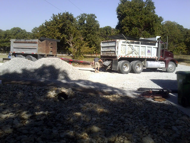

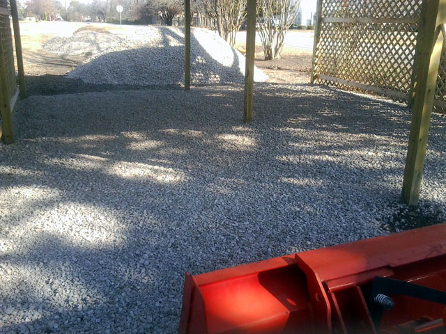

I got a tip yesterday about a start-up concrete batch plant in the area that also had a bunch of crushed, screened asphalt, crushed concrete and select fill dirt. After some vague directions and a few wrong turns, I finally found the place. The owner's a pretty interesting guy. He started and owned two batch plants, sold them both and tried to retire both times, but kept running out of money. This new venture is called Last Chance Concrete. Like I said...he's a pretty interesting guy.

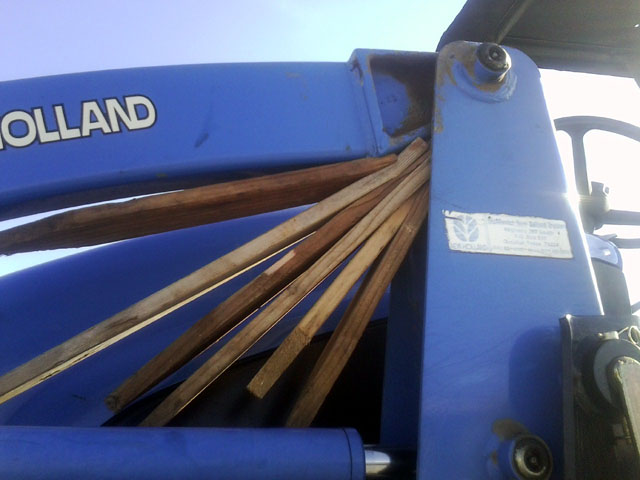

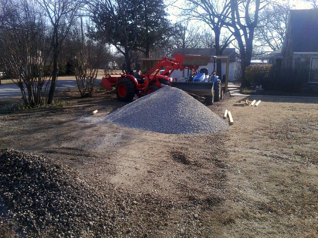

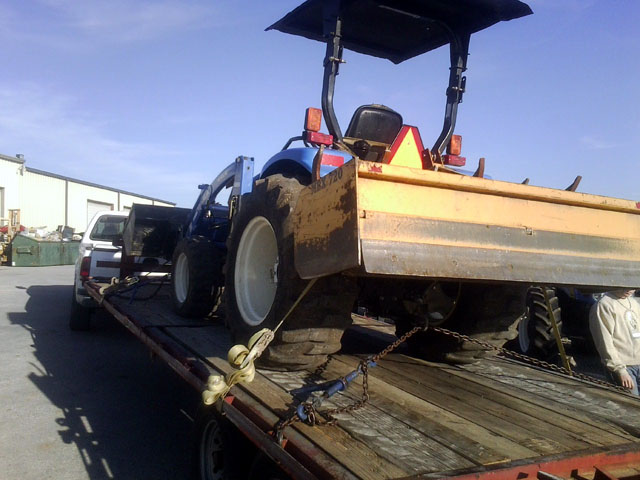

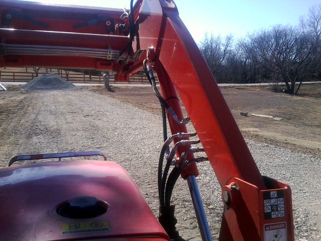

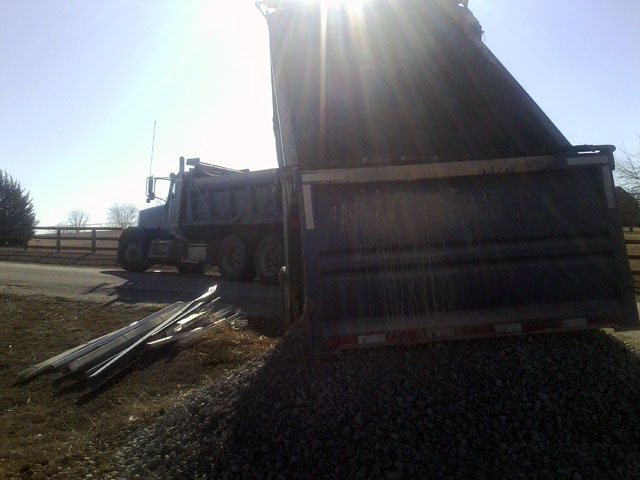

Well...TODAY was Monday!
Started out grading out a gravel driveway and ended up spending the rest of the day getting my tractor to the dealer. My NH was dead in the driveway with the bucket and BB on the ground. I picked up a Kubota MX4700 rental to get the NH outta there and finish the job up tomorrow. Of course...while I was trying to figure things out with Jinman on the phone...the gravel shows up. A special thanks to Jinman for running through what may have caused the breakdown with me and for the moral support!
This is NOT how you should transport a tractor. Loader wedged up off the deck and strapped down to keep the wedges from bouncing out, and the BB strapped up to the ROPS...and down to the trailer. You do what you gotta do...
Here are the loader arms wedged up with 1x3 stakes I had in the truck. It held (barely) for the trip to the dealership.
You know, it just dawned on me how thankful I am that this happened today. Since it's MLK day, my boy was out of school and went to work with me. This would have been a much bigger problem if it had happened tomorrow, when I'll be working alone again. :thumbsup:

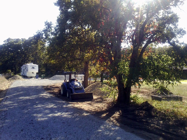

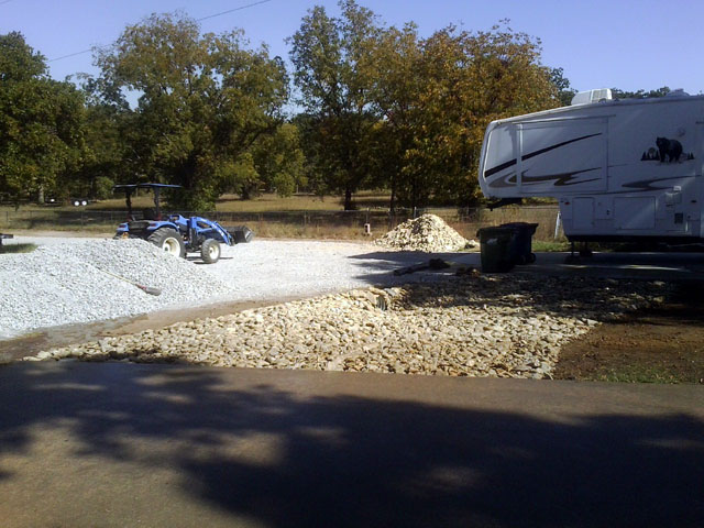

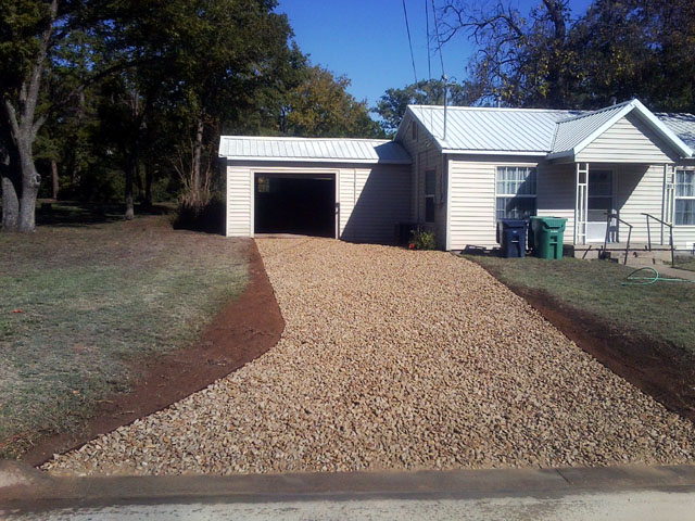

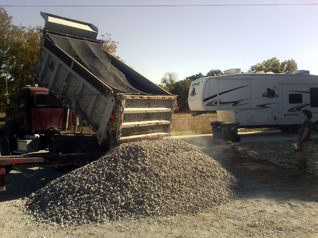

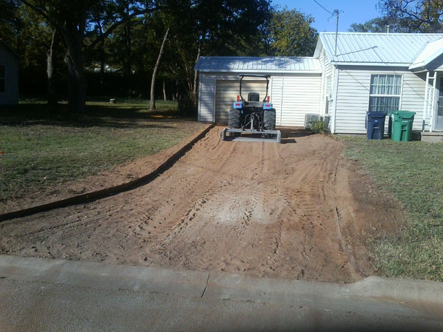

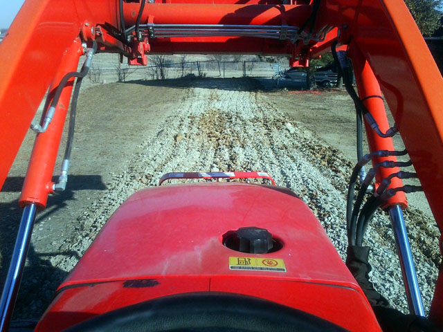

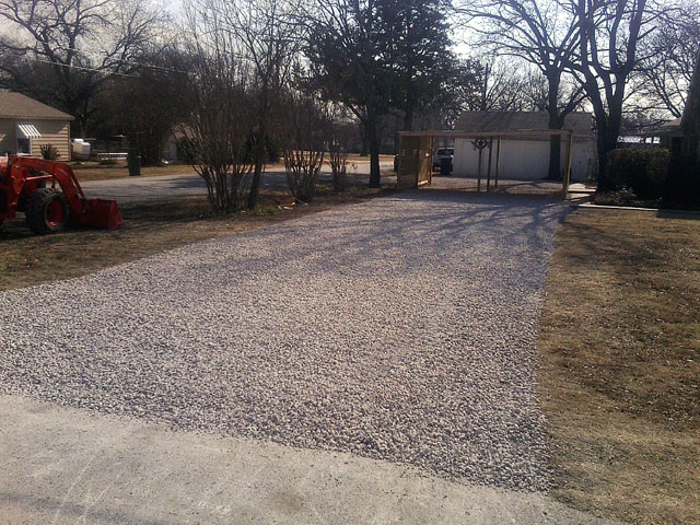

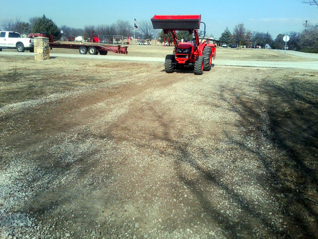

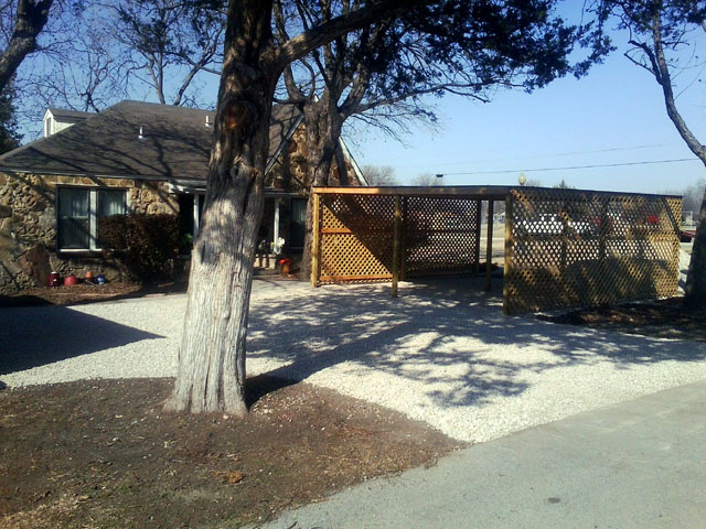

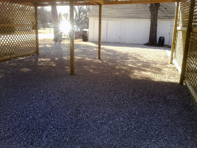

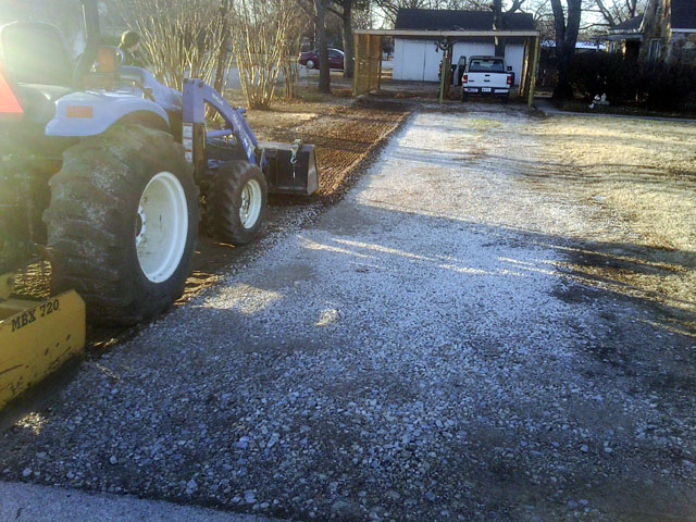

Finished up the the driveway today with the Kubota MX4700.

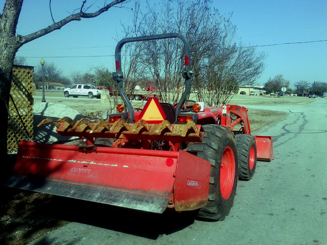

I don't like the tractor much, but I do like the 1000lb Gannon BB. Just wish it didn't have that danged tailgate.
/ RDrancher's Photo Thread #177
Doesn't the tailgate have latches so you can pin it fixed? Both of my blades have flaps that allow the inner blade to dig and the rear blade to float. Mine also pin down for extra spreading, but I usually just let them float.
#178
Yes, it had the pins to secure it, but the nuts were rusted onto the studs so bad that I thought I'd twist the threads off trying to remove them. I sprayed them with some PB Blaster when I got home, so we'll see if they move better in the morning. Personally, I don't like a floating tailgate for gravel work, especially pure stone. Since gravel is what I work with most of the time, I could do without the tailgate just fine. Also, I've found that when back-blading most materials the non-floating tailgate BB's seem to roll the material over and mix it better too. It's just a personal preference. Today when I back-bladed to catch the little nooks and crannies, the ledge behind the floating blade kept picking up stone and then depositing it in the street. Extra cleanup work = no happy Johnny.

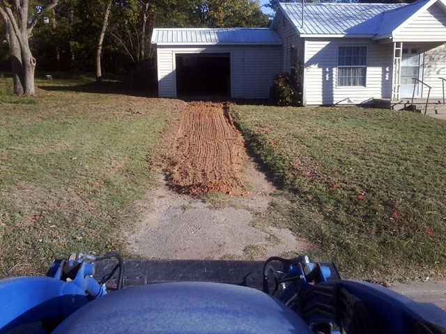

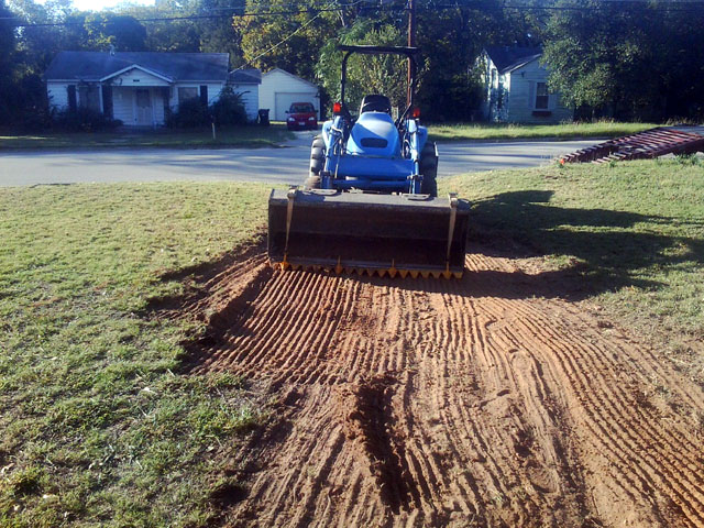

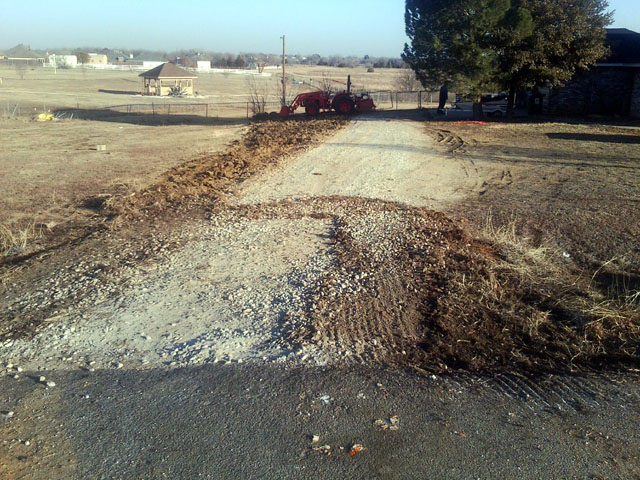

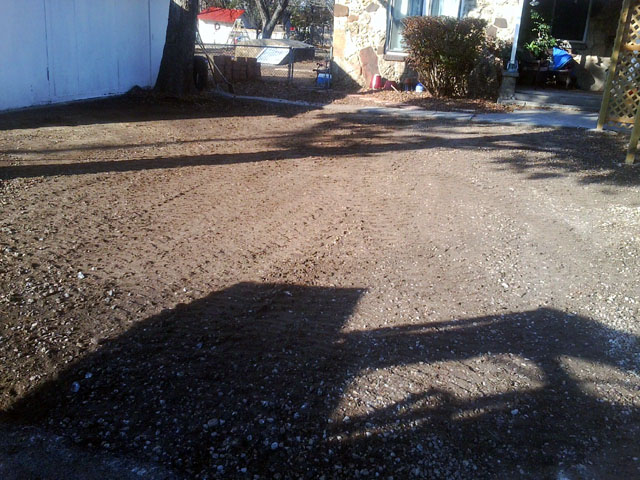

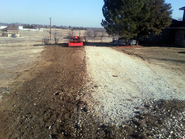

Another little driveway expansion and topping job.
Making a mess so I can fix it.
Did some grading, and wheel rolled it. Then ripped up the existing base and spread it over the whole area and wheel rolled it again.

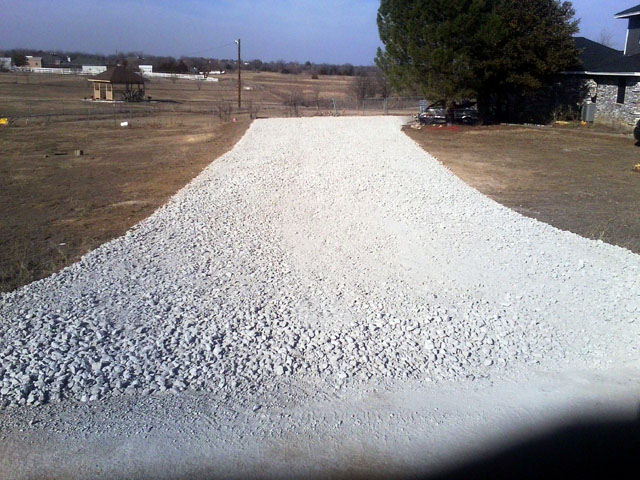

Then topped it with road base and wheel rolled it again.
