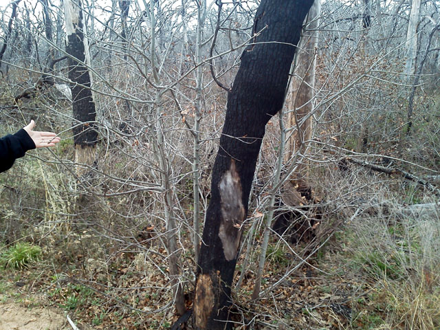

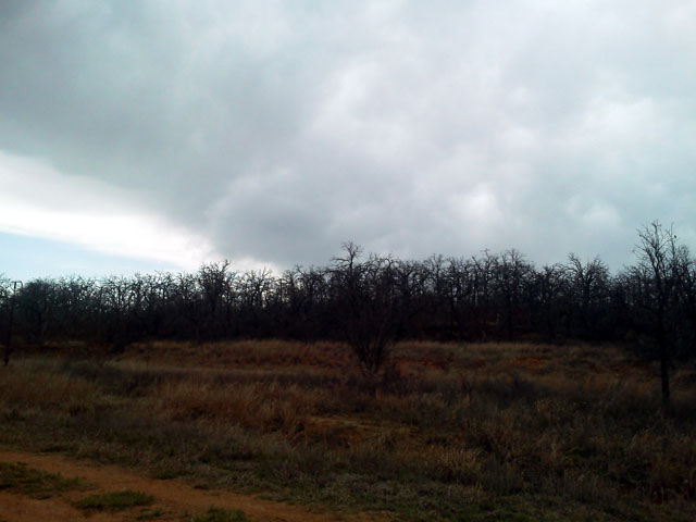

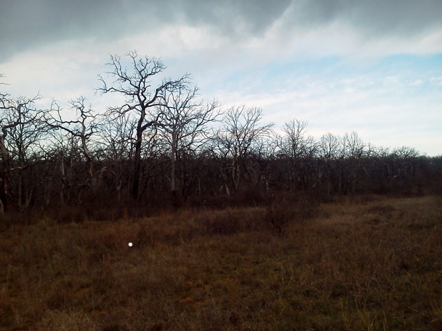

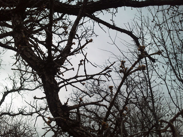

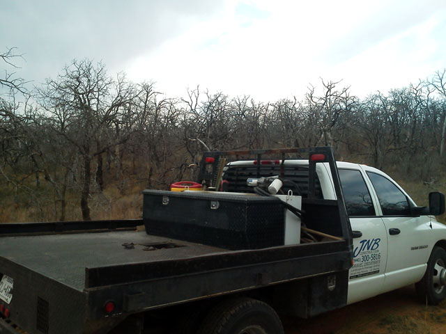

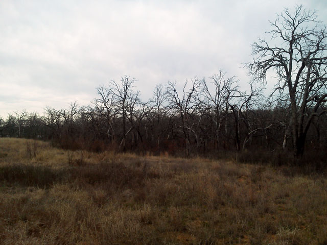

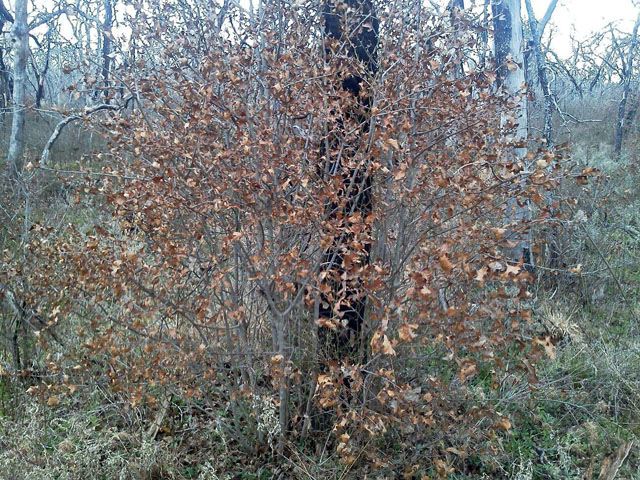

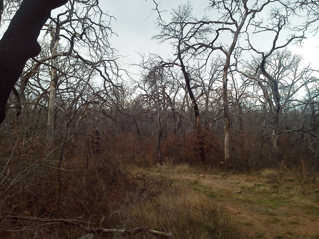

Checked out the 150 acres of burnt oaks yesterday. A lot of trees to shear and stack, but it was great to see signs of life here and there. Some trees survived the burn and suckers abound. I have a thread going in the Land Clearing section, but I'll post all of pics here as the job progresses.
Jacks01.jpg Jacks02.jpg Jacks03.jpg Jacks04.jpg Jacks05.jpg Jacks06.jpg Jacks07.jpg Jacks08.jpg

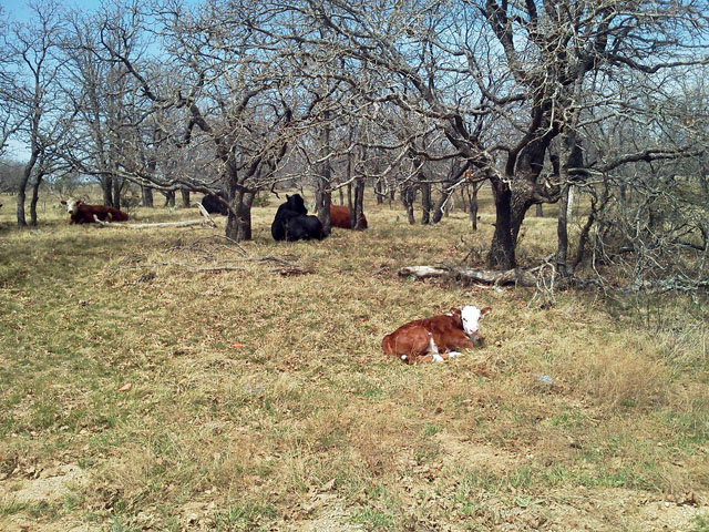

The home and surrounding trees were saved. Here on the property just next door, life goes on as usual.

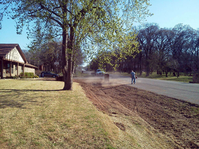

Knocked out a little project today. The owner was tired of his guests having to cross the ditch if they parked on the street, so I filled it. Set 50' of 15" culvert pipe and then scrounged up grass and soil to get it graded out. Cleaned up the remaining ditch a bit too. Note the stack of roots sitting next to the tree. The owner was chomping at the bit all day to help out, so when it came time to cleanup, he asked if he could do it. :thumbsup:

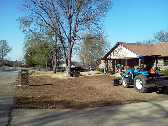

Another re-grade and an RV pad.
Here's a before shot.
<img src="http://www.tractorbynet.com/forums/attachment.php?attachmentid=291667"/>
Working the edges with the Ratchet Rake.
<img src="http://www.tractorbynet.com/forums/attachment.php?attachmentid=291668"/><img src="http://www.tractorbynet.com/forums/attachment.php?attachmentid=291669"/>
The owner didn't have time to move his trailer. Figures it'd have a flat.
<img src="http://www.tractorbynet.com/forums/attachment.php?attachmentid=291670"/><img src="http://www.tractorbynet.com/forums/attachment.php?attachmentid=291671"/>
RV pad graded and done.
<img src="http://www.tractorbynet.com/forums/attachment.php?attachmentid=291672"/>
Job completed.
<img src="http://www.tractorbynet.com/forums/attachment.php?attachmentid=291673"/>

John, Did the fire pass through the neighbors land too? I was wondering if the amount of brush and undergrowth allowed the fire to get hot enough to kill the oaks, but that wasn't the case where the cattle keep it cleared out?
150 acres will keep you busy for a spell. :)
