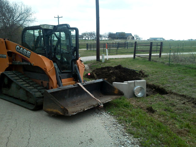

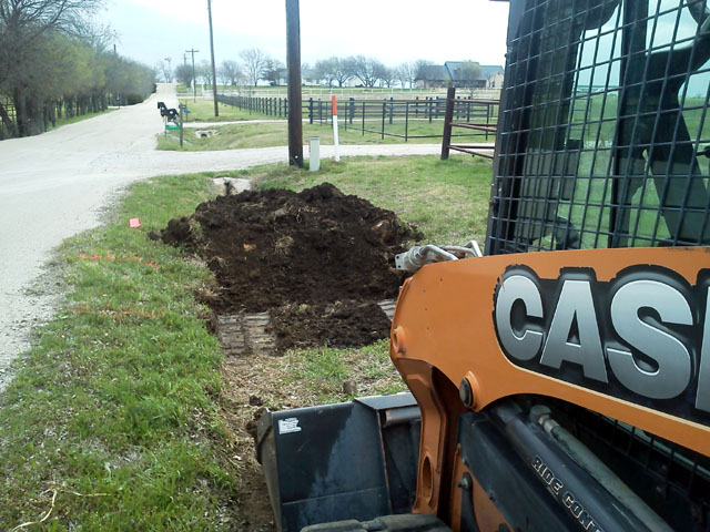

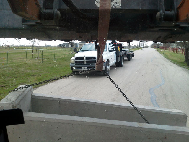

Here's a few pics from today. Set a culvert and precast ends. I must be getting CRS cuz I keep forgetting to take "after" pics.
