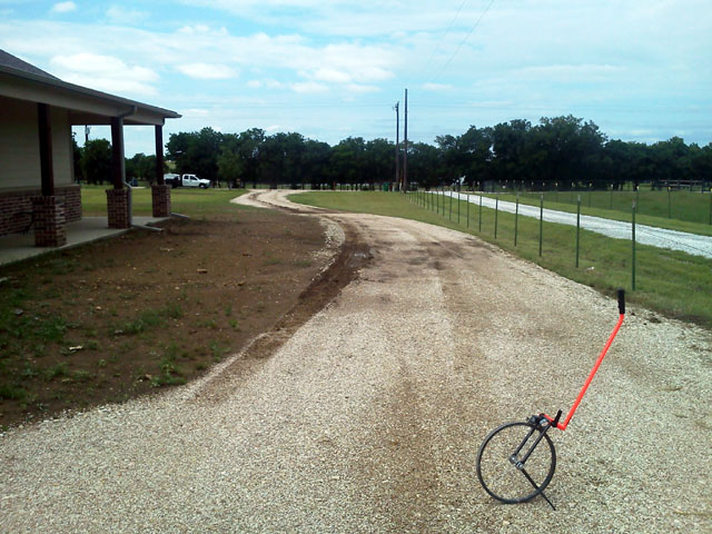

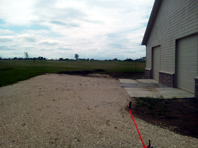

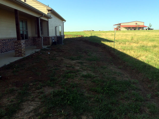

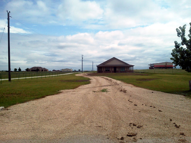

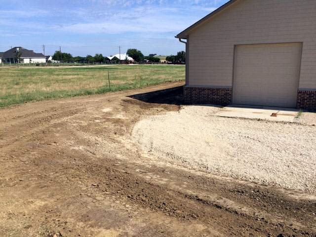

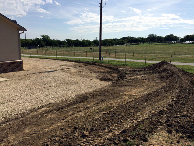

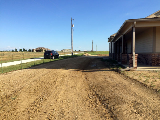

In the meantime, here's a few more pics from another job. I originally placed a culvert pipes and precast ends for this customer quite awhile ago. Their builder included the grading and gravel driveway into the price of the build. During the heavy rains this Spring the homeowner found out quickly that the builder's guys didn't do a very good job at getting the runoff away from the home, let alone getting it to the barditch at the front of the property. They had set it up with 12" of fall in less than 30' toward the garage and then directed the flow across the peagravel driveway. That, and they didn't provide any direction for the runoff from above the property or down the sides of the home. They came back to "fix" it on three separate occasions and it still ended up like this.

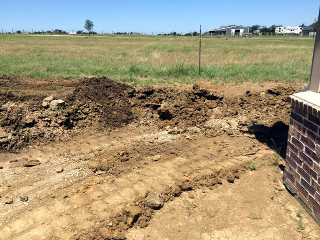

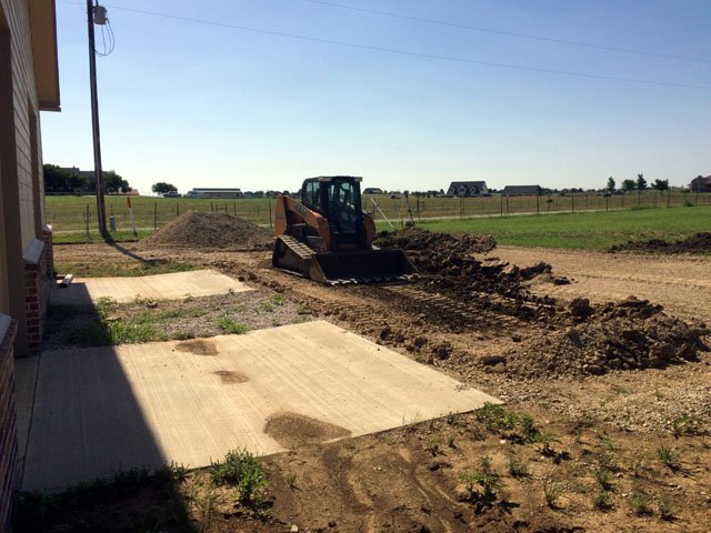

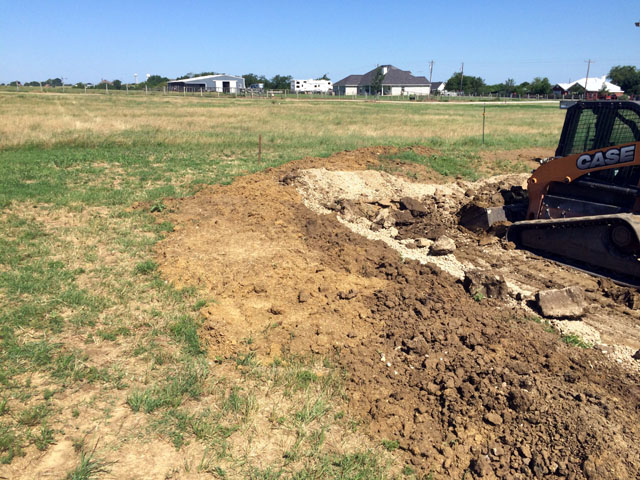

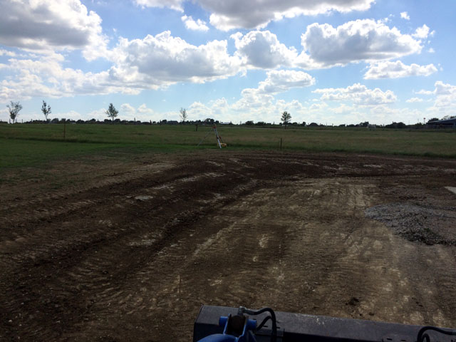

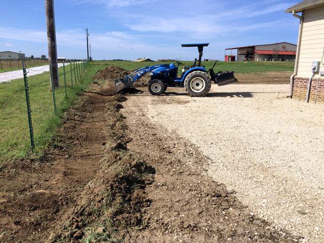

I stripped the peagravel off and started hogging out dirt to use for building up the driveway. There was so much loose peagravel that I ended up mixing it in with the soil to get rid of it.

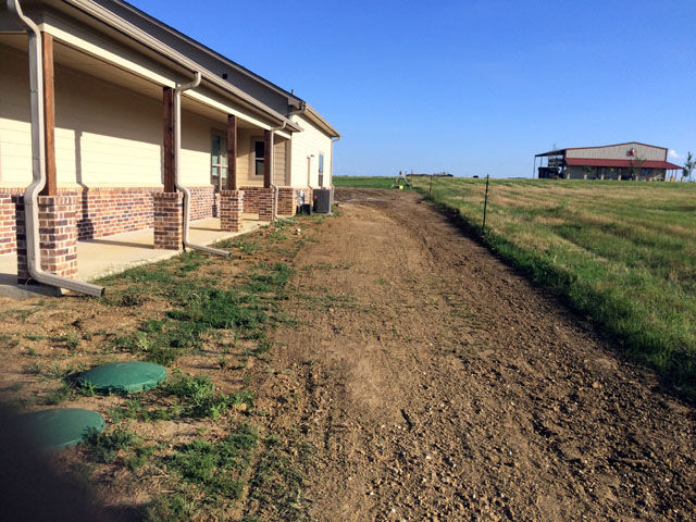

In the middle of grading out the slope behind the garage, the tracks on my Case started popping pretty bad. I didn't want to break a track, and since I had new sprockets scheduled to arrive in the next few days, I took the Case home and picked up the blue wonder machine to finish up the job.

A few more...

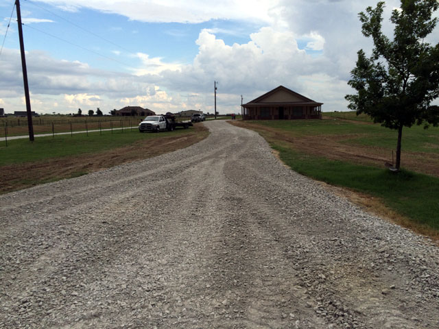

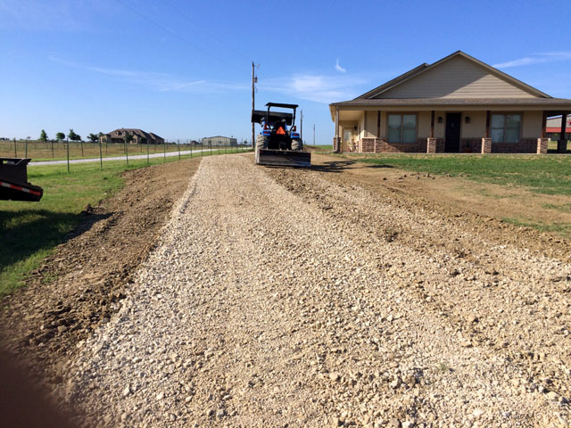

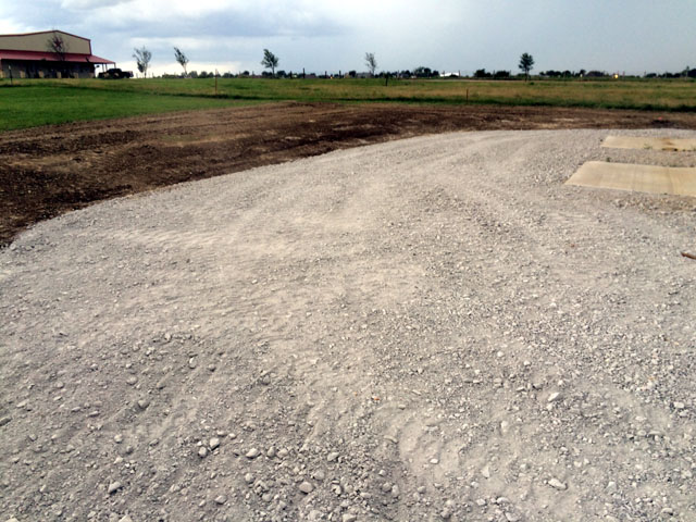

After getting everything fixed up, I spread five semi-loads of roadbase on the driveway. The larger stone and fines will hold up a lot better than peagravel. I only snapped a couple quick "finished" photos. Hard to see in the pics, but (yet another) storm was blowing in fast and it was starting to hail.

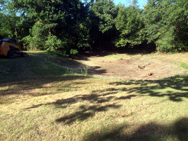

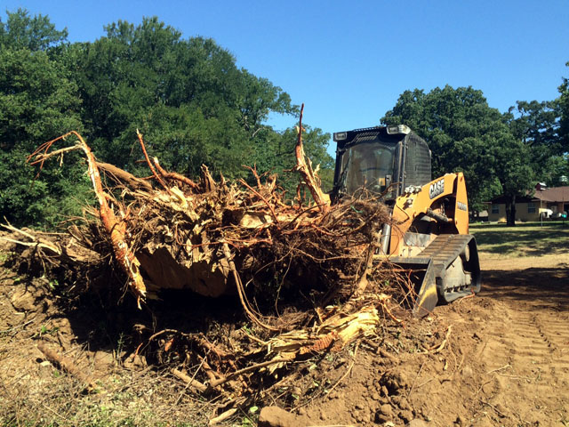

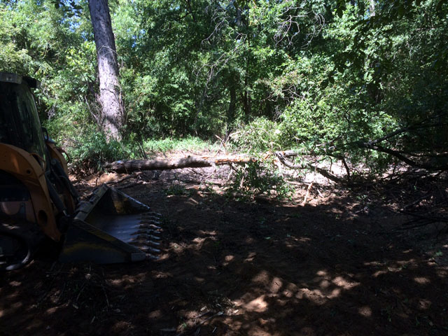

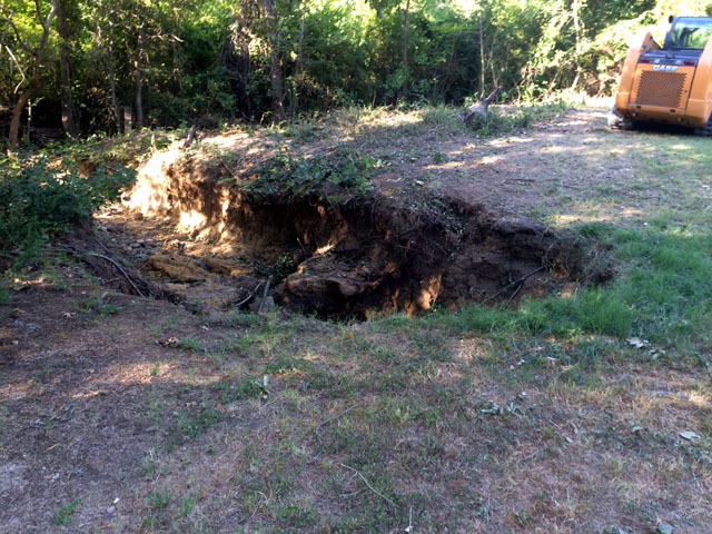

I've been busy and haven't posted any updates lately. Here's a few from the current job I'm on, filing in a pond and doing a bit of land sculpting. The pond was built to collect runoff from the subdivision, but the soil is too sandy and it became more of an eyesore and debris collector than a pond. The excavated dirt has been there for over twenty years and was covered with trees. The homeowners tree guys came in and cut off most of the trees at ground level, making them a pain to remove.
The hole behind the Case is over ten feet deep. I sure don't want to accidentally back into that one!
