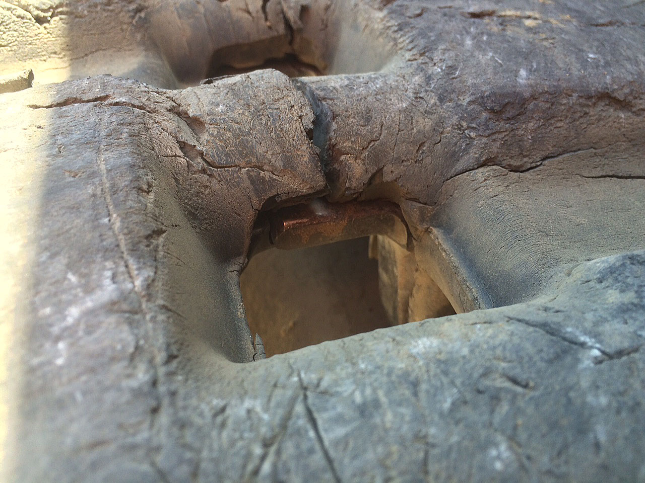

I had to pull off the pond job since one of the tracks was just begging to break. There are now two split steel lugs pulling through the rubber. I'll have new tracks and rear sprockets by Wednesday. Looking forward to a better ride and more traction.

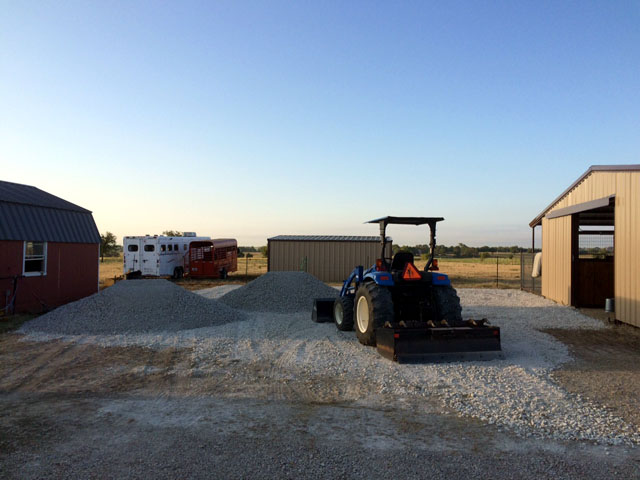

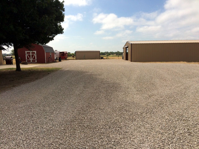

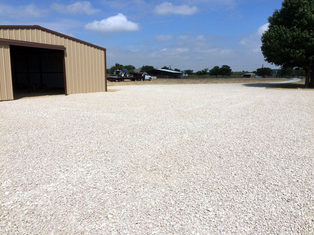

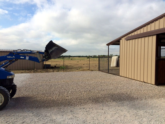

Placed and wheel-roll compacted 48 tons of roadbase and topped it with 24 tons of 3/4" minus crushed limestone. The turnaround area also had trenches through it, so I fixed them and spread the leftover stone.
You'll notice the customer's tractor sitting next to the shed in the first photos. I needed it moved, but he said it wouldn't start. I traced it down to the neutral safety switch. A little tweaking of the mount and it fired right up.

Nice job as usual. I'd love to see you spread and grade the finish grade via video so I could pick up a tip or two. :thumbsup:

Looks as flat as a pool table. Sign me up for video lessons too! Good idea Pix.

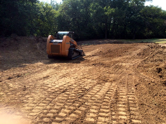

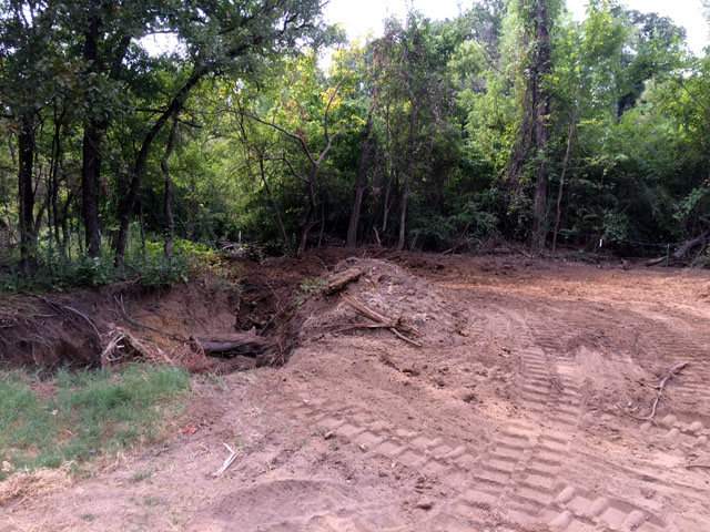

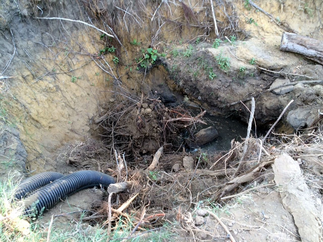

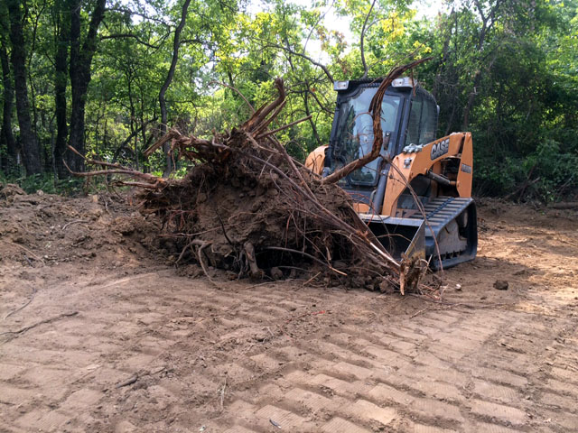

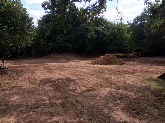

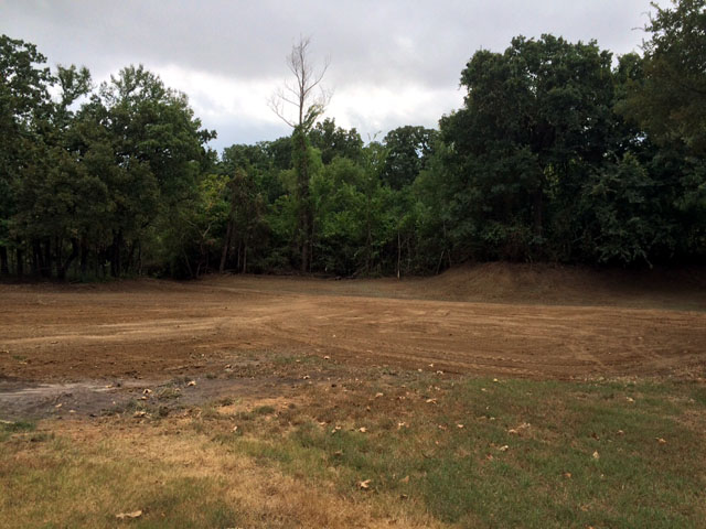

Here are the pics from the pond fill in I had to pull off of to put on new tracks.

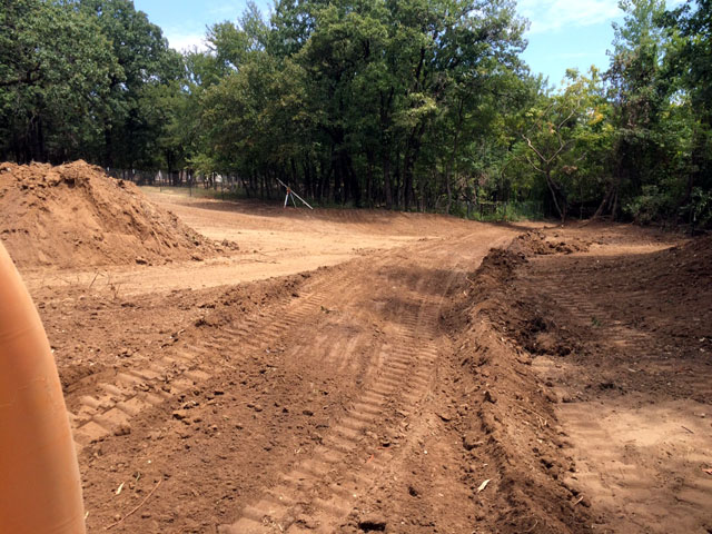

Cutting the new drainage path.

There was a lot of separating soil types on this one. Clay was saved for the drainage area, and sandy soil was mixed with topsoil and spread over the top of the filled pond.
