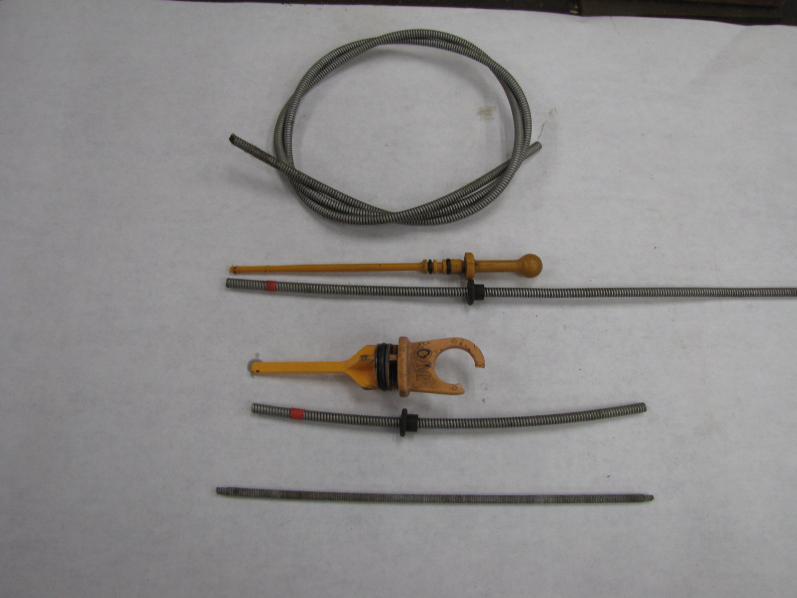

The spring that is used to run up the out put tube to clean it. Your wife well know what spring I'm talking about. A old throttle cable off of a lawn mower that does not have a cover on it, just use it without inter core wire.

Leejohn,
I apologize Sir, I am definitely missing something. What are you doing with the spring (btw, bride does not know either)? Or, the throttle cable cover sheath?
Just thinking, are you suggesting I would wrap the dip stick with either item, perhaps to create more surface area and hence more adhesion?
Thanks for hanging in there...

   / Reading Hydraulic/tranny fluid levels #19
The top picture is a throttle cable casing. The next one is my B7800 dip stick and throttle cable casing, then the BX2660 dip stick. The bottom is a bun coffee pot clean out spring. Hope you get it now. BTY I have not tried yet, but I think the guy that posted using a paper towel would work good.
