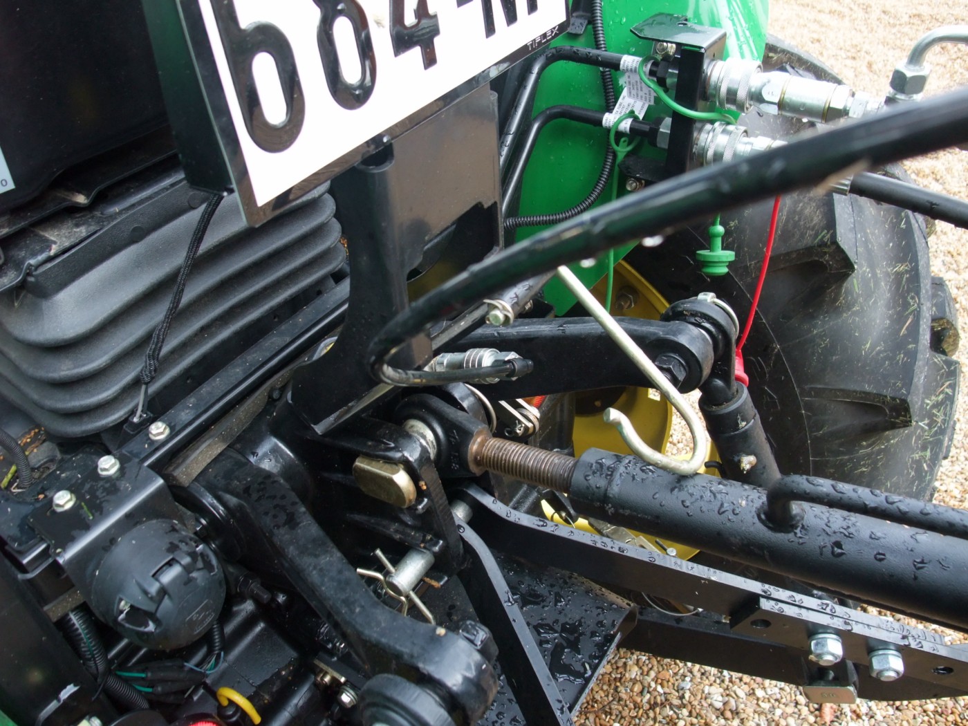

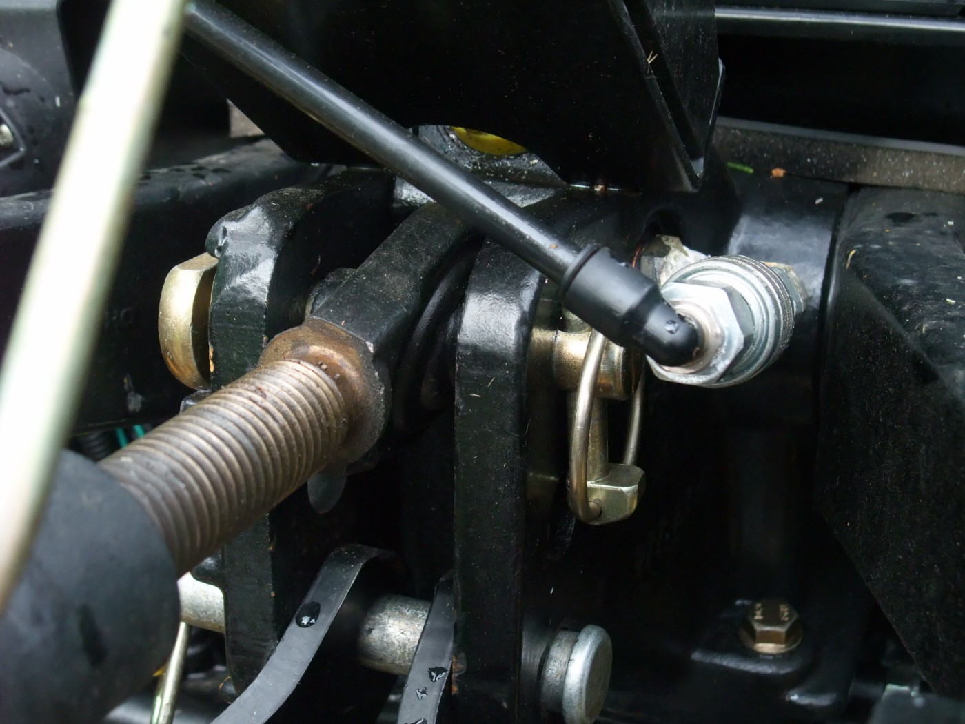

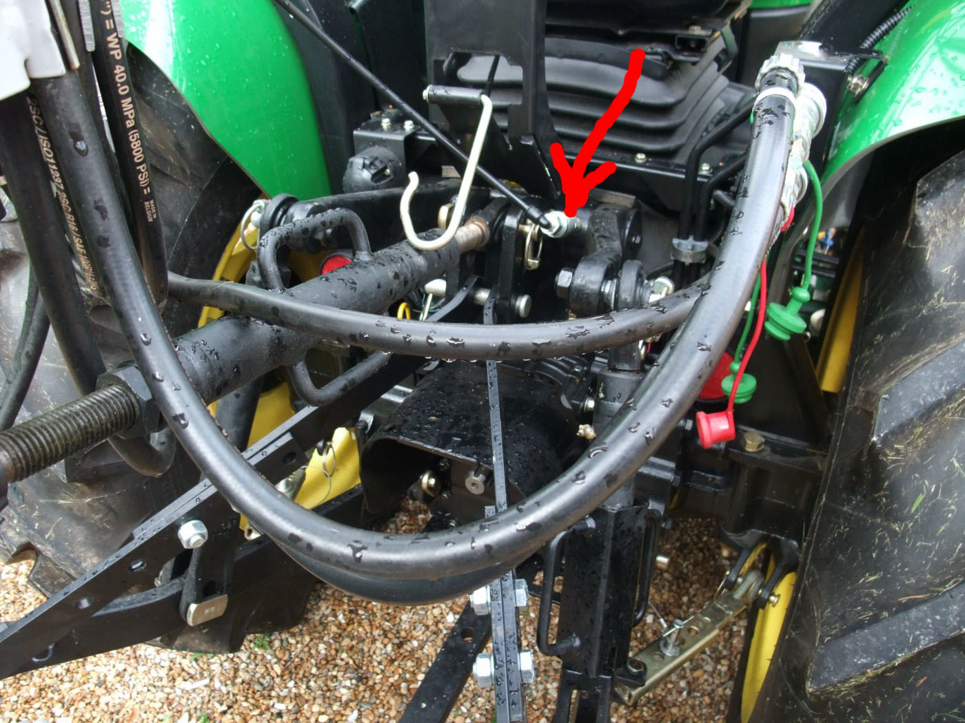

IF you can find a "tank" port on your machine, then you can use a PB equipped valve with the PB port feeding the backhoe and/or the 3PH.
If no "tank" port can be found, one can be created by drilling a hole like the one on the pictures below of my JD 3520.

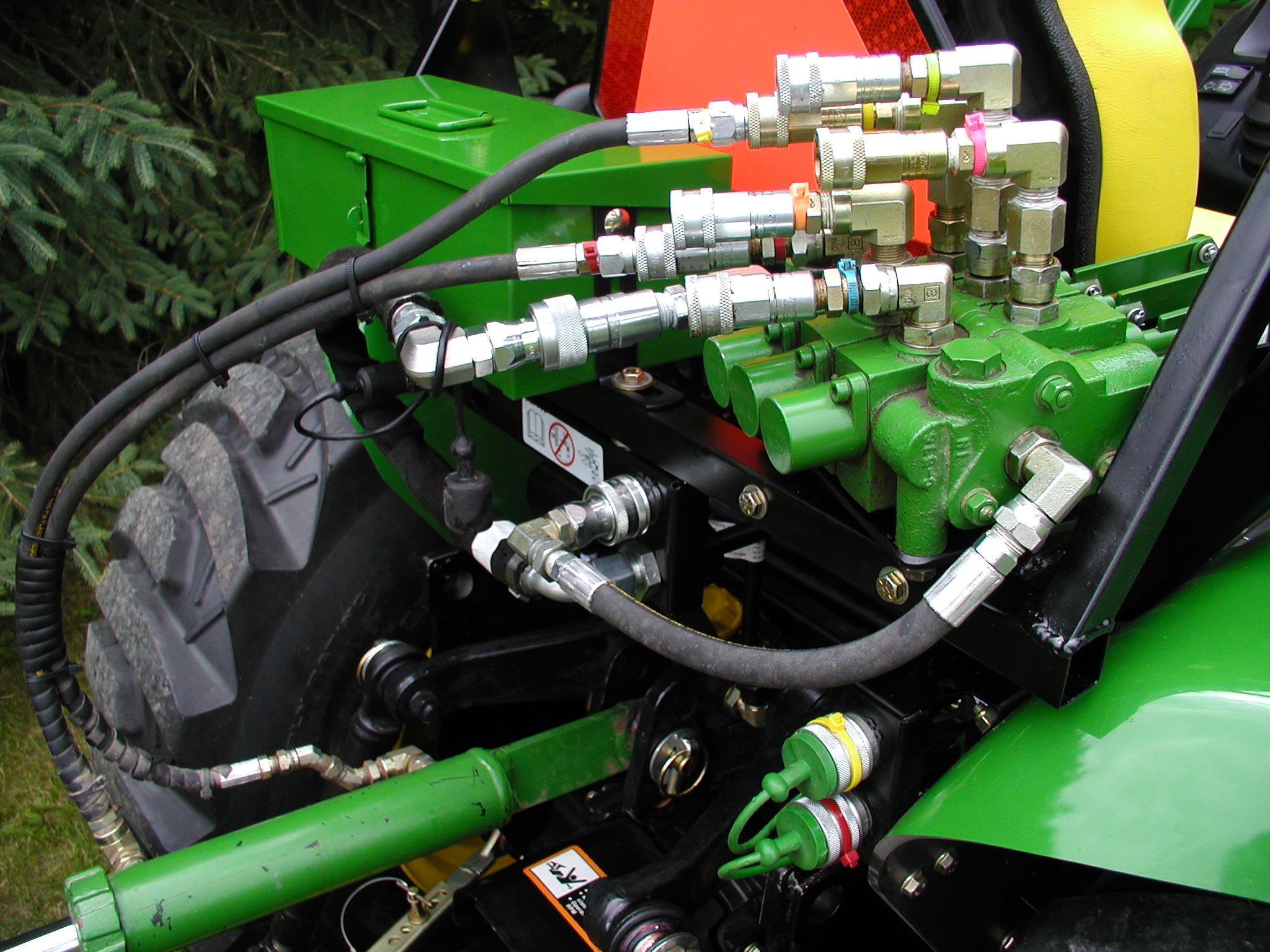

OK, now I am confused. All the talk about in series or not in series got me jumpy. Is something like what is show in the attached picture OK? This is not mine, but I am doing something similar. Going from the JD installed Power Beyond supply into a Prince valve inlet and then from that valve outlet (not its optional PB outlet) to the JD PB return that supplies the hitch. With this setup the 3 pt hitch can be used via the open center Prince valve as well as operating the TnT. From what I can deduce, the Prince valve would be in series with the 3 pt hitch valve, right?
On my JD 3320 I have installed the valve, plumbed it in, and the 3 pt hitch works fine, just want to make certain I do not mess something up.

If you ask me, (and quite a few others who have done it this way) it is fine. If you ask JJ, your valve will probably blow up.

Don't be such a wise^^^ around Christmas. It doesn't gain you much.
I hope we are talking about the same thing, for I think you are mistaken if you think it is alright to connect the return port from one valve to the next valves IN port.
You keep reading the manuals, I will keep relating what works in real life-not only by me (My projects are well documented) but by plenty of others both here and elsewhere.
I do understand that using a valve with PB is always the best choice...but you have to understand it is not always possible either. Like I said before, How may backhoe valves Edit: and LogSplitter valves are exploding?
