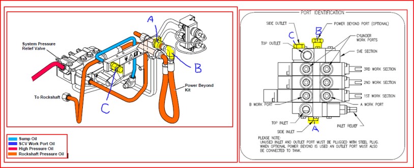

I was taught back in the day that it is not a good idea to pressureize the return core, or the outlet in the valve body.
I would not take for granted all valves can stand the outlet pressureized! They are not meant to, unless they are designed for it!
Power beyond is not possible on every valve setup. If there is no extra outlet, it cant be done with out pressureizing the return core on the flanks of the valve housing. Not many valves are designed to withstand pressure on the flank return core.
To make safe power beyond, I would use it on valves with extra outlet AND designed for a power beyond plug.
I took a look at Prince RD5300 valve and found out their system. See this Prince pdf-file!
I have set up a few pic's to show the Prince system, which should be about the same for most brands.
They also have an option to convert to Closed Center!
Also to note that power beyond don't allow operation on PB valve if mainvalve is operated (Open Center fully closed). UNLESS it is possible to connect the pressurized parallell core from Main valve into the PB valve.

So the best solution for me and my JD 3320, in a perfect world, is to connect A to the Prince valve inlet, B to the Prince valve power beyond, C to the Prince valve outlet (return)?
I like your pictures!!
Q's!
  • I assume you are connecting only one, 3-spool Prince valve unit??
  • Which one of A and B is pump supply line??It looks like A to me.
  • Do you have a drawing with symbols too?? That would help me to understand your system better!
If you are not connecting another valve beyond the prince valve, your B and C on the Prince valve is the same thing. One of them shall just be plugged. See my picture...
Just make sure you get the right type of plug, like the one on the picture.
NOT a power beyond plug!!
How all this connect to your tractor, I can't tell until I know more about that tractor system....if A and B would be just a regular AUX, it should work fine to connect there, but it looks like B connects to the rockshaft?? then it seems like C should be the return line, to the sump.
So if that is how it works, your rockshaft will be disabled when you hook up the Prince valve.

I actually have a two spool Prince SV series valve. I am installing a TnT using the normal method as described by KennyD and others elsewhere.
A is pressure coming thru the standard JD SCV. With B connected to A the 3 pt hitch works. Using the backhoe, B is left loose (no 3 pt hitch function), A supplies oil to the hoe and the hoe returns oil to the tank via C.
Many home built TnT valve mounts connect A to the Prince valve inlet and B to the Prince valve oulet, leaving C unused. But all the talk about no high pressure on the outlet side of valves made me rethink. I thought I could replace the open center plug with a power beyond plug and use the flow thru it to feed the 3pt hitch. The outlet would just dump "used" oil back into the tank.
I may have all this mixed up, but if $20 for a PB plug and a piece of hose will save me dollars down the road, that is OK with me. Just looking for knowledge.

I got the full picture now!!
I can't see other than that would work just fine!
Get a PB plug and execute!
