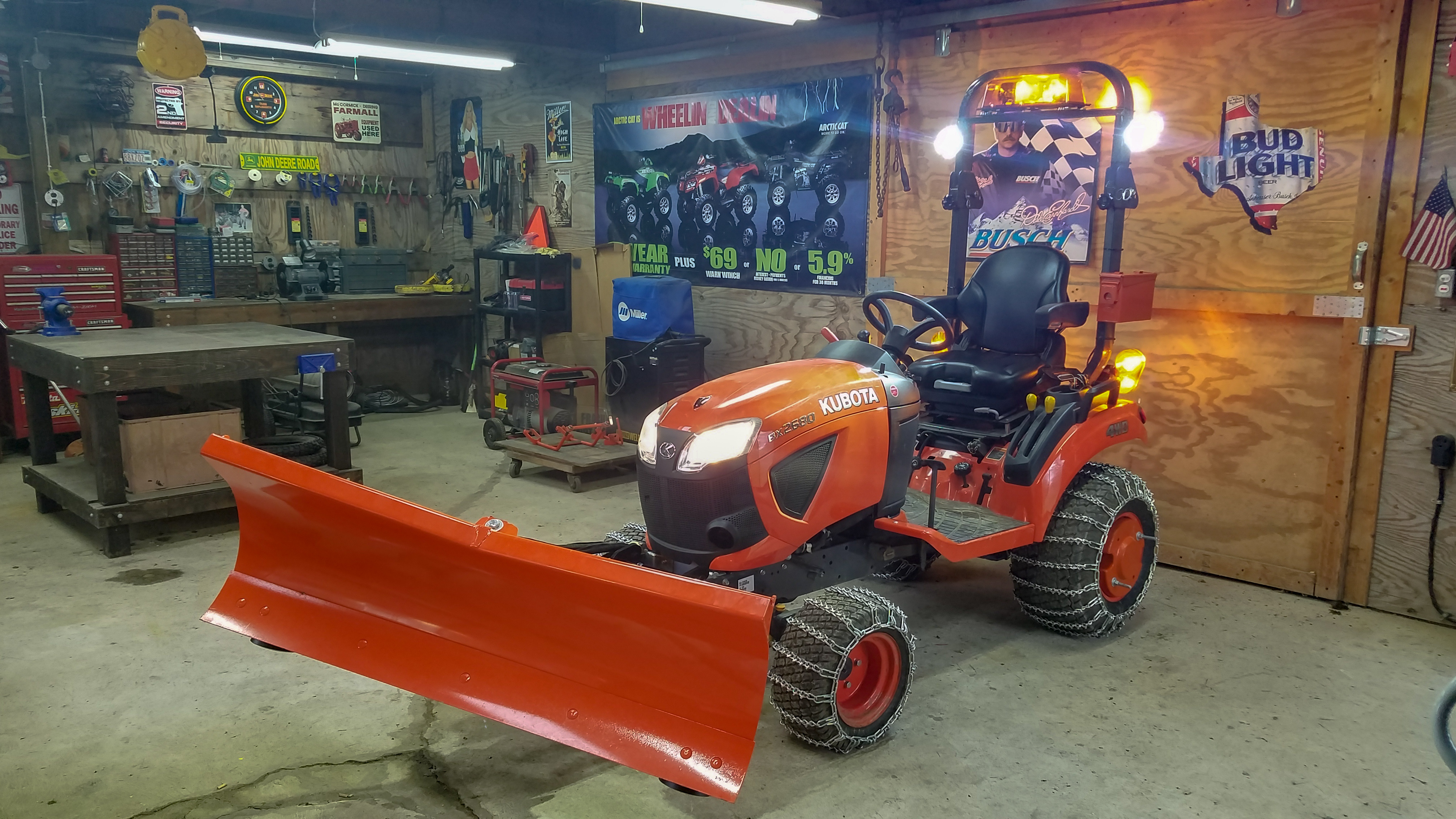

I just converted my BX2680 lawn mower to do battle with the elements this winter.
Can't wait to try out the new chains, weights, and plow.

Looks like you are ready!

Smart doing it now when the temp is nice to work in. I usually am doing it the night of the first storm when it is below freezing! How much snow do you get in a typical season? I know some places around Buffalo get crazy amounts!

Old man winter in for surprise when he comes knocking at your door. :thumbsup:

Can’t lose with them chains!

That is why you always point your best snow weapon towards the door before the big one hits.

First, that is way too clean a garage!!!!
Nice set up. Depending on your property layout, and type of surface, a plow may have problems with the kind of snow falls Buffalo can get. But it sure beats having nothing!
When we are going to get more than 10-12 inches, I go out and do a first pass when there is 5-6 inches on the ground. I am using a pickup with a plow...no chains. The problem with a plow is having a place to push the snow. I will typically have banks over 6 ft high and I leave enough real estate to pile it up in front of the older banks.
Again, nice set up.

Those chains made all the difference in the world. With a small tractor, you don't have enough weight to keep a straight path. The snow bank will push you. Front chains will allow you to steer.
