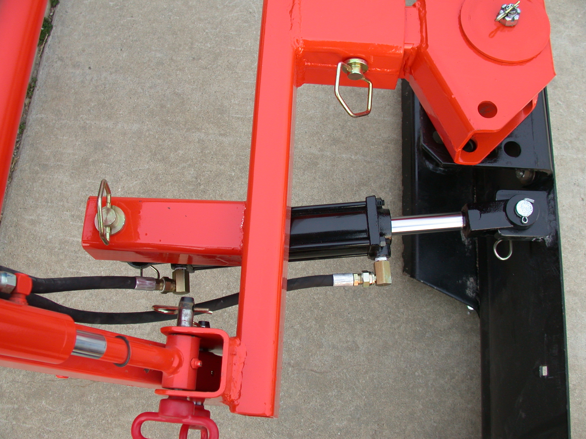

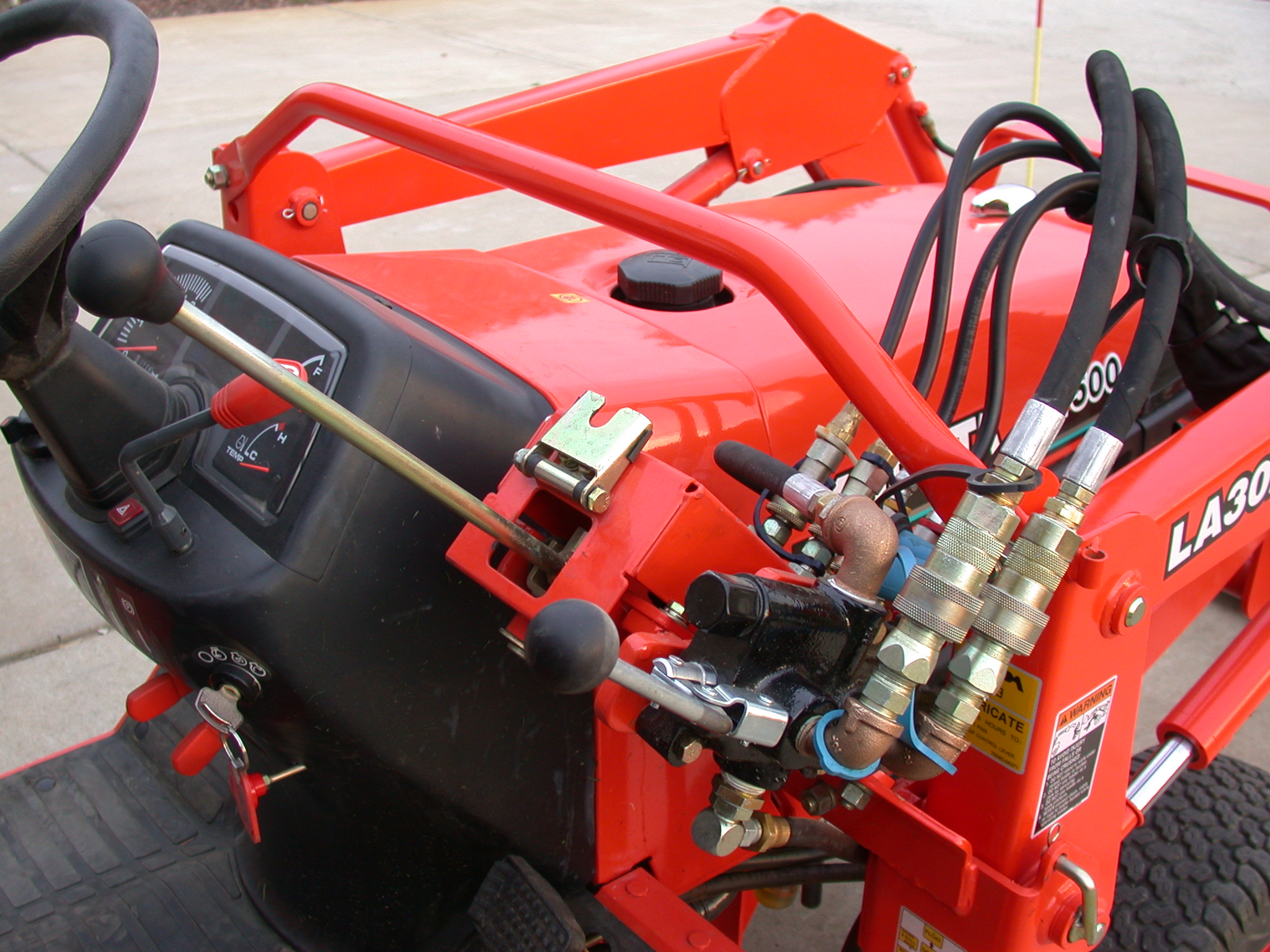

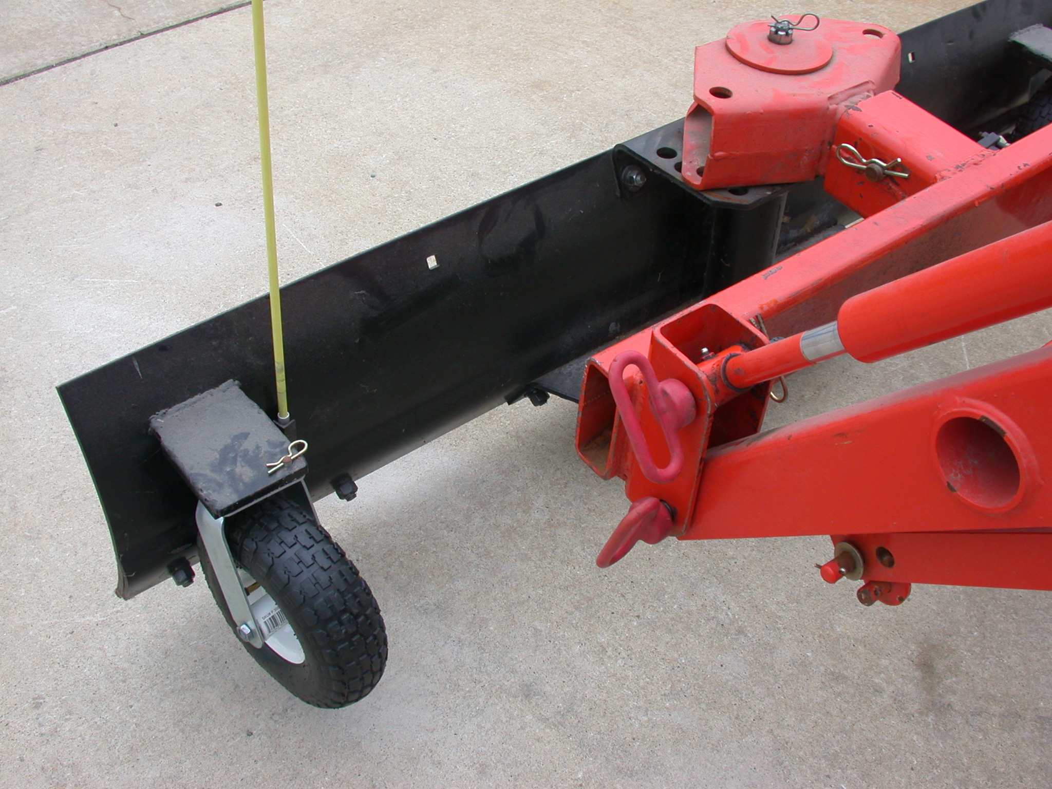

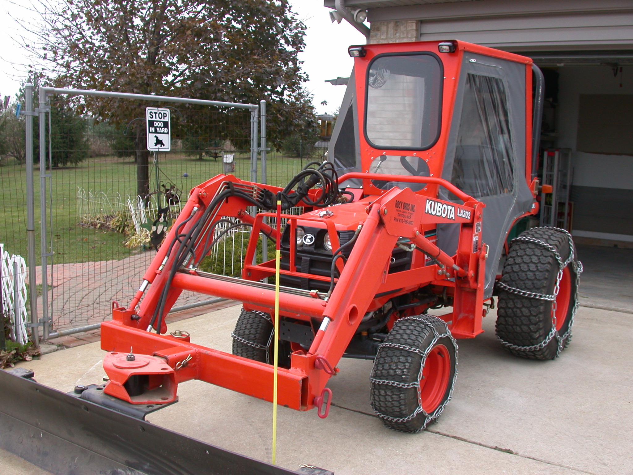

I have a B7500 with a 4 foot bucket. I wanted to put a plow on the front but did not have the depth in my garage to put the tractor in with a plow mounted on the FEL. My solution was to make a crossbar that connected to each FEL arm (the bucket was removed) and I welded a short rectangular piece of 1/4" stock in the middle. Then I cut the bar from the 3 point to the head of my LandPride 6 foot blade in half. That bar then fits in the "receiver" I welded on the crossbar. I also added a single cylinder for power angle. Even with the plow angled the force is still applied to both FEL arms. I have used this setup for 5 years now with no problems and with some relatively heavy snows here in southeast Michingan. I also welded a "receiver" on the rest of the 3 point bar so I can still use the blade as a back blade.

Here are some pics of my setup that you asked for. I've used this plow setup for 5 years now but only added the cab 2 years ago after getting a great deal on the front and top pieces. A bit of work which included making the soft sides and I've actually plowed in my pajamas.:D I was lucky when I bought my tractor that my dealer sold me a Land Pride back blade. Their blades are completely curved like a snow blade just not as tall. This allows the snow to "curl" over as I plow and none goes over the top of the blade. I have about a 30 foot cement apron in front of my 3 car garage which I scape all the way down. The rest of the driveway is gravel. I started out the first year with no power angle (had to get off the tractor to manually change, a real bummer :() and the mushroom shaped skid plates for the blade. I had 2 basic problems. I would scrape the cement portion with the blade straight but would get caught on a couple of the slabs that had a raised edge. Since this setup has no spring relief for the blade like a regular snow blade I had to go slow on the cement to not "shock" the loader arms if I hit a raised edge. BTW, when plowing snow the loader is always in the float position. Adding the power angle allowed me to angle the blade slightly on the cement and it doesn't get caught anymore. The second problem was the blade skid plates which worked OK when the gravel was frozen but dug in when it was thawed like in early winter and spring. I solved this problem by adding the swivel gauge wheels on each end of the blade. A piece of angle welded on the back of the blade allows for the insertion of one of those fiberglass driveway markers. This allows me to know the exact position of the blade edge relative to the ground since I scrape the cement and need the blade edge up slightly to plow the gravel part. The position of the gauge wheels allows me to have the blade edge up to an inch off the surface. This is handy for when I plow around the mailbox without worrying about damaging the grass, or whatever that groundcover there is. Madreferee helped me plumb in the added valve for the power angle.;) As I mentioned, I also use this blade on the 3 point for grading and I sized the length of the hoses to allow the power angle cylinder to work back there also. I hope the pictures help inspire and give some of you guys ideas as I have gotten from the wealth of knowledge and experience of members of this forum.
