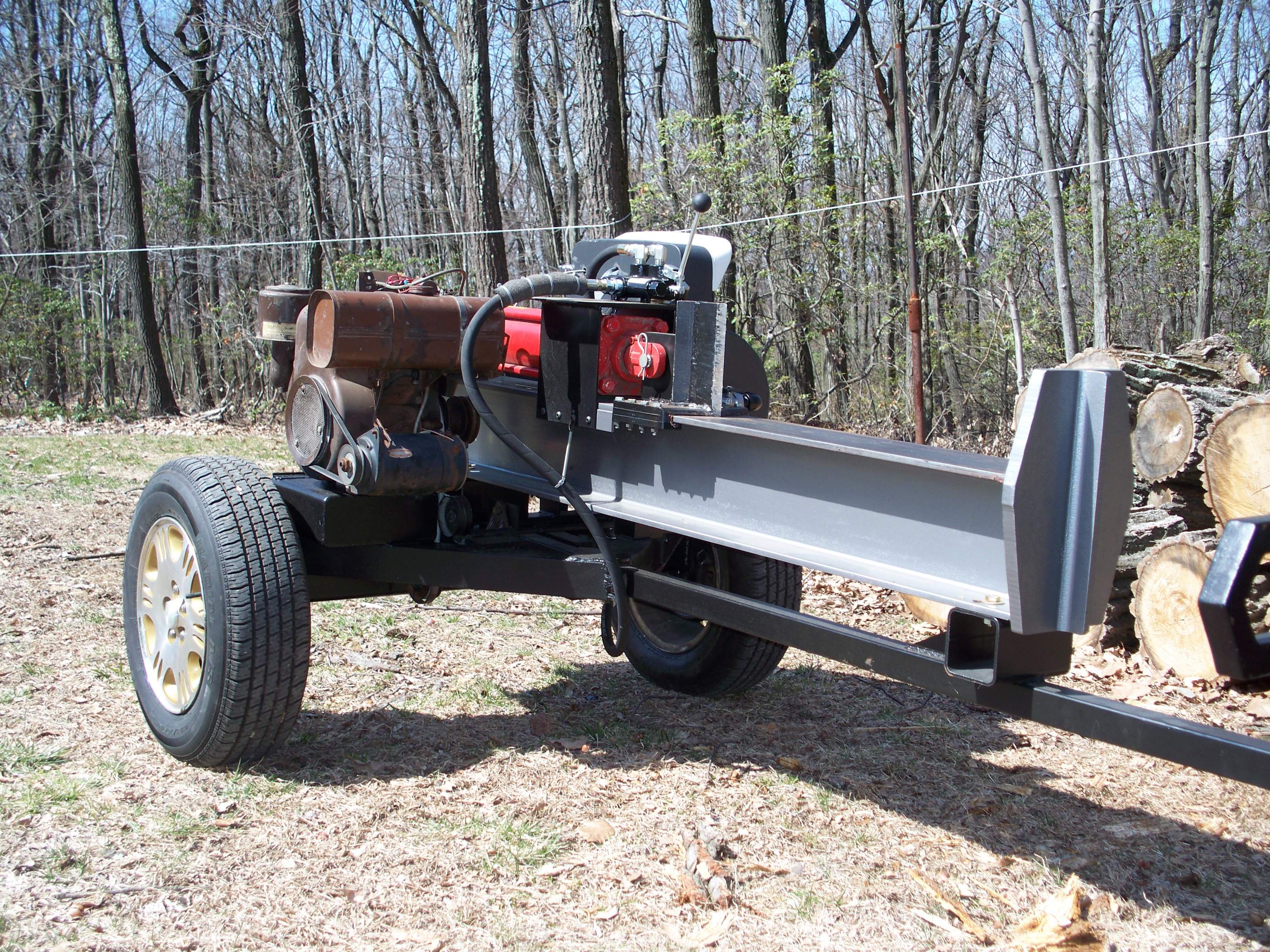

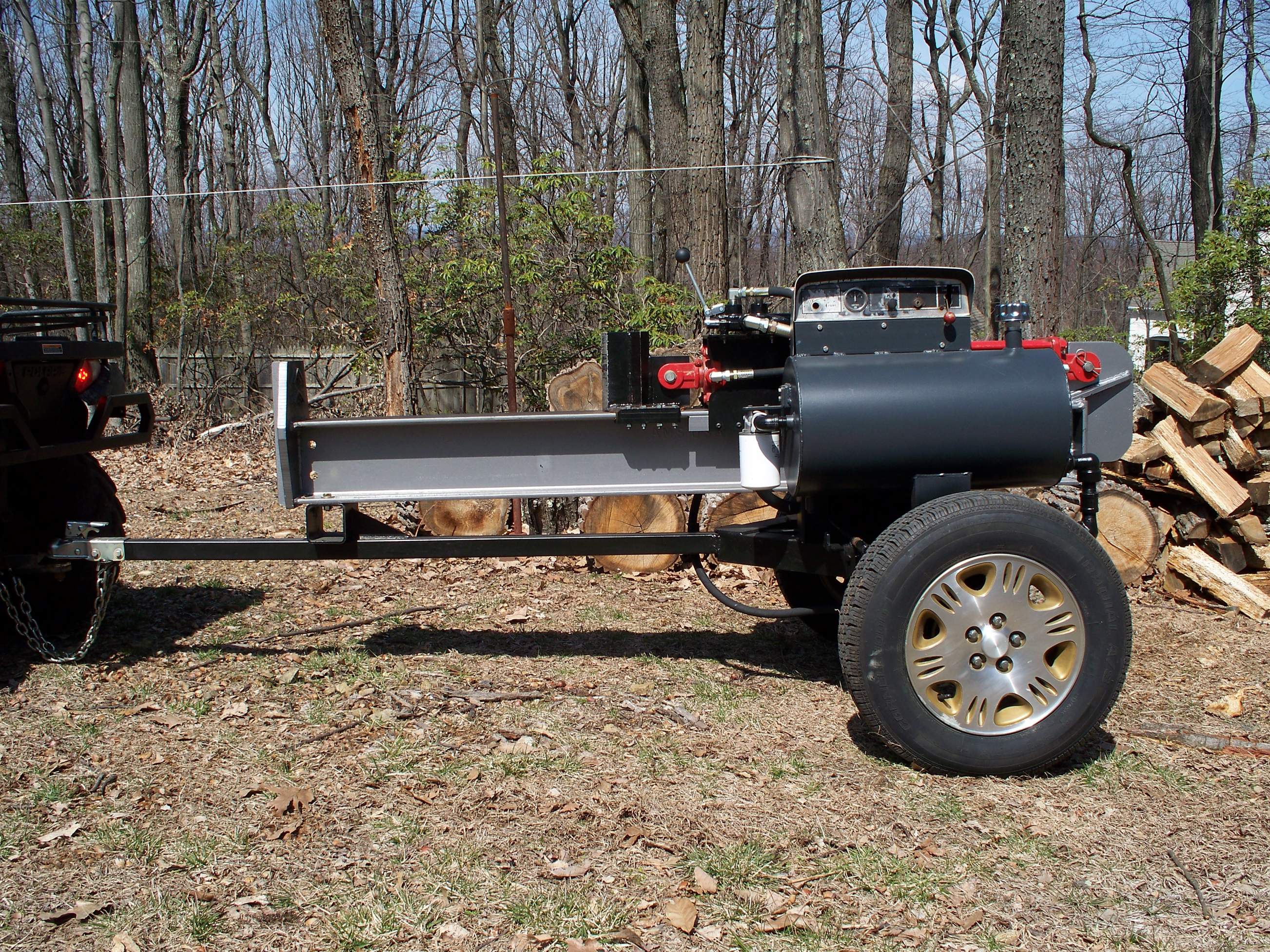

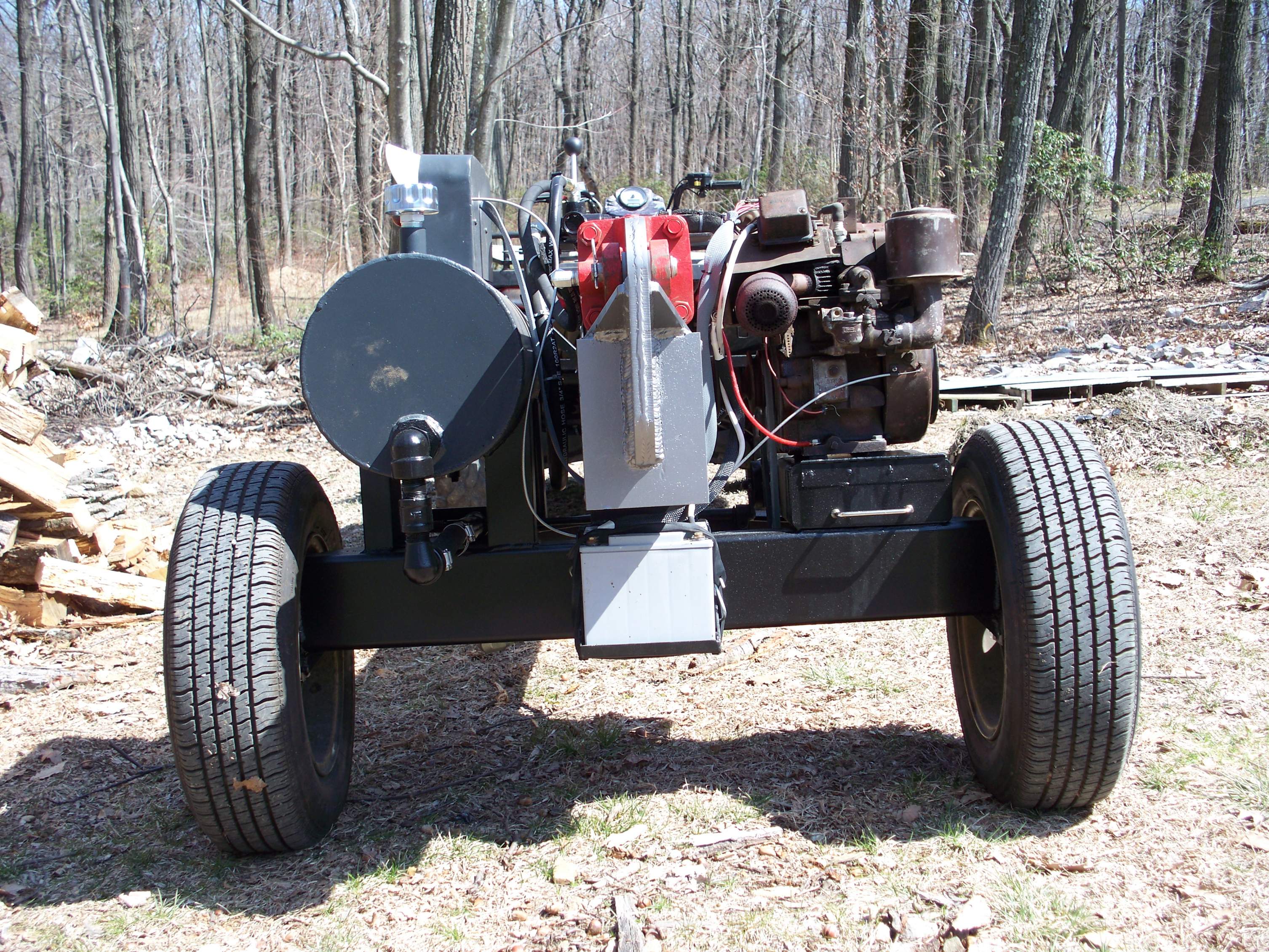

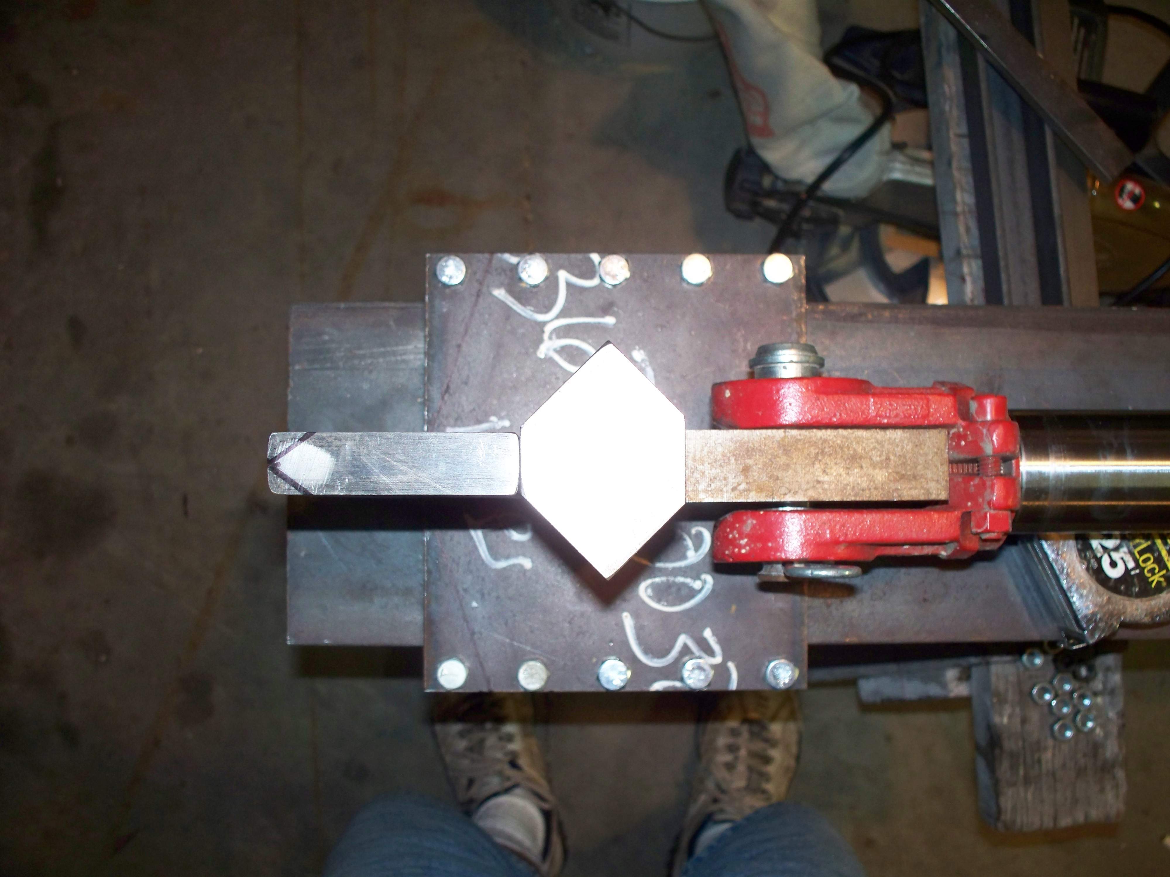

Moose, I agree if you go with a 4" dia. cylinder you will have no problem splitting your pine. I used a 4" x 24" cylinder with the factory set pressure relief on my energy valve at 2,500 psi. When I first built my splitter I had wings on my wedge thinking it would "pop" the wood apart faster & had a problem with an occasional piece of elm getting stuck. I cut the wings off, sharpened the wedge, and have had no further problems. To make the wedge, I cut a piece of 1/2" x 8" x 16" mild steel bar in half at a diagonal and flipped one piece over and had it follow behind the the cut edge & welded it together on to the beam. (I am a fan of the horizontal splitter where the wedge is stationary.) (I added a log lift to mine to handle the big ones. It was well worth the effort!) The angle of the wedge is about 20 degrees.
............./\ This diagram is rough but will give you the idea.
............/..\ (Please disregard the periods, I had to add them to
.........../\...\ keep the slashes from sliding to the left.) The top
........../..\...\ left edge is one of the cut edges.
