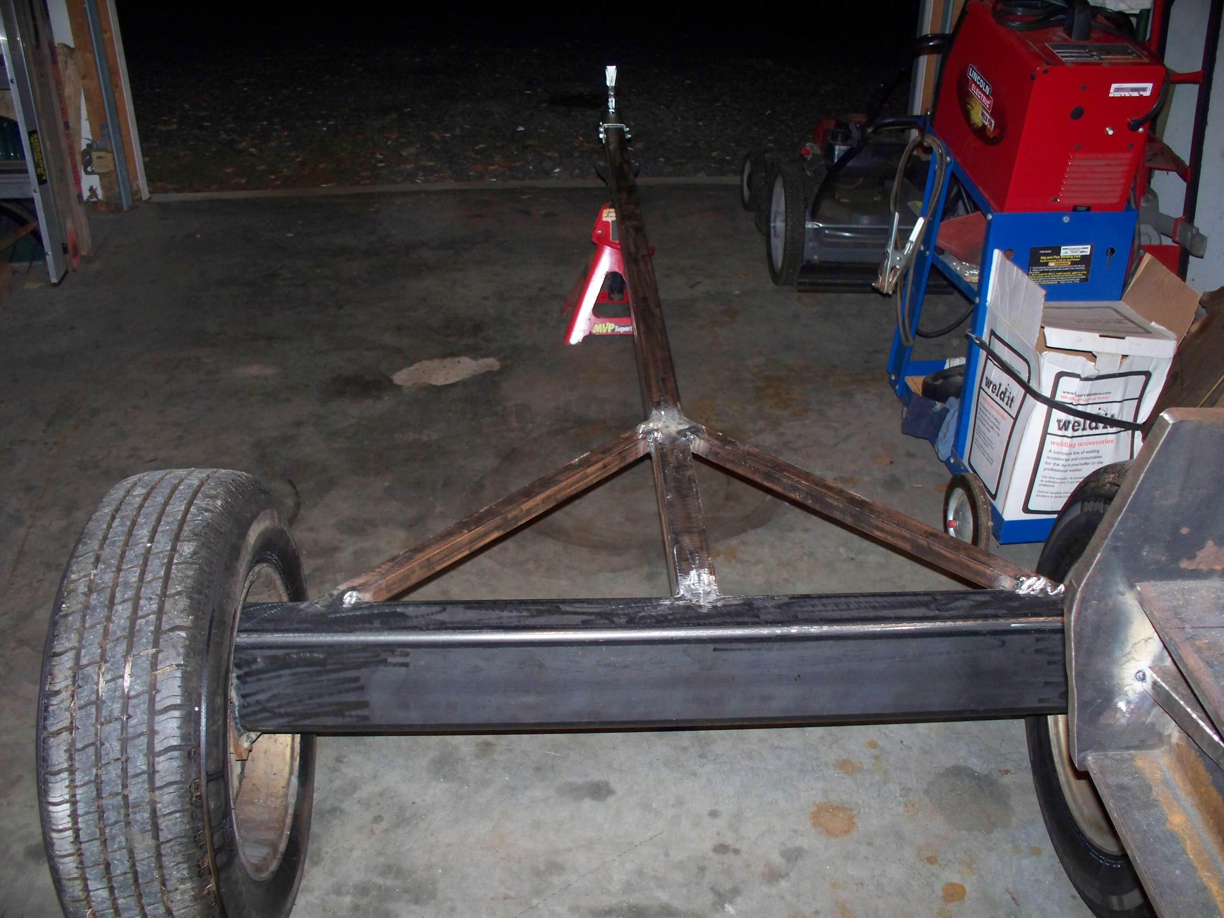

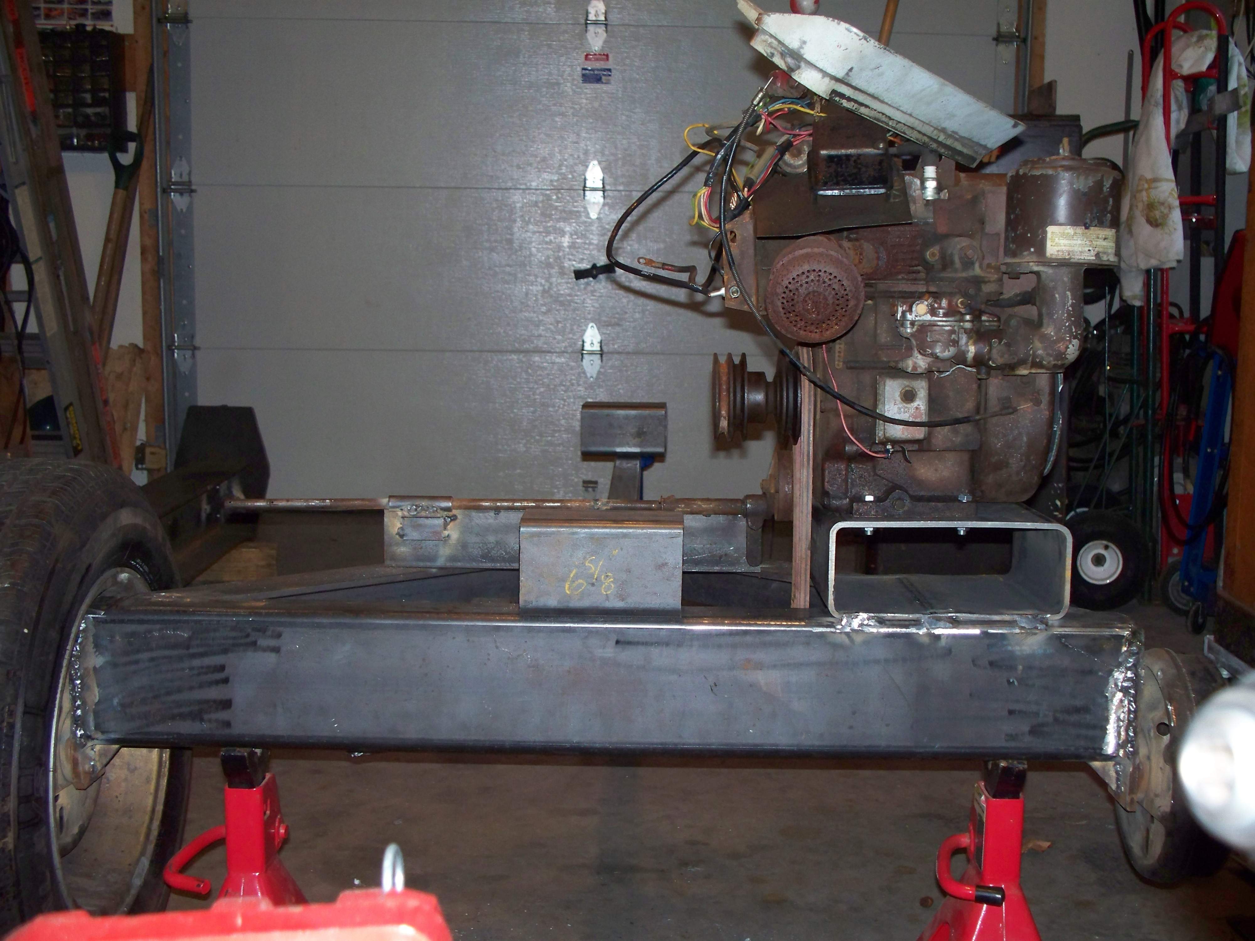

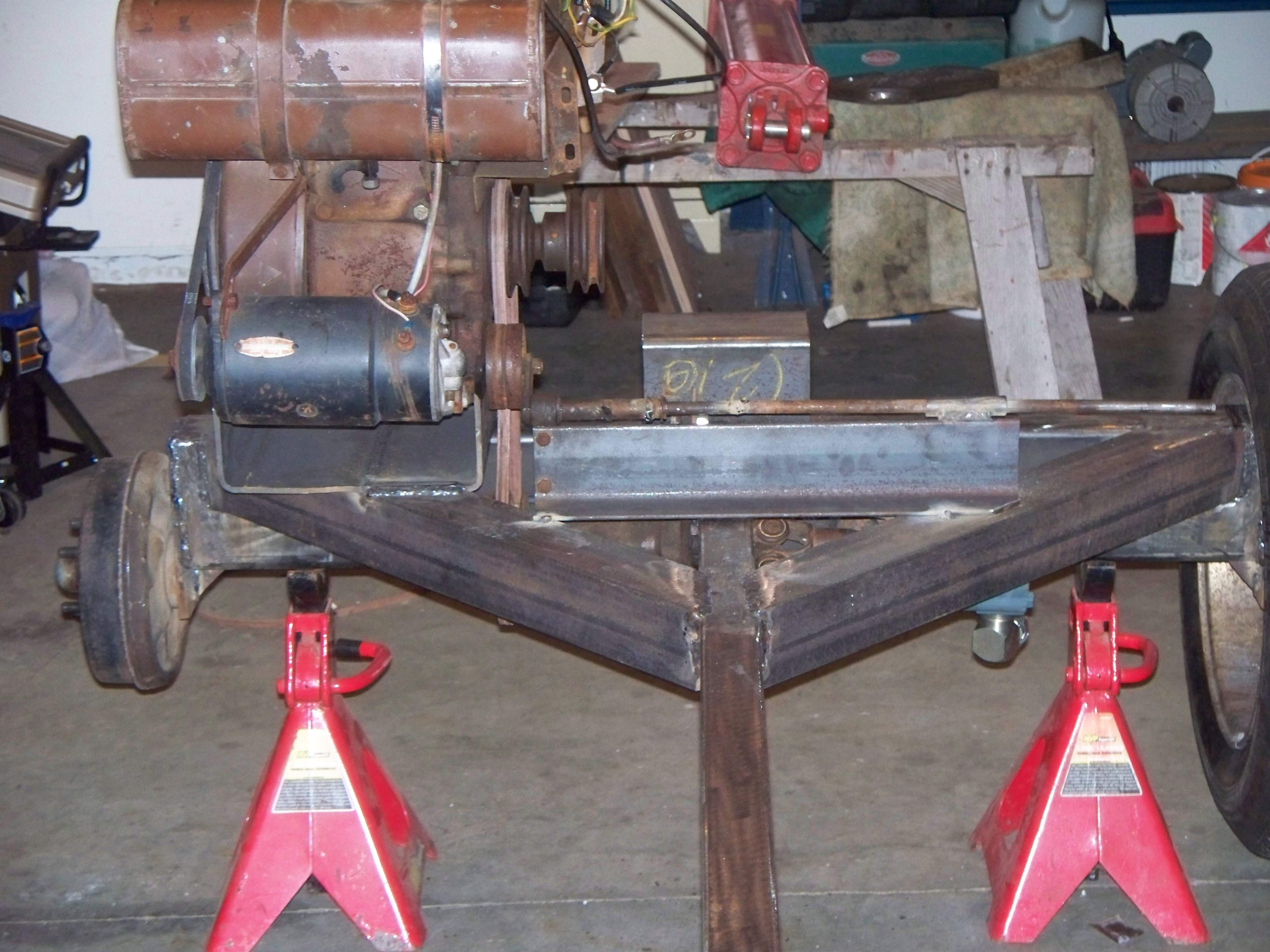

The spindles I used (were best of all FREE Wheels too) came off a '91 Plymouth Acclaim that was destined for the bone yard.
All I did was weld the rectangle plate on the spindle right to the ends of a 3" X 6" X 44" tube. I turned them upside down so they just cleared the inside top of the rims for the most ground clearance.
I used 3 X 3 angle for the gussets to the tounge tube, this created a larger area to stand while working between the lift and the oil tank.
See pics feel free to ask for more or use any of it.

Thanks for the pics Deer!
Very helpfull, and may use some of your ideas:thumbsup:
