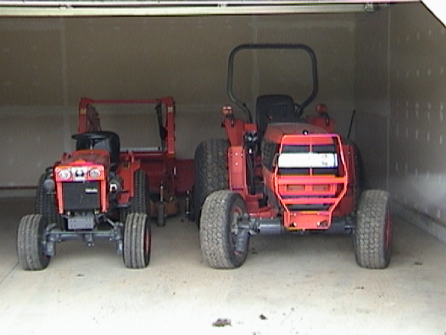

   / Ready to order #15
JohnMillerIII
Yes, the oversize turfs on the larger one, standard on the b7100.

   / Ready to order #17
JohnMillerIII
<font color=blue>Turf Tires=tractor finish mower 80% of it's time</font color=blue> I can accept that/w3tcompact/icons/wink.gif. I do a lot of mowing without tearing up the grass or leaving inprints. Sounds like a acceptable rule. However, I've REALLY pushed some extreme conditions the other 20% of the time including mud, clearing out woods, snow,(it used to snow in Michigan) etc. and I'm happy with them. FWIW, when I bought it, we'd had a large snow storm, dealer called and asked if he could use it to clear his lot and semi bays. Told him no problem, he advised on delivery that he was "suprised" how well they worked in deep snow. I don't want to turn this thread into an ag v. turf so I'll just leave it with...they do work! /w3tcompact/icons/smile.gif/w3tcompact/icons/wink.gif
regards
Mutt
