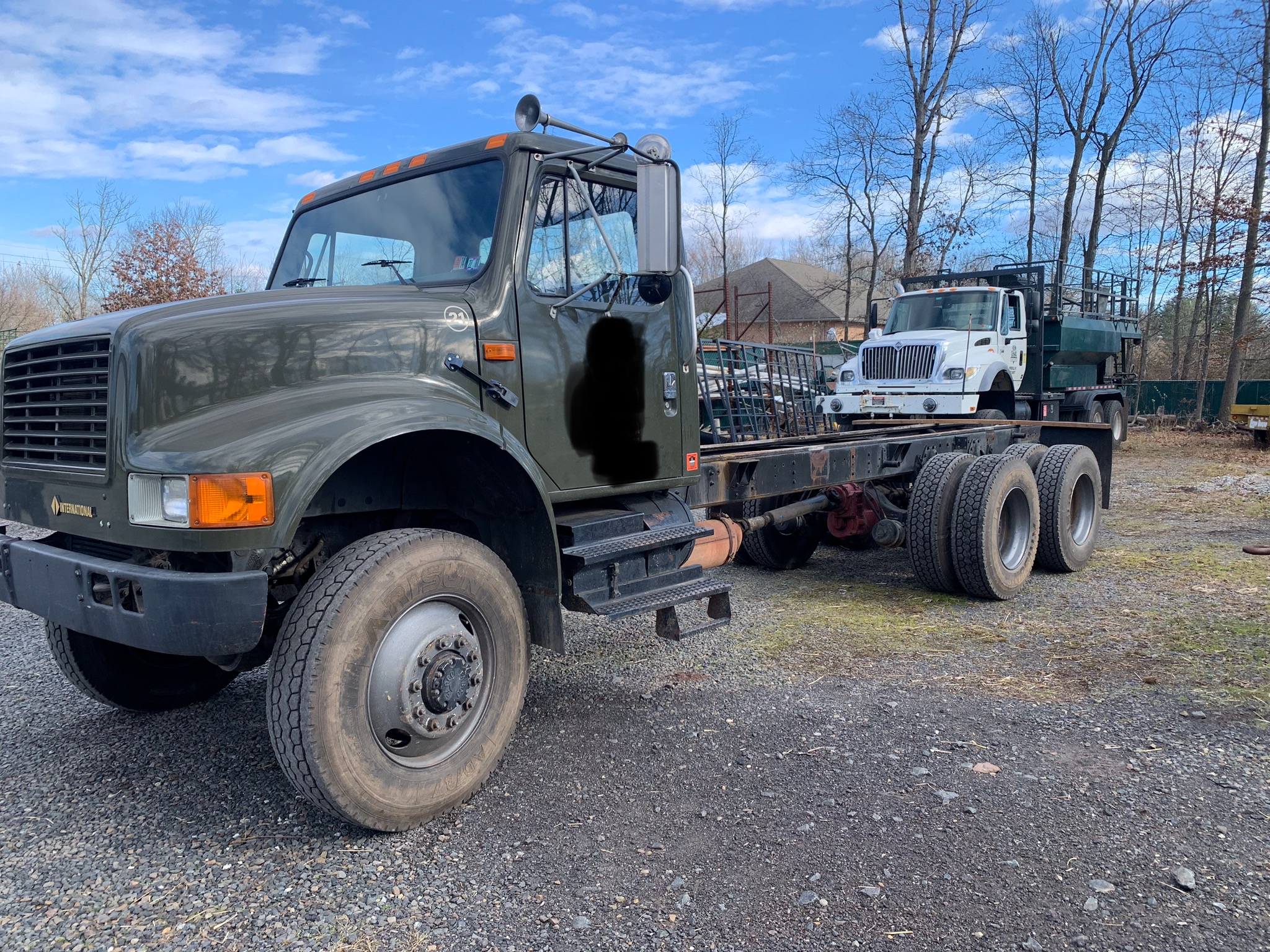

Best all around option for me is a 6x6 digger derrick, stripped down to a chassis.
Theyre out there, but $50,000 is what they want for one that’s not totally trashed.
Power companies don’t typically sell them direct, they sell them through brokers who mark them up 25-50%

I think you’d be happier with a tandem. I have no experience with a 4x4 single axel or a 6x6 tandem but a tandem with rear lockers will make a fool of a single axel going off road. If you had an equal load on both trucks my money goes on the 4x4 single axel getting stuck before the tandem without front wheel gets stuck. If both trucks were loaded to capacity my money still goes for the tandem. The single axel turns a lot sharper is about the only advantage but with a 16’ bed you’ve lost most of that advantage.
   / Real thoughts/experiences with military trucks
#40
I’m looking every other day. My guess is it’ll be a IH7400 6x6 chassis, probably 2005-2015.
Pre emissions would be great, but man they are low on power. 260HP is pretty typical on them.
My 4x4 single axle would get in/out of places a tandem would screw itself stuck sideways. I drove a couple Pete’s back in the 90’s, one a tandem and one a tri axle, and they were ok off road, but there’s nothing like a live front axle pulling you. It’s also better because many times the front axle is sitting in a good traction spot when the back axle(s) are not.
