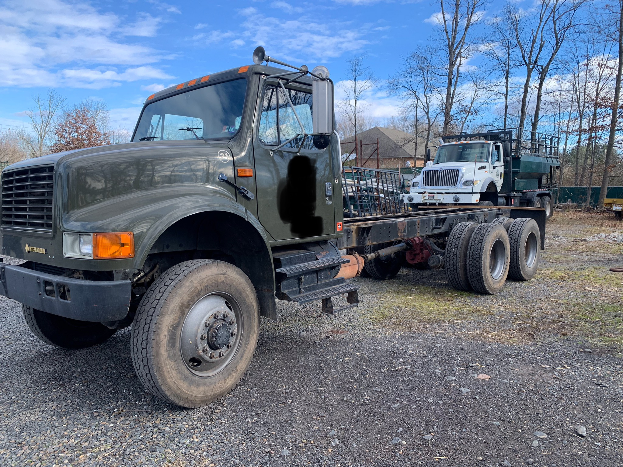

So I got a little more info on the 4900
Has DT466 @225HP…. man that’s low on power…..
Has recently rebuilt Allison MT643 trans
Has tandem axle interlock air shifted
Has locking differentials air shifted
Hi/Lo transfer case air shifted
Has air brakes and air run to the back for air brake trailer
Has aftermarket AC in need of some work
10 nice, matched tires
Current PA inspection
Its a “light duty” tandem. Only rated for 46,000lbs. He thinks it has a 12k front axle and only 34K rears (I’m used to 40k rears). Still enough to haul 10 tons of hay with room to spare.
The truck was formerly an Army mobile hospital. Current owner purchased as surplus with hospital box removed. He installed a hydroseeder on it for several years. Hydroseeder removed and put on newer, more Highway-friendly truck.
Says truck runs excellent and has no issues and no significant leaks
Might be nice with a 20’ flatbed and an air ride seat

Went to see & drive truck today. Other than 6x6, automatic and aftermarket AC, it’s very basic.
But everything works and it’s in good condition.
Rear axles have Detroit lockers
It was used by the Seabees on a Navy base in Florida, then brought up north 15 years ago. Not used in winter.

I’d like to see a comparison on the off roading ability of a locked tandem vs a 6x6 with the same tires and suspension on each. My prediction is not a lot of difference especially with road tires on the front.
   / Real thoughts/experiences with military trucks
#67
The one in the picture has tandem axle interlock and Detroit lockers, so same out back as a 6x4 with lockers.
Given an extra axle up front pulling, a 6x6 would be better. Especially if the front axle is on better ground than the rear axle.
If the traction wasn’t any better, why would they be mass produced? Why would the military and utility companies buy them?
   / Real thoughts/experiences with military trucks #68
Obviously it would be better but how many times would it make the difference of getting the job done or not?
   / Real thoughts/experiences with military trucks #69
Having all of the weight on driving wheels improves traction.
For me? Almost everytime it’s used
We move a lot of hay in late summer and fall, when the ground is soft.
These single and tandem axle trucks are heavy and have stiff tires and suspensions, so they inherently get poor traction. A live front axle helps.
