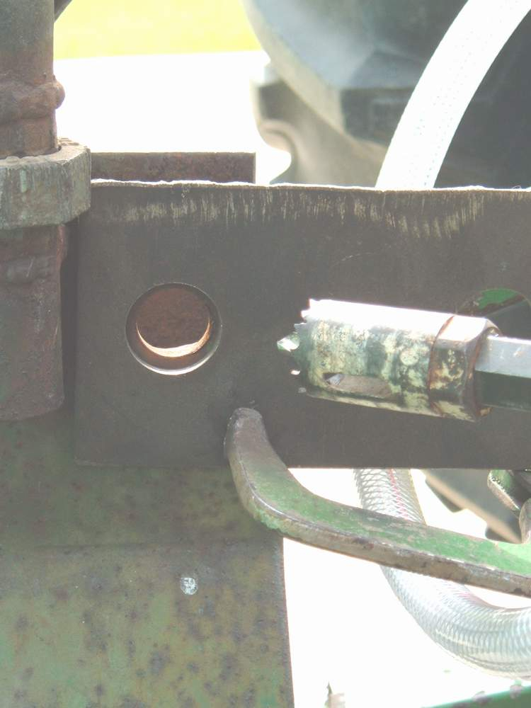

Sberry's picture in post # 31 shows one way that I have used. Clamp the right size hole over the too small hole:
I have used the hole guide plates with hole saws without a pilot drill many times to bore holes in truck, implements ant tractor frames. Great for re-centering a worn hole with a bigger fastener. Sometimes so obstructive used impact wrench with extensions and universal joint to drive the holesaw.
MK Morris bimetal hole saws come in 9/16” and 5/8” for smaller fasteners. Use oil and air to clear chips and cool on thick metal.
Plasma cutter with templates cuts accurate holes. Trying to drill a plasma cut hole is hard on bits. Big drills cost big money. Best use a die grinder with carbide.
If I can get it to stick, a mag drill is wonderful. Milwaukee with adjusting base, variable forward and reverse. Love to drill and tap threads with it. Mine has 3/4” drill chuck so haven’t tried the rotobroaches yet.
