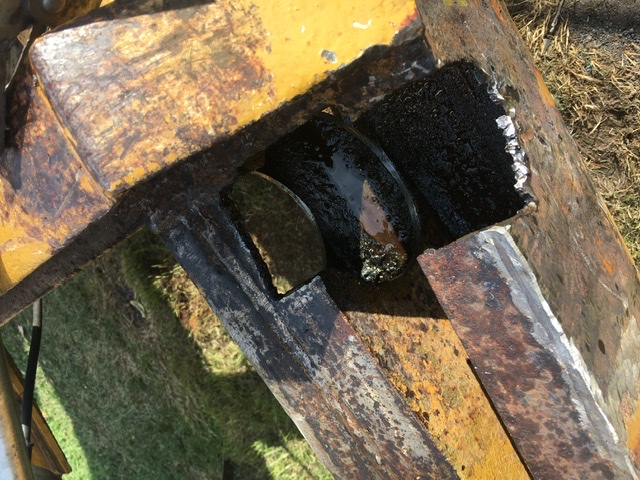

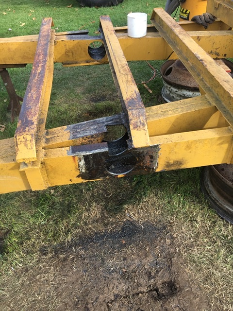

Here’s a “Hole Saw” job I helped my buddy with. He cut out an old solid axle out of this clam trailer and wanted to replace it with a 5” round semi trailer rear axle.
To get the holes aligned, we roughly torch cut them out, but not bigger than 5”. Then we stretched a string thru the 6 layers, but first installed 6 pieces of 1\8 by 1 flat, 6-7” long, predrilled with the pilot drill, onto the string. We moved the flats around until they were perfectly centered on the string, then tacked each of them on lightly with a welder. This provided a hole for the pilot on our 5” hole saw.
The trick is slow drill and generous application of heavy thread cutting oil, along with a long cheater pipe on the drill.
Worked like a charm, very little adjusting with a die grinder and carbide burr.
