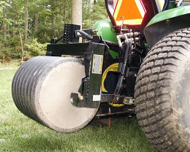

Here's a pic of a similar setup except using concrete disks instead of barbell weights:
Is that really separate disks? It looks more like a length of corrugated culvert tubing filled with concrete (which could be excellent).
/ Rear Ballast for Loader Work #23
Since I didn't take the pic, I'm not sure.
I suppose a piece of corrugated pipe could be used as a concrete form. It would have to be split beforehand or cut off somehow afterward but why bother? Unless you want to reuse it, just leave it in place.
Here's a youtube on how to make them:
/ Rear Ballast for Loader Work #24
I agree it is a corrugated plastic culvert pipe. I think a piece that small might even be free if you go ask as it would probably be an off-cut or could come off a larger damaged/crushed piece. Definitely wouldnt be paying full price on those things to use it as a form..
