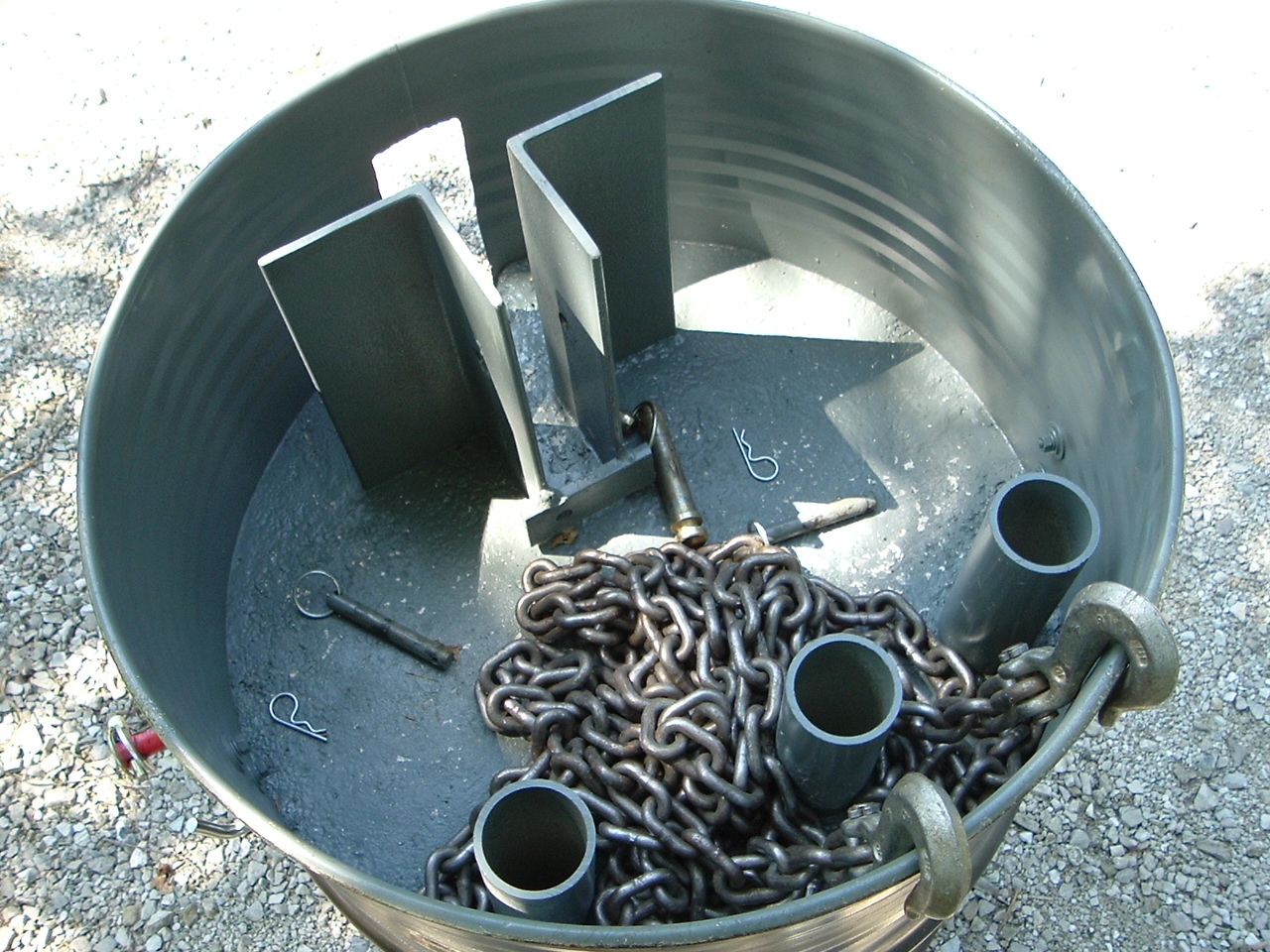

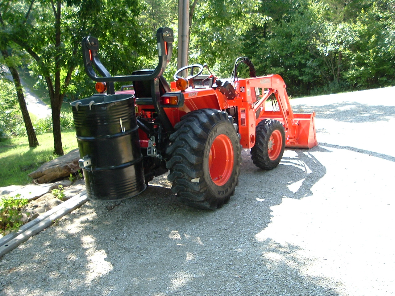

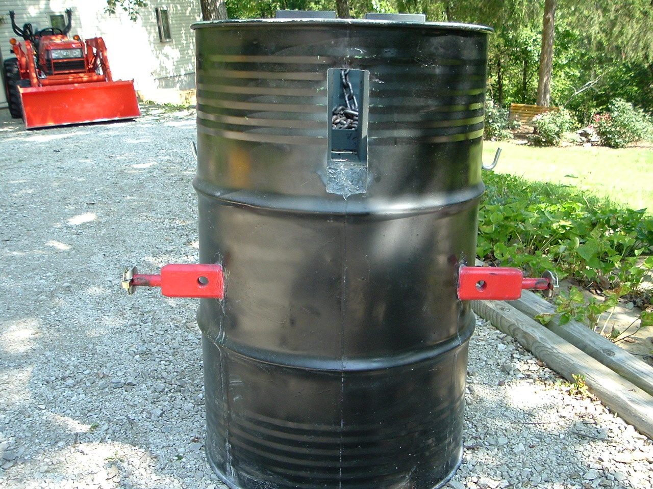

I made the barrell weight, from a $9 55 gallon barrell, with a $26 drawbar, from Tractor Supply. then took a piece of 5/8 allthread bolted thru the drawbar and welded to the rear reciever hitch. then welded rebar on angle to the drawbar and also to the reciever hitch to strengthen it on an angle. the bolted 4 inch angle iron to the drawbar up to the top for a place for the top link to go thru. (between the 2 angle iron pieces). I did not need 4 inch, but it was in the junk pile, and it was what I had handy. I put a layer of 2 inch rock in the bottom. to hopefully make some air space for water to collect if any came down from the 3 2 inch PVC tubes I installed vertically. for shovel/broom/rake handles. then bolted on some hooks for hanging buckets on the outside. filled the whole thing up to about 8 inches below the top with concrete for room to carry other items. The top link goes thru a slot, which is also a drain area for the top 8 inches if left out in the rain. I will try to get the camera out and take pix later.
James
K0UA

Famah, here are the pix you requested.
James
K0UA

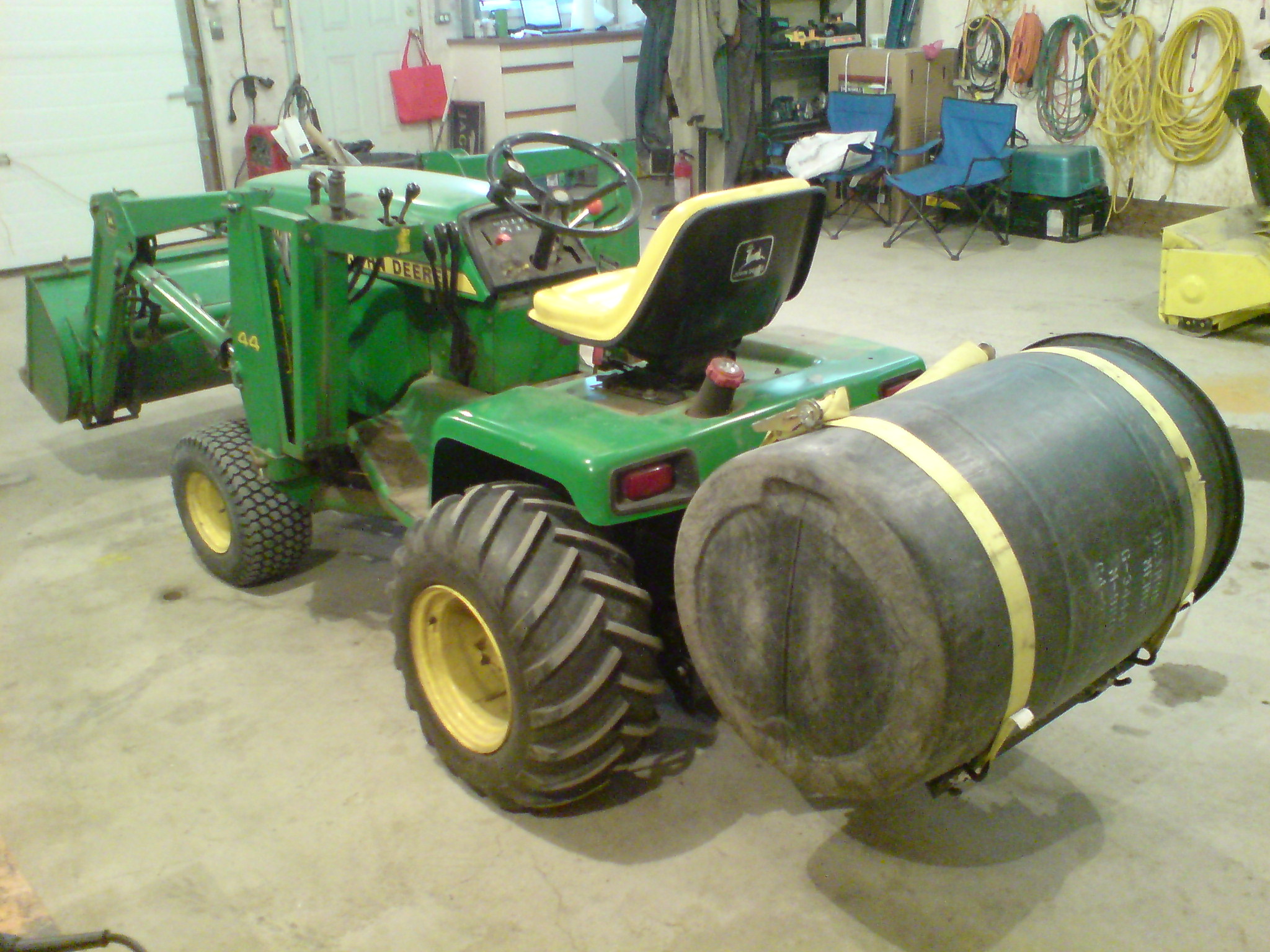

This is mine, It is over 800 lbs. It sits in nice and close and has no top link.
   / Rear Ballast Gentlemen, Rear Ballast #30
Interesting, looks like it adds a good amount of weight. Does it swing around an bang the tractor? That would be my concern seeing it doesn't have a top link.
